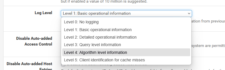

        You can also go wild with the Resolver log details : Pick any : the higher the better :
        and you'll see your DNS request coming in, and handled.
        Warning : don't forget to set this back to a normal level like "Level 1" as high levels will produce huge quantities of log lines.
