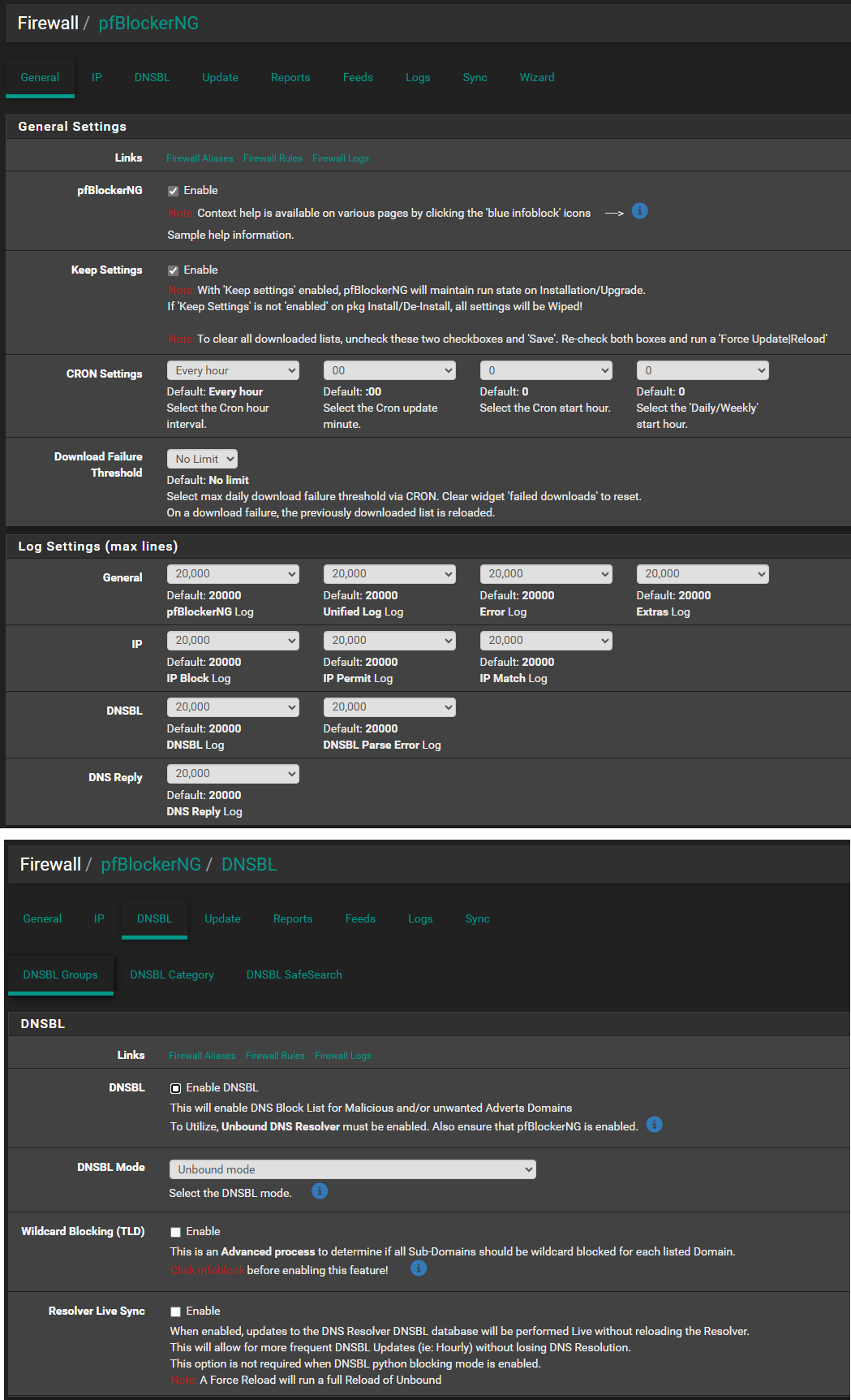

          What I am stuggling with now is that along the way I was root causing acme HTTP-01 Cert setup with letsencrypt, and the current "fix" is to disable my enhanced firewalling "pfBlockerNG"
          but this is not sustainable. And I need to figure out means to ??? Whitelist" any letsencypt server, world wide. Then I assume I will have to return back to this URL redirect issue.
