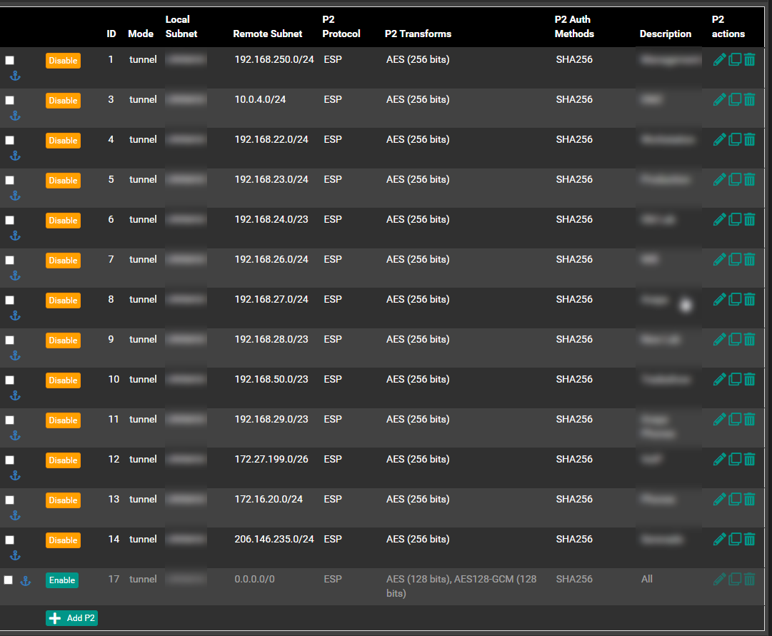

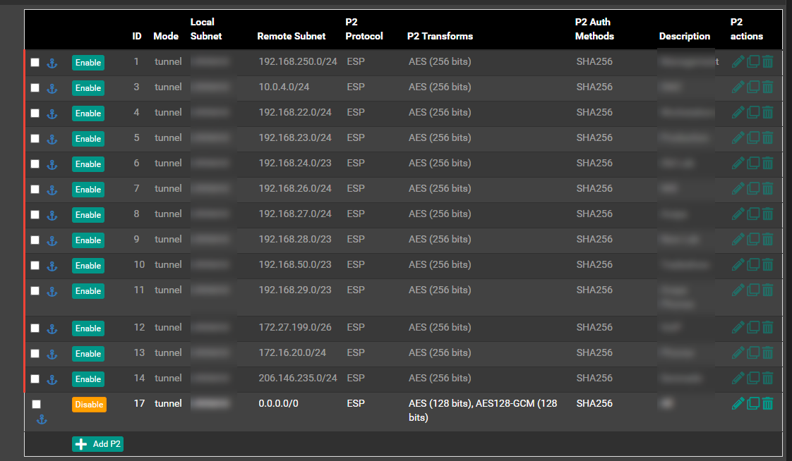

Are the SPDs shown up on both sites?The problem is, Meraki gives you very little control over IPSec VPN tunnels, especially when it isn't for one of their security appliances. And the minute I add a P2 entry in my pfSense box for a remote network of 0.0.0.0/0, all network traffic but local dies.
This gives me only local access to the data center
This gives me local access to the data center and Internet access, but through my external IP at home. Probably something on the Meraki side, but good luck figuring out what that is. I cannot add a static route to a VPN participant in the Meraki control panel. -
