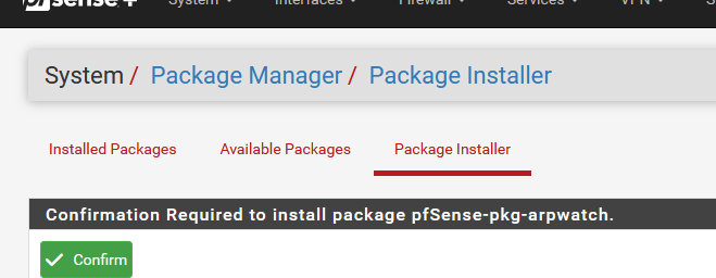

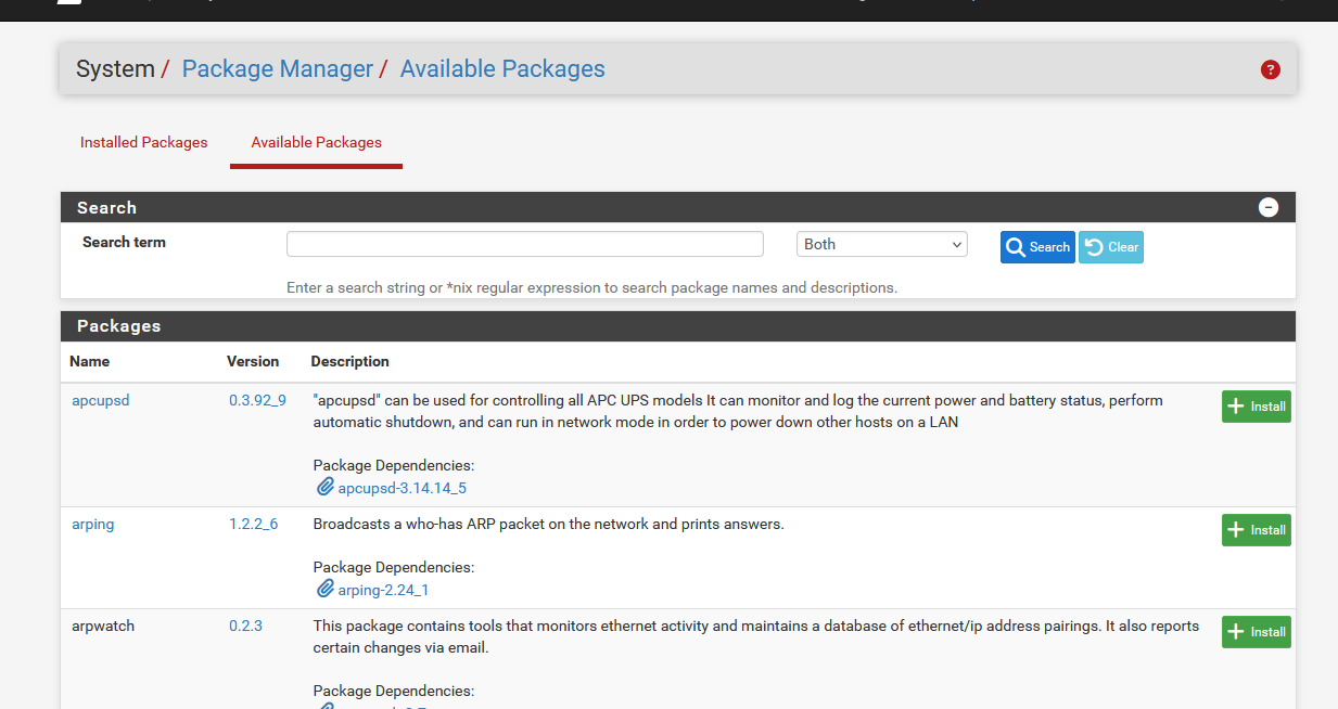

        Example :
        I see :
        ad when I click on the green +Install for "arpwatch" I see :
        and hitting the Confirm button will install the package.

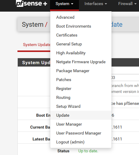

                So when you go here System> Update
                You should see this :
                (minor detail : I'm not using 2.7.2 but pfSense Plus Beta5 and 6 is coming up )
                but you see this :
