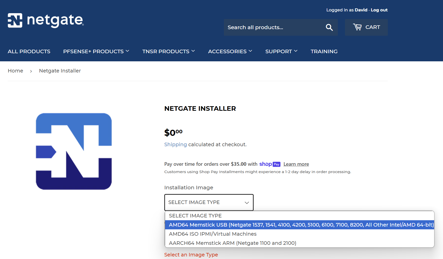

                I used the Netgate store to download this image. The image @stephenw10 linked to as memstick-serial legacy isn't immediately apparent to me in the list of images available on the store.
                  jupiters_spot
                  The download provides a file (netgate-installer-amd64.img.gz) that results in netgate-installer-v1.0-RC-amd64-20240919-1435.img
