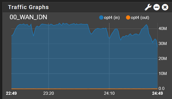

Site B has a 900Mb / 600Mb fibre connectionIf I do large file transfers over FTP but without IPsec (just using FTPS over SSL with port forwarding on the pfSense to the FTP server), I get consistent, fast speeds:

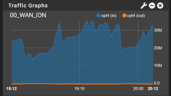

However, the minute I try to route over the IPsec tunnel, I get slower and very variable performance:
.I've played around with adjusting the MSS on both sides. Testing with iperf3 gives some interesting results. Using the command
iperf3 -c 192.168.21.100 -P 50 -t 30
With MSS enabled, but left at default at 1400, I get pretty mediocre performance given the line speed:[SUM] 0.00-30.00 sec 513 MBytes 144 Mbits/sec 3914 sender [SUM] 0.00-30.00 sec 451 MBytes 126 Mbits/sec receiverIf I lower the MSS to 1320, I get far better results:
[SUM] 0.00-30.00 sec 2.97 GBytes 850 Mbits/sec 2443 sender [SUM] 0.00-30.00 sec 2.91 GBytes 832 Mbits/sec receiverBoth appliances have VLAN tagged traffic on the WAN side so I think 1320 is probably about as high as I can safely go.
However, having said all that, the variyng performance on the FTP transfers above is obtained with the lower 1320 MSS value giving better iperf3 results. So I'm not sure if it's an MSS thing or not.
Where would be the next place to look?
@tfboy Sniff the actual packets to see if anything jumps out.
Also, not necessarily related, but are those iperf tests Protectli to Protectli— or Site A/B host to Site B/A host? It's a much fairer throughput baseline as the latter (i.e., Site A/B host to Site B/A host).
@tinfoilmatt thanks. The iperf3 tests are done on hosts, not on the firewalls directly.
Interestingly, I've since also set up a WireGuard VPN and that seems to work a little better than IPsec, but still 20-30% slower with large file transfers over FTP than going over the WAN.Following the guide on Netgate's website for WireGuard, I noticed that they clamp down the packet size by adjusting the MTU rather than the MSS, I don't know if there's a reason for doing it like that.
But as I'm seeing the WireGuard performance still a bit off, maybe it's not just an IPsec thing? I did wonder if the CPU was the bottleneck, but they never go above 20% or so usage so I doubt it's the processor that's the bottleneck.
