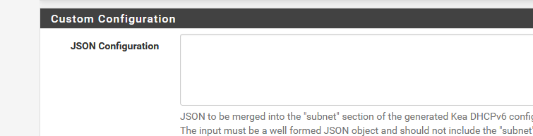

As 25.03 Beta now proposes :
Get yourself a small guided tour in here : /usr/local/etc/kea/kea-dhcp6.conf
and see how the reservation section is made.
With this knowledge, create your own 'JSON' structure that doubles a lease reservation and past it in the what I've shown above.
What you entered will be 'lint' tested, and beware : kea (json) is picky. Syntax errors are forbidden.When saved (and pfSense did't explode ^^) go to the DHCP serbver logs and see if kea complained.
If it does, and knowing that kea is "RFC" compliant (right ?), the issue is solved : It's not possible to make double leases as its not allowed.
If it does accept : make a feature request ?! -
