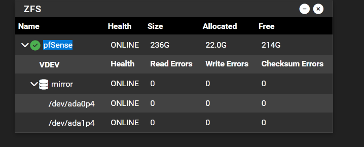

        ZFS widget?

                  Little by little I'm learning. The "ZFS" Widget doesn't exist for CE which sucks but I understand. I do have the SMART and Disk widgets enabled. I did realize that I can run zpool status from the command line. So at least I can manually check the RAID status whenever I'd like.

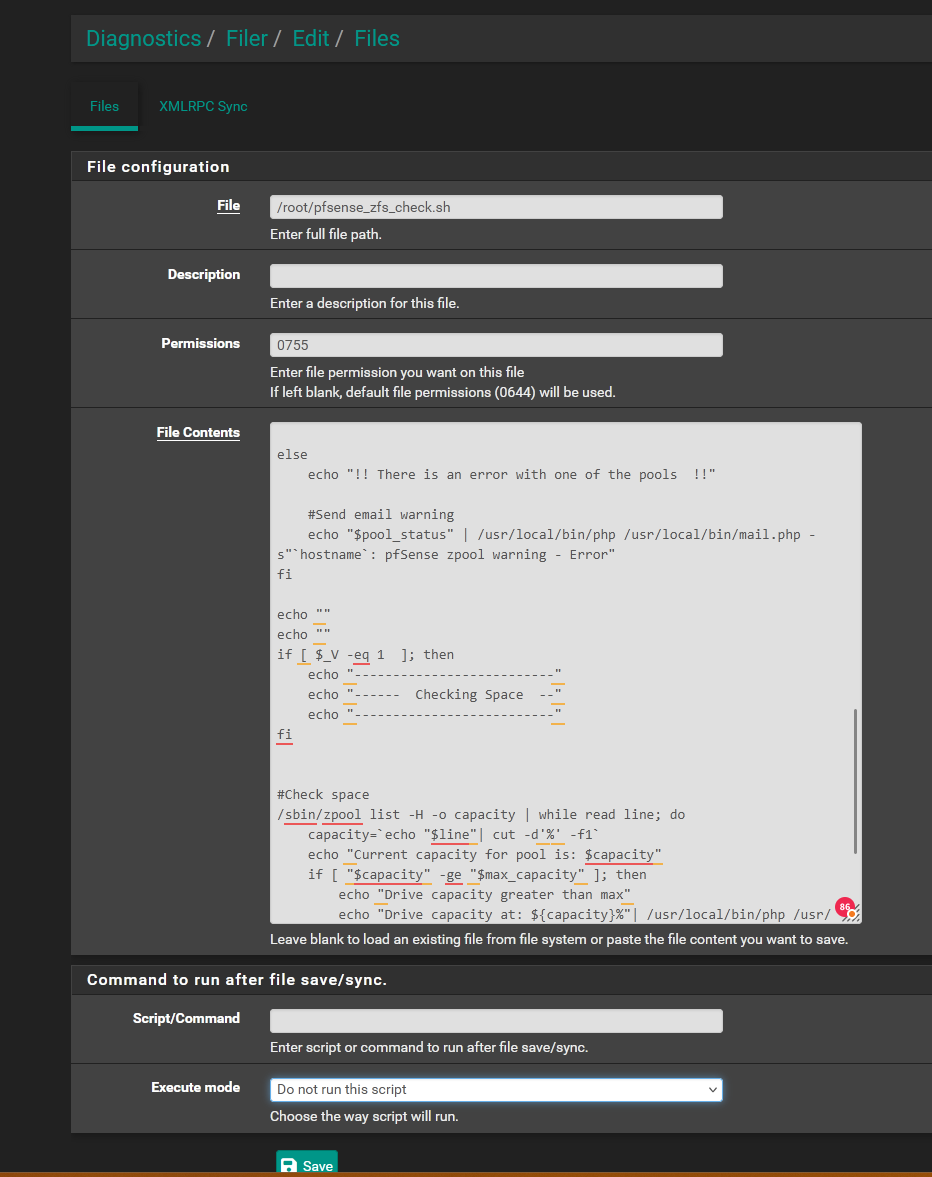

                    • w0wW Offline
                      w0w @mgc6288
                      @mgc6288
                      You can use Filer package to add the file permanently to the system, it will survive any upgrade

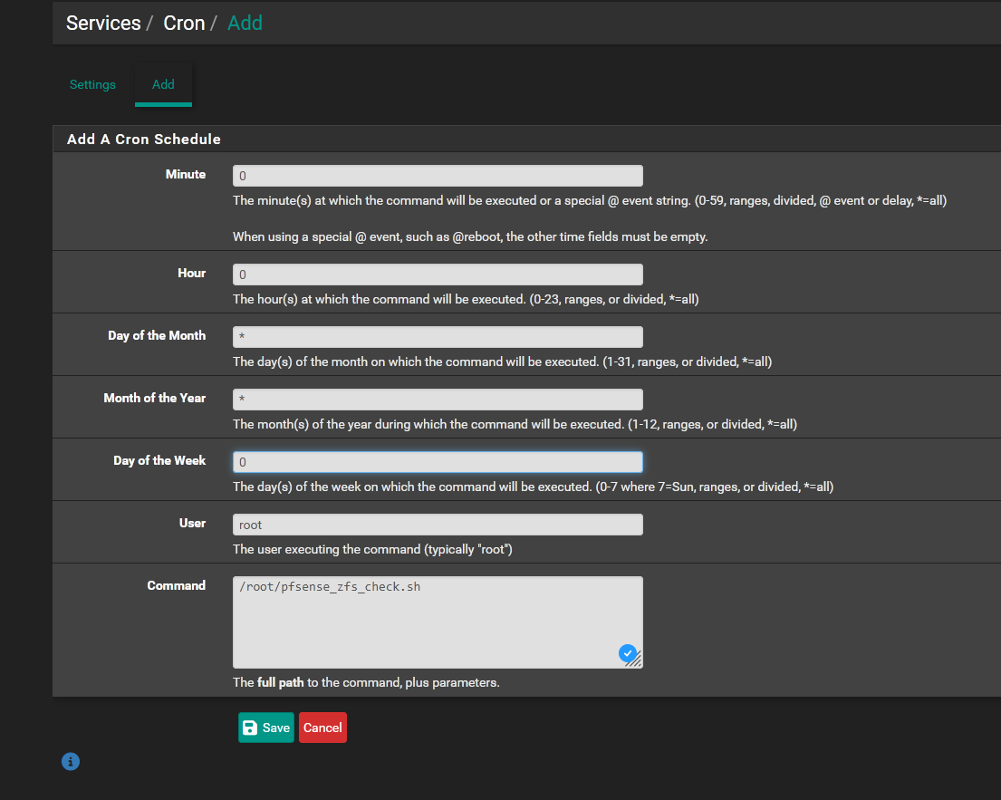

                      Put the file content there, fill the fields like this
                      then install CRON package and add the job there.
                      Hope this works for you
                        mgc6288 @w0w
                        @w0w Thank you! I finally got around to getting this installed. I presume this will send me an email midnight on Sundays if there is an issue....
                        • stephenw10S Online
                          It would for that Cron job but you could run it more often or on a different day etc.
