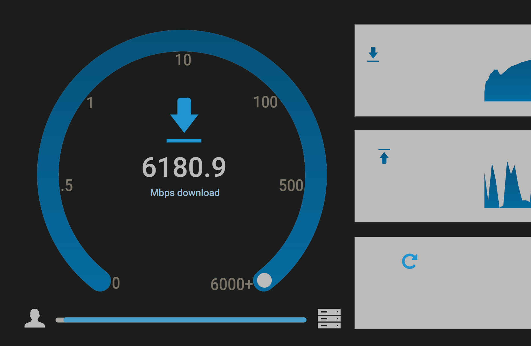

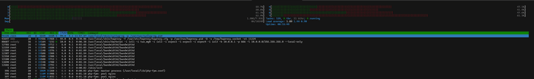

                  rpm5099
                  After switching back to CE and re-enabling some of the nic offloads I'm now getting >6G through the haproxy ssl connection up from about 1.5G, which validates the reason I was attempting to remove the Proxmox virtual bridges. It's unfortunate that Netgate has a licensing policy that is completely unacceptable.
