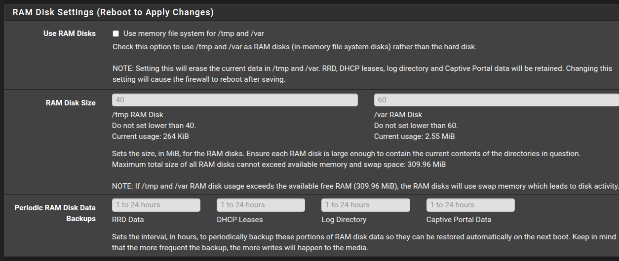

                        Looking at the RAM disk setup page, it appears it's not using much storage currently (if I'm reading it correctly, looking at 'Current usage' numbers) so the minimums should be fine?
                          You will probably need more than 60MB for /var. I usually set it to 120MB to start. If you try that I would monitor it for a few days to be sure it's not filing that when pfBlocker updates.

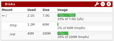

                              You can see it on the disks widget on the dashboard:

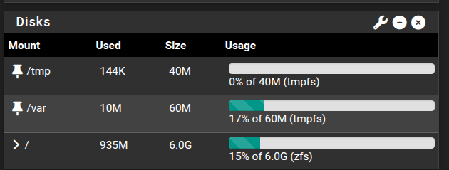

                                @stephenw10 Ok, well I enabled the RAM disks.
                                Interestingly, the Dashboard shows that only 60MB are being used for /var:
                                Update: I watched it during a pfBlocker update which just ran at Noon. It had been sitting at 17%, jumped up to a high of 73%, and seems to be staying there.
                                  That's running 24.11?
                                  There was an issue setting the RAM disk size at one point. But if it's only using 73% at update that's good.

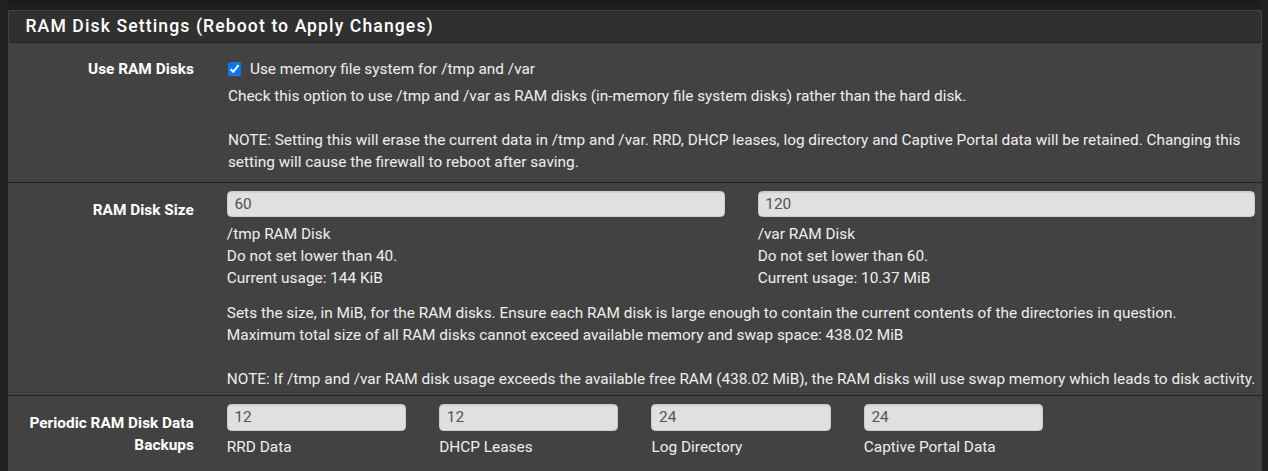

                                    @stephenw10 Yes, 24.11. I'll keep an eye on it but it seems to be stable at 73% (after going through 3 hourly updates).
                                    FWIW, I tried modifying the RAM disk size again for /var and restarting the device but with it set for 120MB it only creates a 60MB disk. Is there some flaw in the GUI interface or something else that limits it?

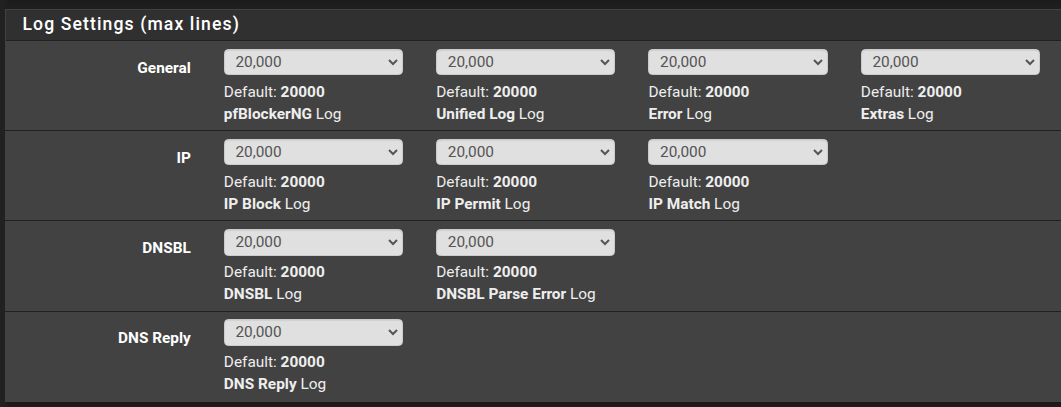

                                    Would it be beneficial to cut back on some of the log settings for pfBlocker?
                                    Like cut some of them down to 10,000 entries instead of 20,000?
                                      Yes you can certainly reduce those if the logs start getting too large.
                                      That RAM disk issue is fixed in 25.03.
