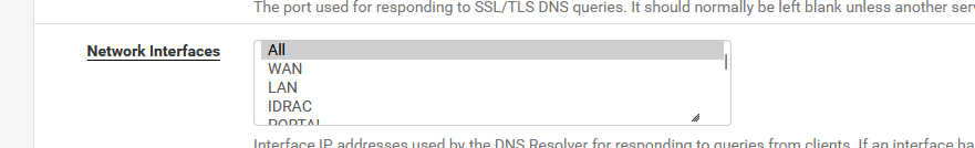

        Gertjan @lef
        @lef
        Check if unbound is listening on 127.0.0.1 (and ::1) etc :
        [25.03-BETA][root@pfSense.bhf.tld]/root: sockstat | grep 'unbound'
        unbound  unbound    45089 3   udp6   *:53                  *:*
        unbound  unbound    45089 4   tcp6   *:53                  *:*
        unbound  unbound    45089 5   udp4   *:53                  *:*
        unbound  unbound    45089 6   tcp4   *:53                  *:*
        This means : unbound listens on all activated interfaces, this includes the two "localhost".
        This is the default unbound (resolver behavior) :
        And, sorry, have to ask : firewall rules aren't blocking DNS traffic ? ^^
