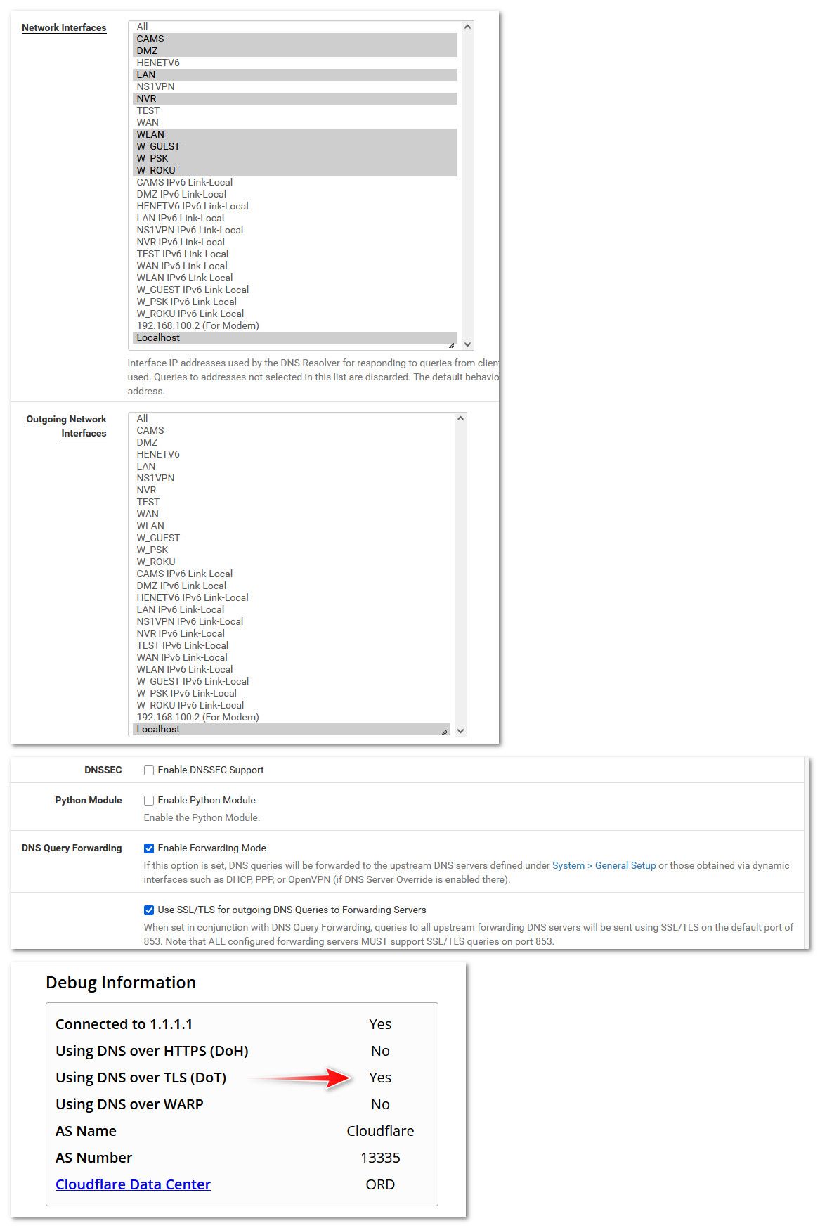

                @marchand-guy localhost would work with forwarding - or it should, there is no difference if its a tcp connection or just a udp send. I know I have switched over to tls fowarding for testing for other threads and never had to change that.
                localhost used as source will be natted as it leaves whatever interface your routing says to use to get to where its trying to go.
                edit: here I just turned on forwarding via tls to cloudflare (1.1.1.1) - sure seems to be working to me with just localhost as outbound.
                You can test if your using tls on cloudflare here https://one.one.one.one/help/
                Take this with grain of salt I guess - this is on my main 24.11 system.. I don't have 2.8 to test with as of yet - need to upgrade my 2.7.2 vm still to be able to test that.

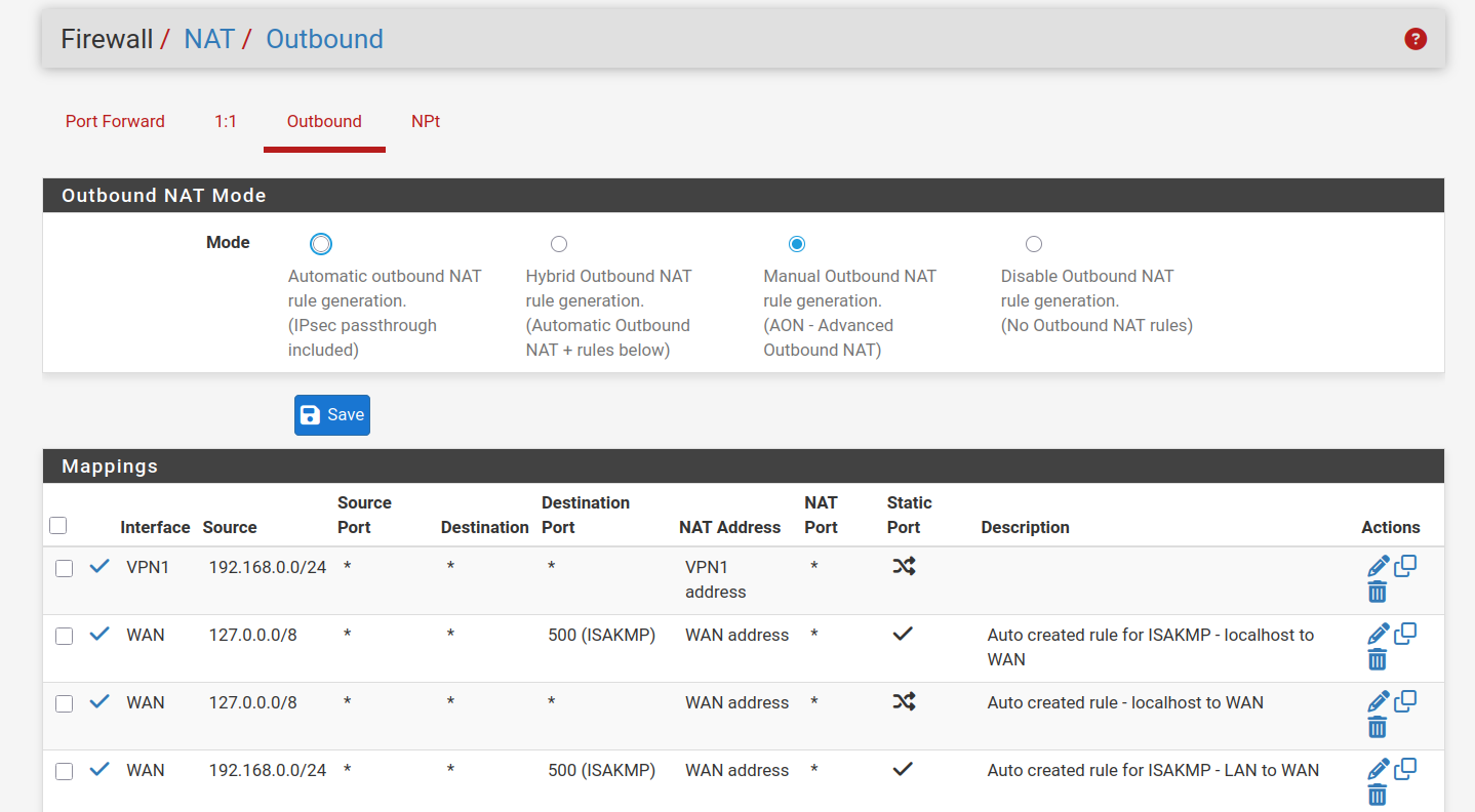

                      My outbound NAT rules are as follows:

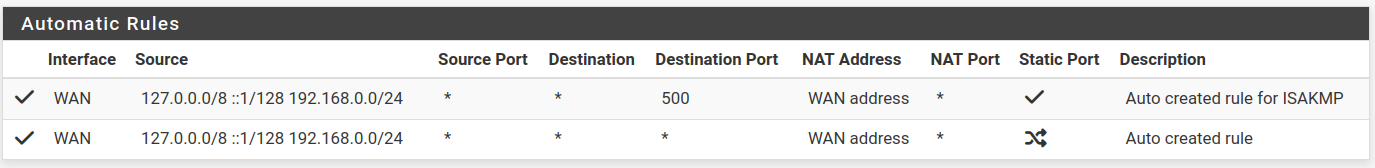

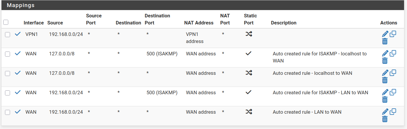

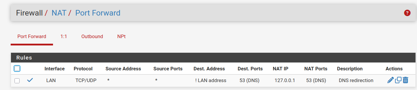

                              I could imagine the internal forward rule doing something odd at boot perhaps.

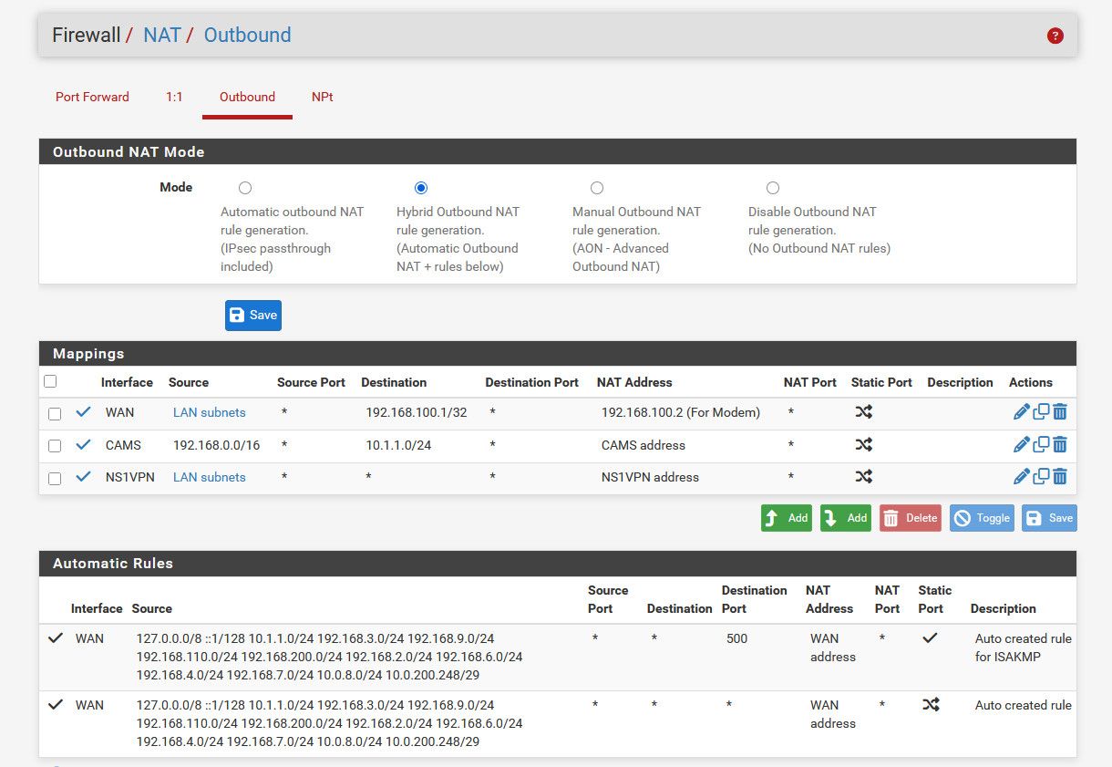

                                          Taking a look at your outbound nats - yeah those are borked if you ask me, and could explain your issues maybe - your forcing traffic out your vpn and have no nat for just your normal lan side networks to be able to use your wan IP natted. You followed some idiot guide from some vpn services didn't you.. There is zero reason to do manual outbound nat - just use hybrid and map what you would need for vpn interface you want to route traffic out.
                                          example: I can route anything I want out my vpn connection if I so desire..
                                          Those other outbound nats are to talk to my modem on its 192.168.100 address and I do source natting to talk to cameras behind a nvr because they use the nvr as their gateway.

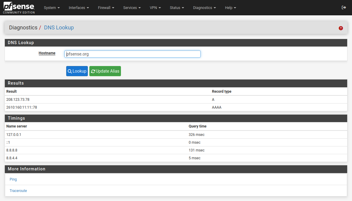

                                            What does DNS Lookup actually show? For example:
                                            That's with DNS set to 'use local, fall back to remote' in general setup.
                                            If you have other servers that are not responding you will see significant delays.
