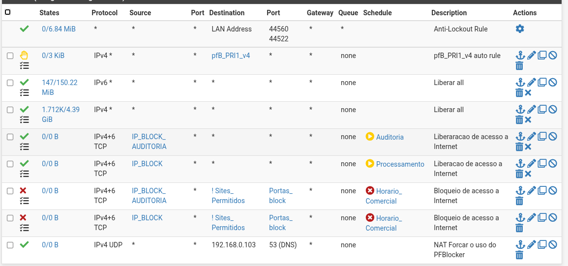

          And my rules is:

            SteveITS Galactic Empire @tchello
            @tchello FWIW your block rules will not trigger because they are below the allow-to-any rules. Note they are all "0/0 B".

            • T Offline
              tchello @SteveITS
              @SteveITS
              Yes, I agree, but I not use this rules, and I forgetd it of erase. My fault
