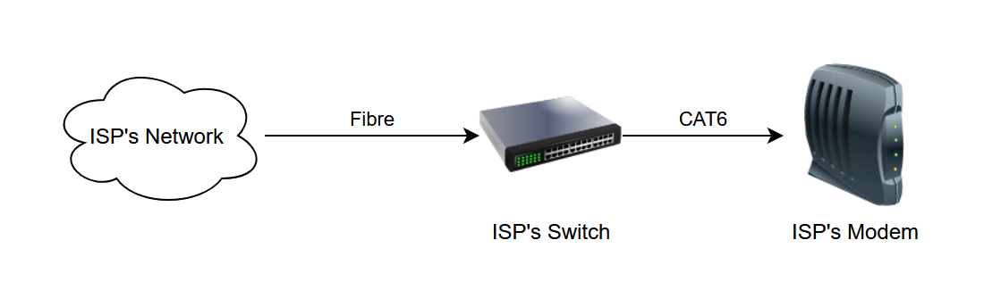

      This is how they provide their service:

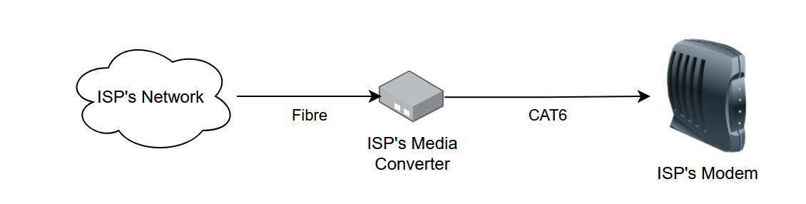

      Though I've heard at some sites, it's like this:
      So my thinking is:
      When the modem/router is reset, it loses all information stored on it. But when it is back online, it connects to the ISP in a matter of seconds. Since the ISP cannot embed the connection information into each and every device before they ship it, it has to be obtaining its configuration data from the ISP, and all the information necessary must be contained in ethernet frames.
