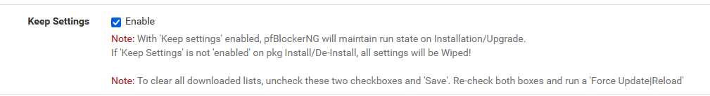

        @ddepaolis when you uninstalling pfBlockerNG you may Keep Settings then after upgraded, you just install pfBlockerNG back, every configuration will be restore from you last config.
          The safest way to upgrade is to remove packages. But it will should work without doing so. I have upgraded numerous devices without removing any packages.
          The most important thing is to have some recovery method in place before hand so you can get back if the upgrade doesn't go smoothly.
          Yes, all packages should retain their settings when removed. When you reinstall them they should be as before.

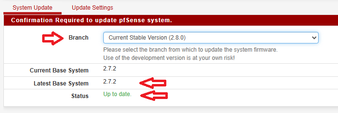

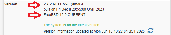

                  It did the big package download then the reboot then came back up, but it was not properly on the new version, notice it says FreeBSD 15, but still version 2.7.2:
                  So it seems the initial update of the underlying FreeBSD system and reboot succeeded but the upgrade of PFSense packages must have failed. No errors displayed in the GUI, so no indication of problems outside of manually looking through /var/log/system.log.
                  The GUI also seemed confused about whether the system was up to date and what version it should be on, with it stubbornly insisting it was up to date and not letting me retry the upgrade:
                  I think I eventually changed the wanted version in Update Settings back to 2.7.2, saved, then changed it back again and saved and then it let me upgrade again.
                  It seemed to go through the same upgrade process again and after the reboot now reported 2.8.0 and was mostly working, but once again I was having an issue with Squid crashing which uninstalling and reinstalling the squid package did not fix - so probably the shared library issue again.

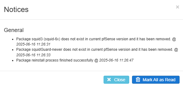

                    Just stumbled across this notification on System 3 that I had somehow overlooked:
                    This occurred after a format and fresh install directly to 2.8.0 followed by restoring the configuration backup made in 2.7.2. (which had squid/squidguard installed and enabled)
                    I guess that explains why Squid was not installed - this seems similar to the Avahi issue I had last year where it said something similar that the package did not exist when it tried to reinstall it after upgrading from 2.6 to 2.7.0.
                    Is there some kind of naming discrepancy of these packages between different major versions of PFSense that can cause this ?
                    I'm assuming that if I restored a backup taken in 2.8.0 into a fresh install of 2.8.0 that it wouldn't happen, although I haven't tried this.
                      Hmm, those packages have never existed in the pfSense repos. But I see that they do exist in the 3rd party pf2ad repo.
                      It looks like your pfSense install was using that at some point and pulled in those pkgs. But since they don't exist in the official repos it was unable to reinstall them.

                          @stephenw10 Ok I recovered a decrypted backup from the auto config backup service and you're right - it was the 3rd party Squid and SquidGuard installed at least according to the package section of the config xml. (Different "internal name") My bad.
                          Do you think that could have caused the partial failure to upgrade where it reported FreeBSD 15 but remained on PFSense 2.7.2 ?
                            Yes. If there was a custom repo present on the system it likely would have overridden the system repo even after it was updated. So you may have ended up with the Core repo correctly seeing 2.8 and the custom repo for everything else.
                            In general using custom pkg repos is a bad idea. But if you choose to do it (for anyone else reading this) be aware of the risks:

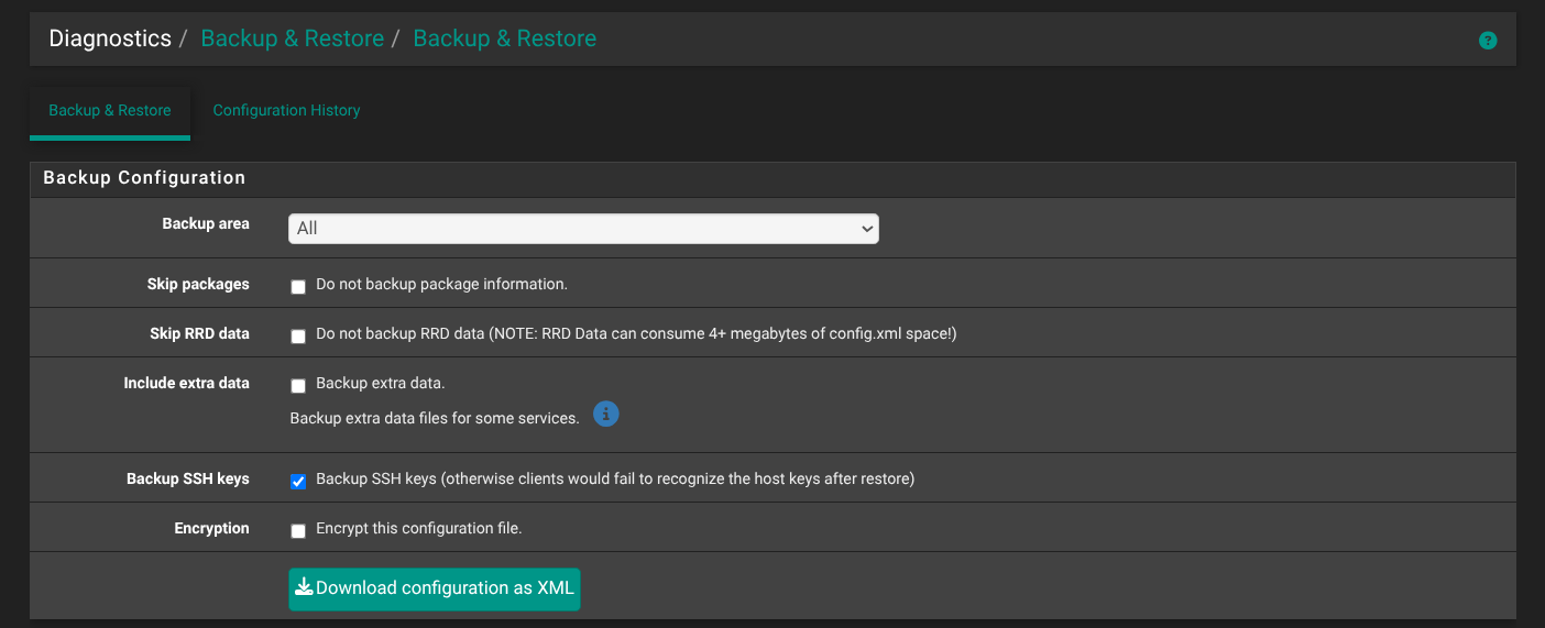

                              Another option, is to backup your full config:
                              Then use fresh 2.8 USB stick to wipe and install 2.8.0. After booting to a new fresh install, use the backup config to restore. (i have not tried this method, but I was told in the forums here it would work)
                                Yup a clean install and restore will always work. Having that prepared and available is always a good idea.
