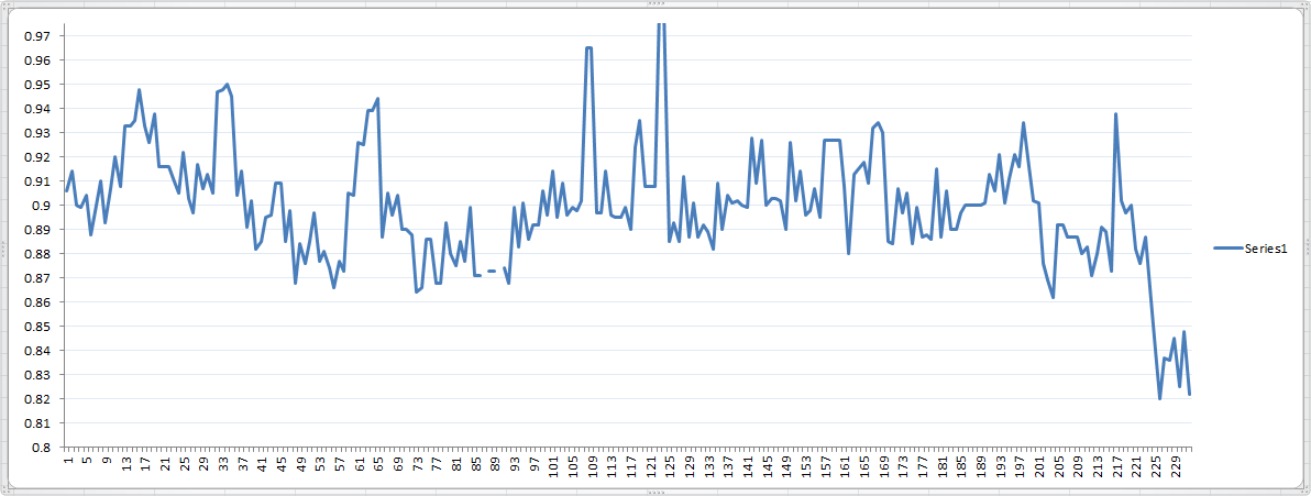

                                        Just checking the power log for the server and showing a saving of about 75-100 watts per day since changing over to python mode. Or about £8 a year in electricity.
                                          You mean Watt-hours per day? That's significant. Nice
                                          randombitsR 1 Reply Last reply Reply Quote 0
                                          • randombitsR Offline
                                            randombits @stephenw10
                                            @stephenw10 Yes, I meant Wh it went from ~900 watt hours to ~825 watt hours per day.
