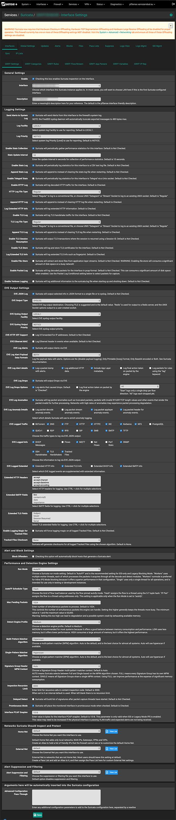

      Attached you will find a complete overview of the Suricata Interface settings.
      Yes, I know the warning says the hardware offloading needs to be all disabled but I have triple checked this in the network settings and they are indeed turned off.
      The option Log Priority is now set to "Notice" but it gives no effect in the logfiles if I change this to "Alert" or any other value listed here.

        @Stef_R said in How to get Suricata Alert logs to display correctly in Graylog Dashboard?:
        Is there a setting on pfSense or Suricata that I overlooked and that needs to be set for this type of fields to be selected on the dashboard widget?
        No, the Dashboard Widget only displays the first X alerts based on timestamp (where "X" is the number of alerts to display). The Dashboard Widget does not offer any type of alert filtering.
        If you are exporting all the alert data to Graylog, then you would do your filtering there. Most folks configure an external ELK stack to get the nice filtering and pretty pie charts from Suricata data. The package on pfSense is dedicated solely to doing the actual IDS/IPS work. It is not designed for pretty logging and graphs 🙂.
        Note that when you export via syslog that the text field length is limited by FreeBSD to, I believe, 512 bytes if memory serves me correctly. Any text in the exported messages exceeding that limit is truncated. That's why most users employ ELK instead of syslog for exporting EVE JSON data from Suricata to an external repository for filtering, processing, and presentation.
