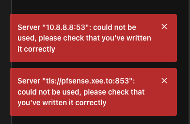

      On 2.8.0, AGH can't connect to Unbound and testing produces the error:

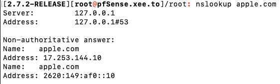

      Unbound seems to be working as verified by performing DNS queries directly on the pfSense system itself (via SSH). So nslookup using 127.0.0.1 works fine in 2.7.2 and 2.8.0

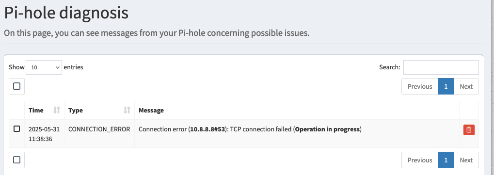

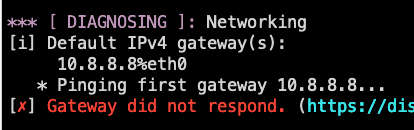

                        I've since also installed PiHole and verified it too fails with pfSense 2.8.0 (as upstream), while working fine with 2.7.2
                        The PiHole docker has a working shell and I can run queries from it, unlike with AGH.

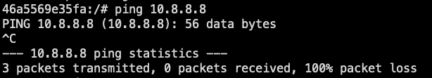

                        From the PiHole docker container, I can't reach pfSense 2.8.0 - timeout on ping
                        I thought it might be a docker-specific issue as I can ping from a Debian LXC, another VM, Unraid, my Mac, etc. But ping from another random docker container also seems to work as expected.
                        So so far, it's AdGuard Home and PiHole dockers I can't get sorted.

                                  I believe I've found the issue causing the weird behavior.
                                  In looking at the MAC addresses captured, I can see that the "wrong" address is 02:42:0a:08:08:02
                                  When using macvlan, the MAC always defaults to matching the specified IP address, but the incorrect address above doesn't.
                                  So I then took a look at the lease table and saw this:
                                  Hmm... That's not right. But it's the same wrong number. Looks like it's ignored in 2.7.2 and not ignored in 2.8.0
                                  I made an edit to the reservation, put the correct 0A in there and... Look at that, MAC comes up to match in 2.8.0 and replies start working.
                                  SonofA....
