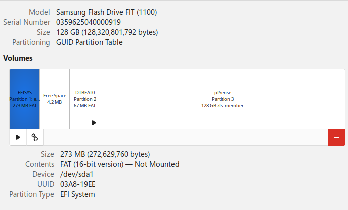

          Here's how the USB stick is currently partitioned:

                It's probably because the eMMC has failed to read-only and that means it has a zfs zpool named 'pfSense' on it that can't be erased. And that means that if you install to USB as ZFS using a zpool named pfSense it will conflict and may mount root from eMMC instead of USB.
                So either install to USB as UFS (I recommend that) or rename the zpool in ZFS.

                    Good news. I was able to format the USB drive as UFS, reinstalled, and everything is up and running on my (now) backup 1100.
