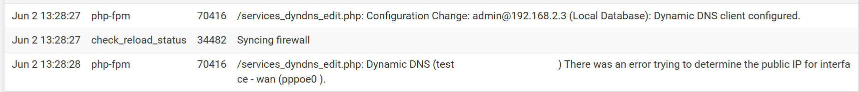

        @power_matz said in Update 2.7.2 to 2.8.0 Dynamic DNS not working with Cloudflare:
        I have the same issue here
        Hello,

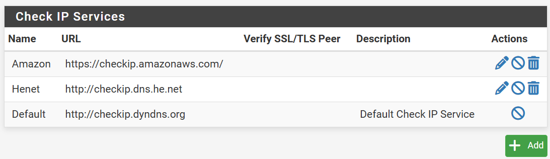

        can you try to add as check service: http://checkip.dns.he.net ? or: https://checkip.amazonaws.com/ ?
        pfsense 2.8.1 CE

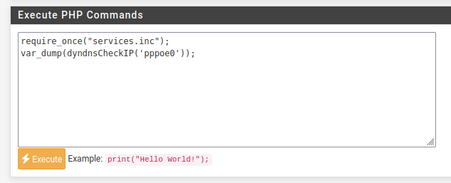

          Try running in Diag > Command Prompt:
          It should return the correct public IP as a string.
          Is everyone hitting this using pppoe by chance?
          P fireodoF 2 Replies Last reply Reply Quote 0

            @fireodo I added both services. Without any success
            fireodoF 1 Reply Last reply Reply Quote 0

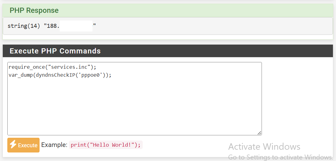

              power_matz @stephenw10

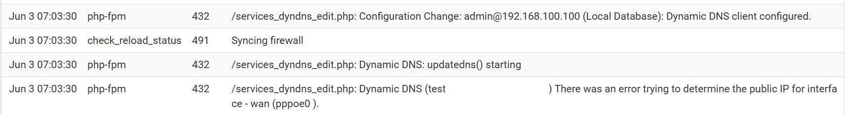

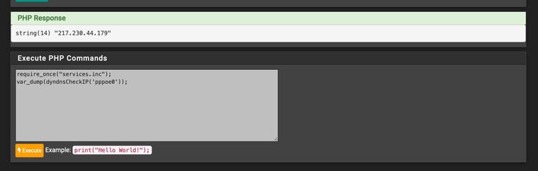

                  • N Offline
                    nation
                    @stephenw10 same output here. it show my correct ip8303b1e7-bae0-4d44-a1e4-715311b3f78a-image.png
                    i've tried the webpage also return the correct ip
                    @fireodo i've added both of sites, same result
                      Hmm, the error it's showing should be independent of the service in use. It tries to read the IP, checks its a valid IP address and fails that check.
                      I'm wondering if it's passing the wrong interface type after the pppoe changes hence asking if anyone is hitting it on a non-pppoe wan?
                      Also is anyone using using not the actual 'wan'? Like opt1, opt2 etc?
