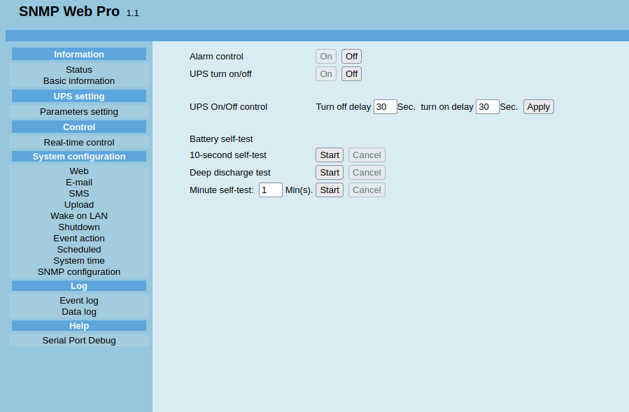

@dennypage
this is the web gui
i try the test in the second pic
I received a message that the operation was successful.But I don't think it did anything
because the UPS didn't go into a state where there was no power

I received a message that the operation was successful.The test in question, calibration of run-time, is the deep discharge test. May not be necessary.
