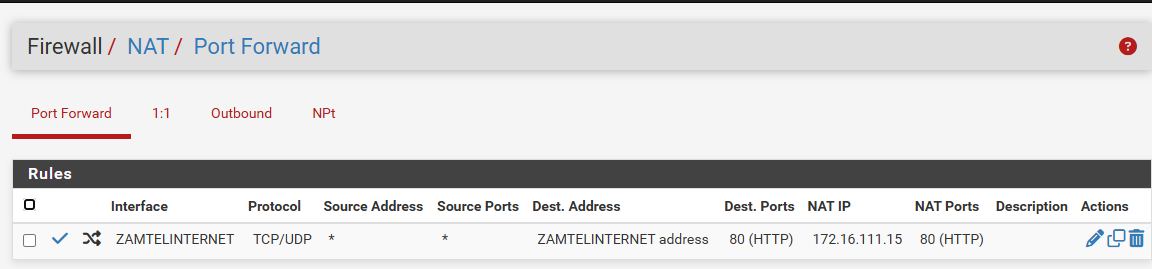

              samweli @Gertjan
              @Gertjan
              Thanx once more,
              45.215.255.224 is the device outside the network tring to access 172.16.111.15 which is the web server inside the betwork.

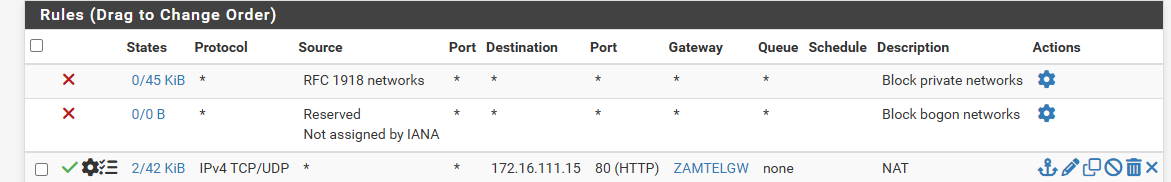

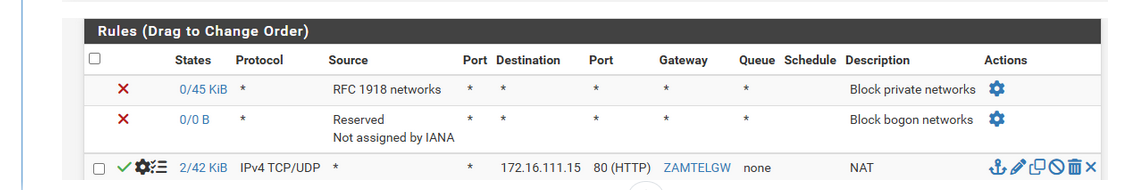

                samweli @Gertjan
                @Gertjan

                    samweli @Gertjan
                    @Gertjan You are right. 172.16.111.15 is a LAN host on 172.16.0.0/16 network on the LAN side. The WAN IP is sitting on the ZAMTELINTERNET interface
                      Gertjan @samweli
                      @samweli
                      So traffic should come in into the WAN IP, with as destination the WAN IP.
                      Your packet capture, you were using the WAN interface, right ? an not LAN ?
                      From there on, the WAN IPv4 and the destination port = 80, matches with a WAN firewall rule, the firewall rule that belongs to the NAT rule. If the two match,n then the traffic is mapped to the LAN network, the IP 172.16.111.15. same port.
                      Btw : Web server traffic is TCP only.
                      This :
                      You've set a gateway ?
                      Please read [Port Forwarding](https://docs.netgate.com/pfsense/en/latest/nat/port-forwards.html¶ one more time.
