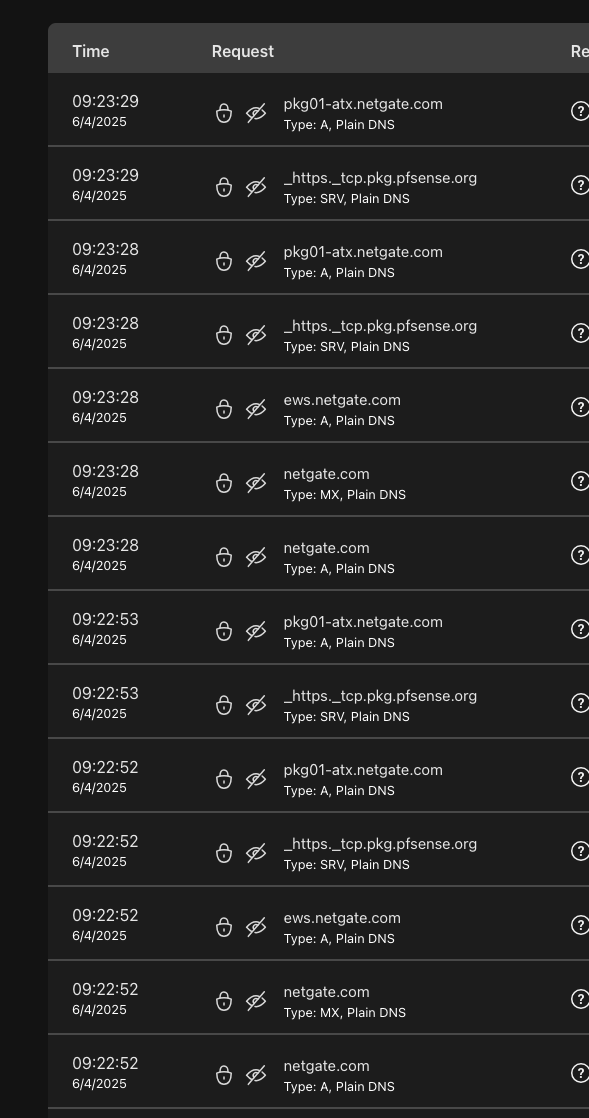

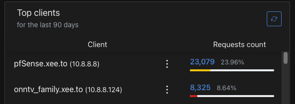

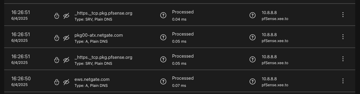

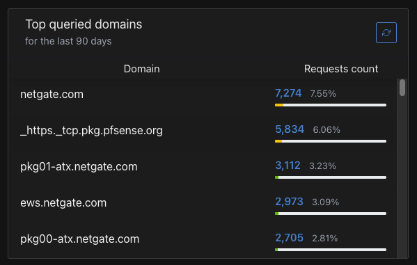

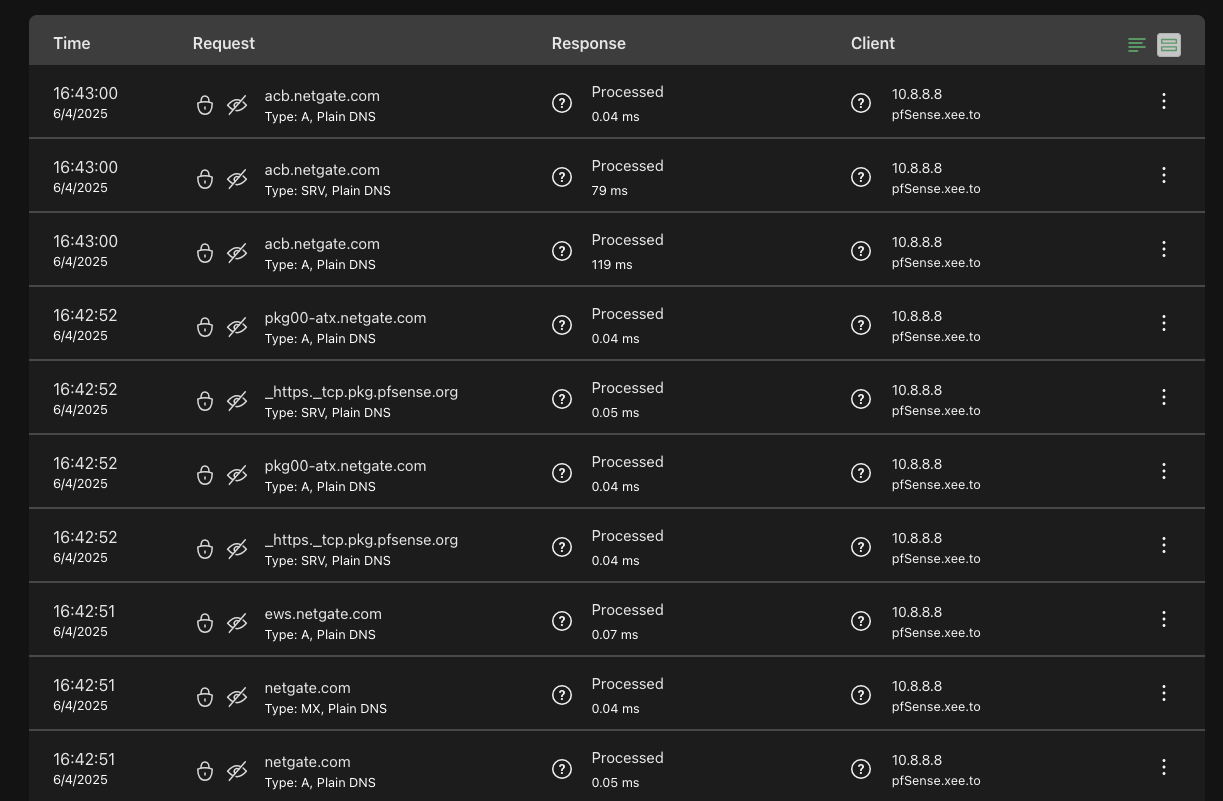

      This is more of an annoyance than anything. There shouldn't be any functional effect with the behavior described below.
      After updating to 2.8.0 I'm seeing a lot of calling home action coming from pfSense - this is after turning OFF check for webUI updates.
      Logging courtesy of AdGuard Home - pfSense is the busiest client on the network, with 10-30 queries every 60 seconds.
      However often queries happened with 2.7.2, they were few enough to not be of notice in the logs when compared to other clients.

        @binfree Just conveniently flipped-on pfBlockerNG's DNS Reply Logging setting to confirm—and I'm not seeing that here on 2.8 CE.
        Perhaps you could say a little more about your local DNS configuration, including pfSense host and where/how else services are being hosted/served on your LAN?
          johnpoz LAYER 8 Global Moderator @binfree
          @binfree do you leave the webgui open? I don't see a reason why pfsense would look for those unless the gui is open to be honest.
          And normally pfsense would ask itself first, which they should be cached.. for the length of the ttl - some of those are short, I show that pkg01-atx with a 300 second ttl. So seems odd that even if pfsense wanted to talk to it every minute that you see queries until the ttl expired.
          Are you handing out a short ttl to pfsense?

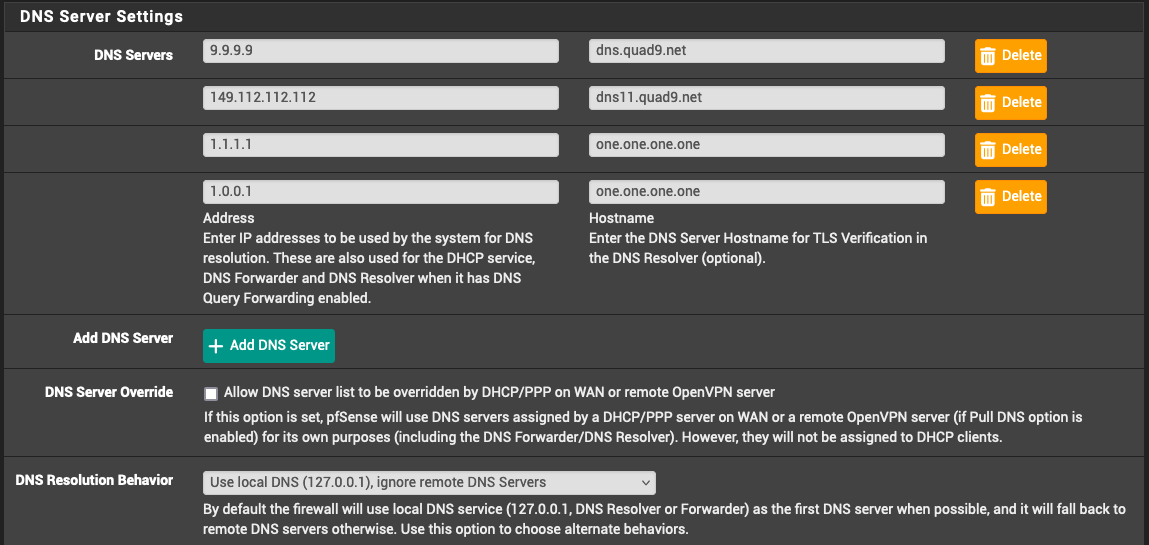

            Upstream public DNS defined in pfSense General settings:

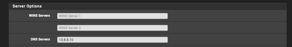

            DHCP (Kea) hands out my AdGuard Home IP for DNS:

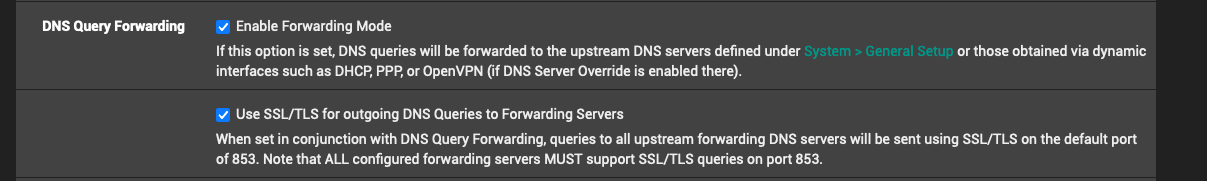

            Lastly, Unbound forwards to the first-mentioned public DNS when the lookups aren't private addresses.

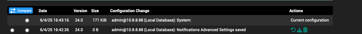

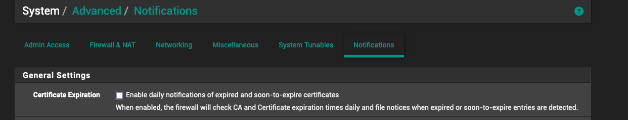

              While writing the reply above, the queries continued to be made and logged. I made a single configuration change:
              Specifically turning off the first option here:
              And now it's been over 10 minutes with no DNS queries from pfSense. This is doing my head in. :)
              It's 16:54 as I paste this:

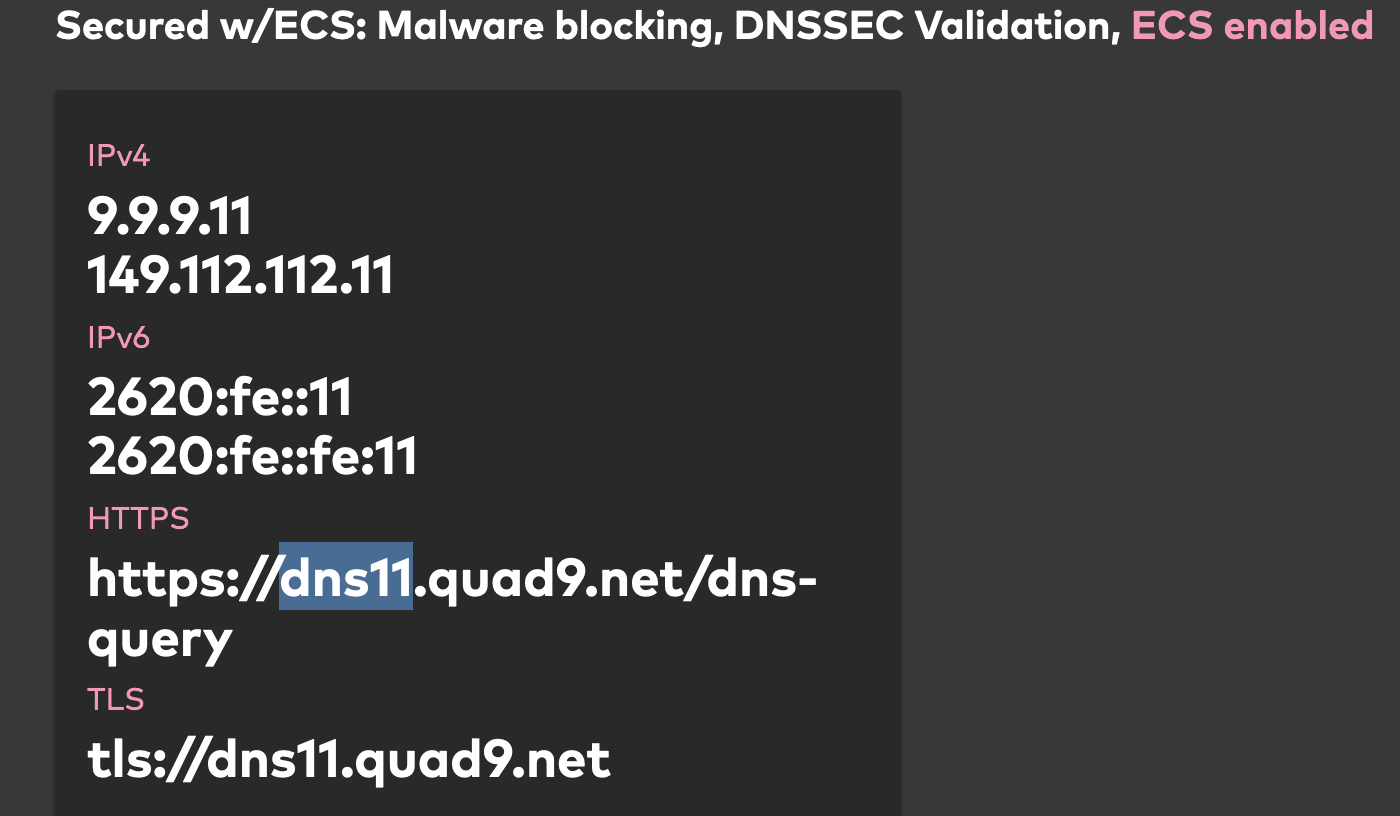

                If you're relying on the DNS Resolver (Unbound) to utilize DoT, dns.quad9.net should be used as the hostname for both of Quad9's nameservers and cloudflare-dns.com for both of Cloudflare's.

                    Yes. And it should have no bearing on this issue. It's just something I wanted to turn off. And writing settings to pfSense (at this time) suddenly and unexpectedly coincided with all DNS queries coming from pfSense stopping. Problem solved - but who knows why.

                      @tinfoilmatt said in Excessive "Call Home" DNS queries after update pfSense CE 2.8.0:
                      Can't remember why I forgot to change the IPs for quad9. The dns11 is correct, I just forgot to change the other entries - for DNSSEC/ECS.
                      Followed this for Cloudflare: DNS over TLS

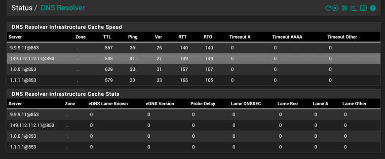

                          After reading the docs, pfSense should not be using the DNS server defined in DHCP - this is the only place AGH IP is defined as I recall. It should use only the resolver which uses the DNS servers listed above as it's in forwarding mode.
                          And if I check the resolver status, it only knows about the upstream DNS entries:
                          So no idea how/why pfSense was sending requests to AGH. Must be a bug somewhere.

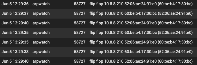

                                Then there's this other set of flip-flops which are all over the log, coming from a x86 machine running Unraid that only has a single NIC connected to the network with the MAC 60:be:b4:17:30:bc (S-Bluetech, limited). I don't know of anything on the network with the other MAC. The only MACs even starting with 54 are virtual from QEMU.
