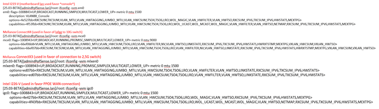

          I did find suggestions to place the following lines in loader.conf(5):
          mlx4en_load=“YES”
          mlx5en_load="YES"
          Or perhaps better to put in tunables
          mlx4en_load, value = YES
          mlx5en_load, value = YES
          (I do not know if that advise is still valid / a good advice for the actual FreeBSD version, however that are the Mellanox drivers)
          Looking a bit deeper. For that I used ^ifconfig -vvm <nic>^ which suggest that not all options available are turned on for the nic-cards I am using. So next to question if the ^optimal driver^ is loaded, perhaps additionally some driver related settings have to be added or changed. Perhaps best also via the tunables (or ideally via the gui)
          See the picture below what I found using ifconfig -vvm
          ( I use a picture so that the option fields are all in one row)
