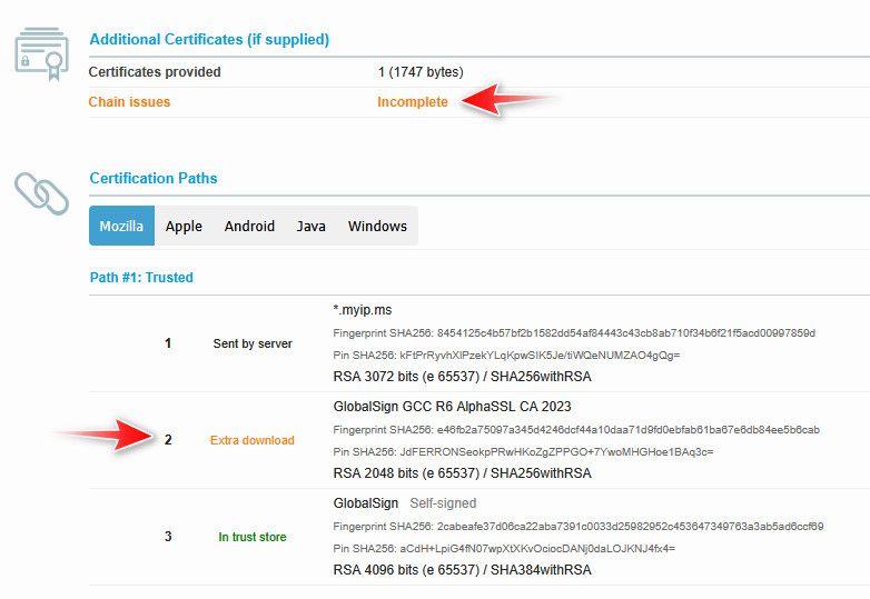

        @codechurn Their install is missing a cert. likely your browser has it from somewhere else.
        https://www.ssllabs.com/ssltest/analyze.html?d=www.myip.ms&s=146.59.166.237&hideResults=on&latest

                  @codechurn your best bet would prob be to run https://www.ssllabs.com/ssltest/
                  You can get more info from openssl s_client -connect fqdnorIP:443
                  But it can be a bit hard to interpret - with the ssl test above its clear what is not being sent

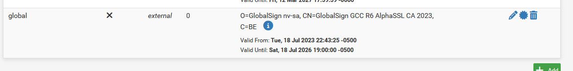

                  One fix is to add that missing ca to your authorities in cert manager. And have it add to trust store
                  But I think a piece that is missing in the info - maybe I just didn't see it, is you more than likely have to run
                  certctl rehash
                  after you add it - I did that and now your curl example that wasn't working is

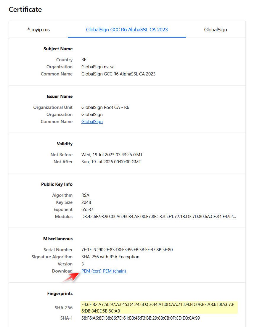

                  There is most likely a few ways to get the CA added to the trust store - but the cert manager gui is prob the easiest.. You can grab the missing one from firefox cert info..
                  Notice the fingerprint matches the one that the ssl showed as having to be downloaded extra.

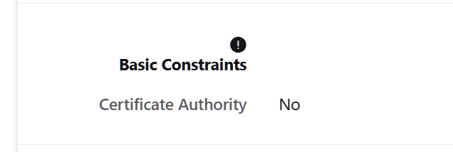

                      pfsjap @johnpoz

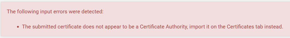

                      @johnpoz Can't install downloaded cert into Autorities in 25.3-BETA:
                      Event the Firefox cert info indicates that:
                      So how did you exactly managed to get it trusted?

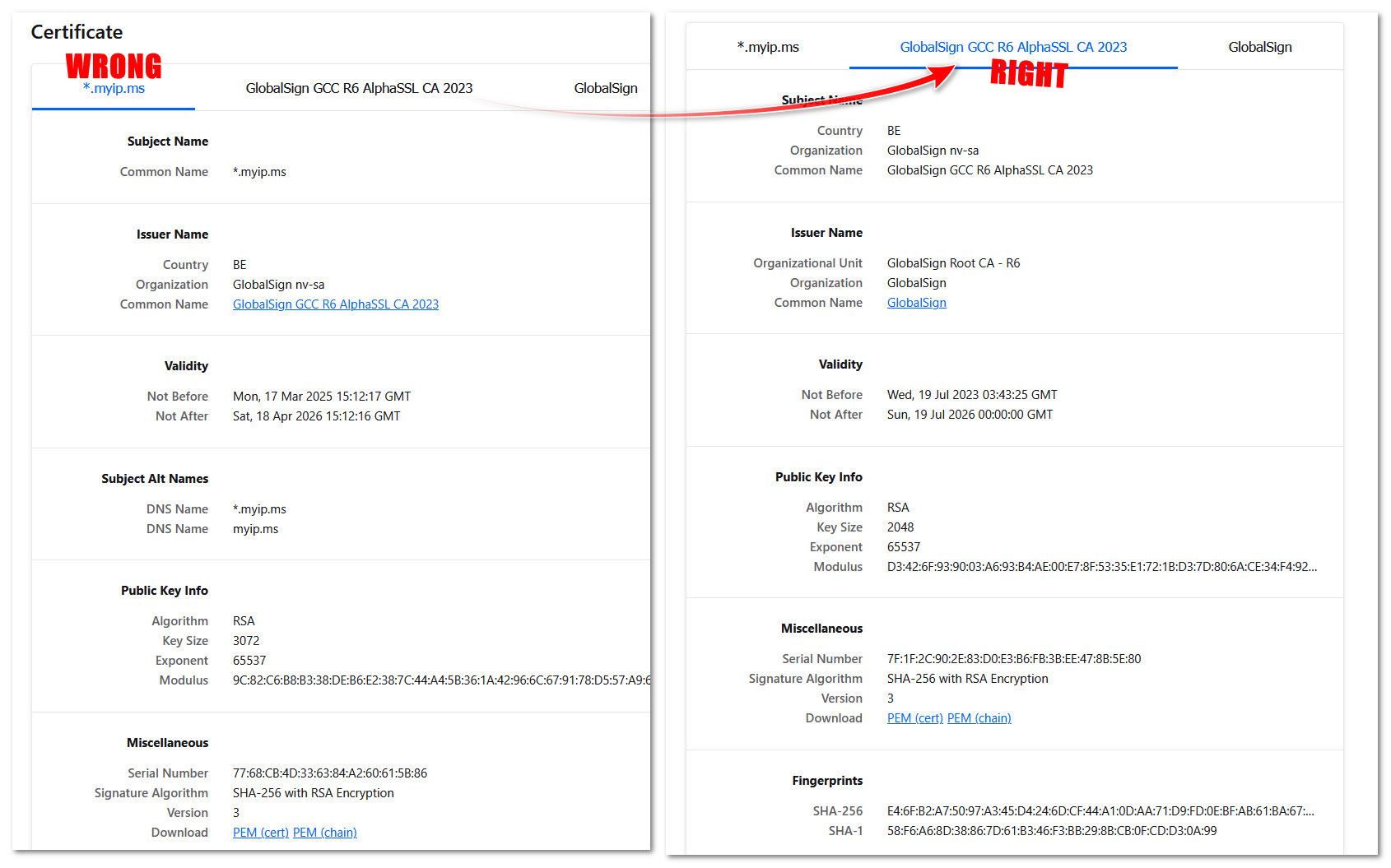

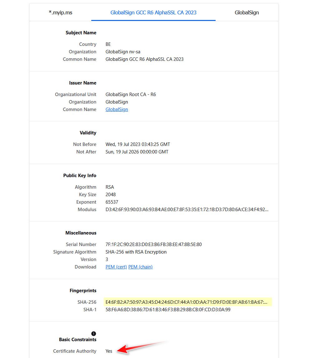

                        johnpoz LAYER 8 Global Moderator @pfsjap
                        @pfsjap you have to install the CA, clearly that cert your trying to install is not the CA cert.
                        You have to be on the CA page in firefox cert info to see the link - like in my screenshot.. Not on the cert page.
                        If you look above at my example - notice the fingerprint, as I pointed out is the same as what the ssl test site that told you was missing. And also notice it states it is a CA cert.
                        • P Offline
                          pfsjap @johnpoz
                          @johnpoz Yes, my bad, works now. Thanks!
