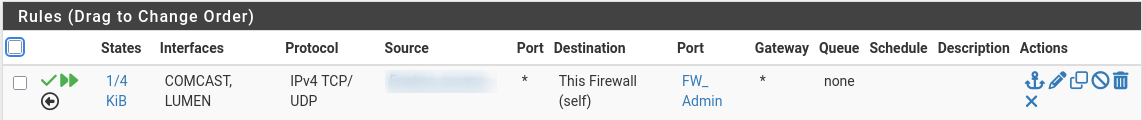

      We have a multi-WAN setup with two ISPs configured in a failover group. WAN1 is our primary and WAN2 is the backup. Fail-over works great! However, the issue is that, despite having the appropriate rules on each interface, I cannot access the admin interface from WAN2 while it isn't the primary gateway. I have a single floating rule for both interfaces which works to allow access when said interface is the primary gateway.
      When Comcast is the primary gateway I can access the admin ports via Comcast's IPs. When Lumen is the primary gateways I can access it via Lumen's IP address. But I can't access Comcast IPs when Lumen is the primary gateway and vice versa. It's essential that I have access over both links for remote maintenance.
      For troubleshooting I created individual rules under each interface with the same outcome. I even explicitly specified the gateway to use for each rule. No dice. In all instances I tcpdumped the interface and see my external packets arrive but no response is sent from the firewall.

        @Troutpocket said in Can't access admin on WAN2 unless it's the gateway:
        Did you disable the floating rule beforehand? And I wouldn't set a gateway there.
        • T Offline
          Troutpocket @Bob.Dig
          @Bob-Dig Yes, the floating rule was deleted. Setting the gateway was just an act of desperation.
