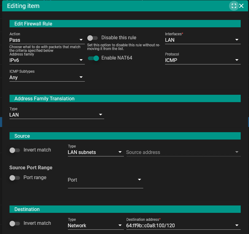

                                    LAN side inconsistently get NO_TRAFFIC:NO_TRAFFIC with 64:ff9b::7f00:1
                                      Hmm, that could be nothing if you're not seeing connection issues at the clients.

                                        ping6 -s56 64:ff9b::7f00:1
                                        ping6 -s32 64:ff9b::7f00:1
                                        Sometimes works, sometimes does not.
                                          Hmm, just with different ping sizes?
                                          MSS has no effect on pings, only TCP. So nothing should have changed there.
                                          fatheadF 1 Reply Last reply Reply Quote 1

                                            ping6 from lan side to pfSense it self and lan to lan.
                                            I have only tested with small packets, however so far size does not matter.
                                            Both fail sometimes:
                                            Even the default address of 64:ff9b::c0a8:101 sometimes fails.
                                            What I do not understand is why it comes and goes.
                                            setting lan side mtu/mss to 1.4k, 1.5k or 9k changes nothing.
