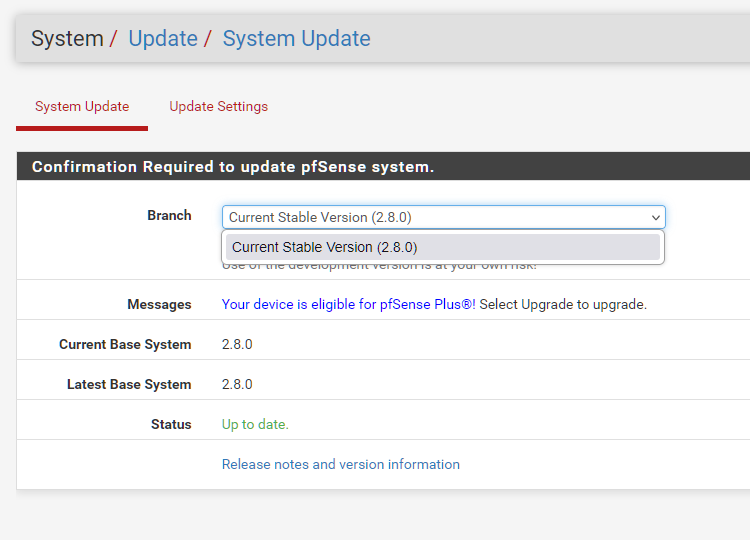

    Since upgrade to CE 2.8 the plus branche is gone.
    6 Posts 3 Posters 1.2k Views 3 Watching
    • G Offline
      Gerard64
      Wen ik click on "update settings" there is no other branche to select.
      I thought maybe reenter the token but wen i want to do that it says my system is already known bij Netgate.
      Somebody an idea what is wrong?
      • SteveITSS Offline
        SteveITS Rebel Alliance @Gerard64
        @Gerard64 2.8 is newer than plus 24.11. They probably don’t have an upgrade path for that. If it’s detected for the NDI you should be able to install Plus via the Installer.

          Hmm oke. I don't want to change from CE to Plus I just wanted to let you know the update/upgrade might not work right.

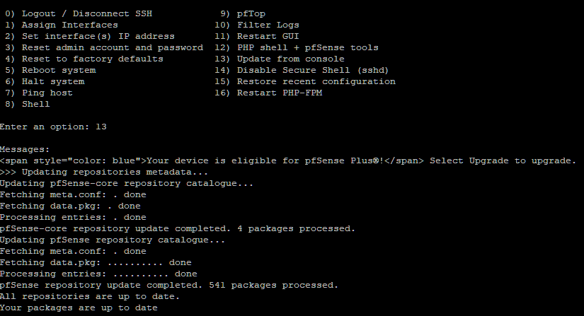

          I also checked the update option (13) in the shell with the same result.
          I don't think this looks right too with html tags showing?

            13/"update from console" runs the update. There isn't one yet, for 2.8. Not sure about the HTML there, that may be a bug. Probably few people put a token in the GUI and try to upgrade from console...? You could make a report at redmine.pfsense.org.

              That makes a lot of sense.
              Thank you!
                Yes, exactly that. You cannot downgrade and 2.8 is newer than 24.11. When 25.03 is released it show as an available branch for eligible devices.
