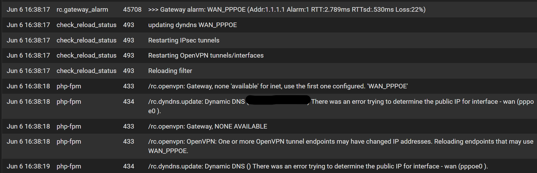

      The only logs that indicate an error are the the following, starting at the gateway alarm:

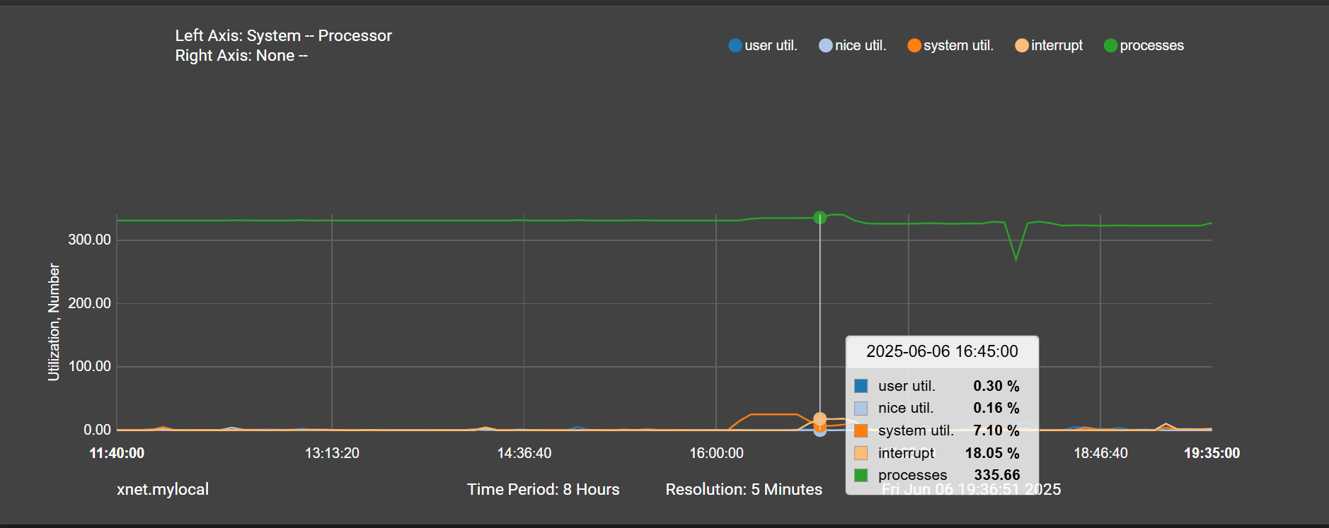

          Around this time there is a spike in system usage ~40 mins before a large spike in interrupts:

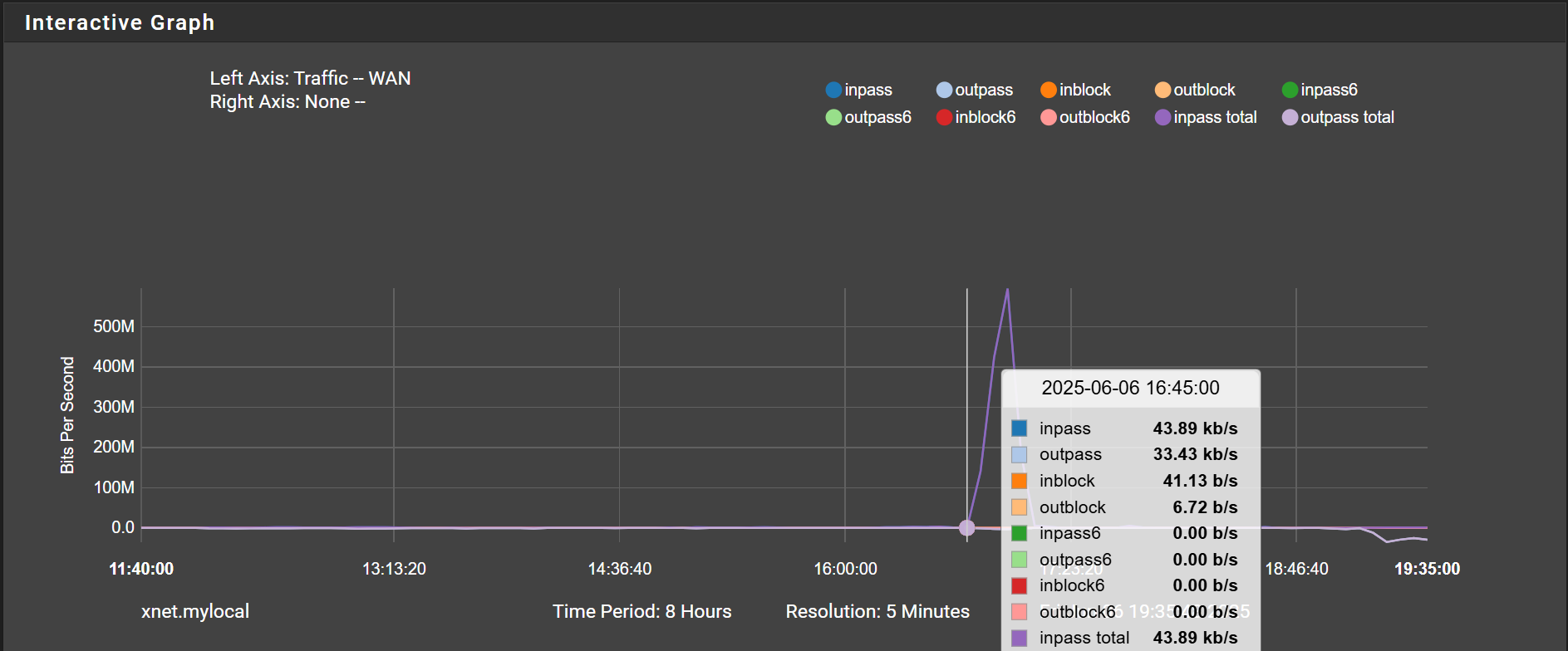

          And around the time of the interrupts a large influx of traffic into WAN:

            Hmm, >500Mbps is significant. Is that realistic for your connection?
            Do you see that traffic on any other interface? Like is it actually being routed?

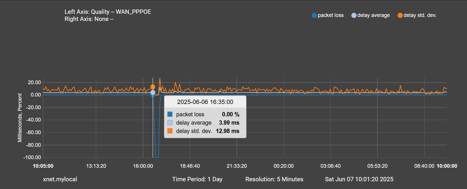

                                  Here is the packet loss beginning at 16:35:

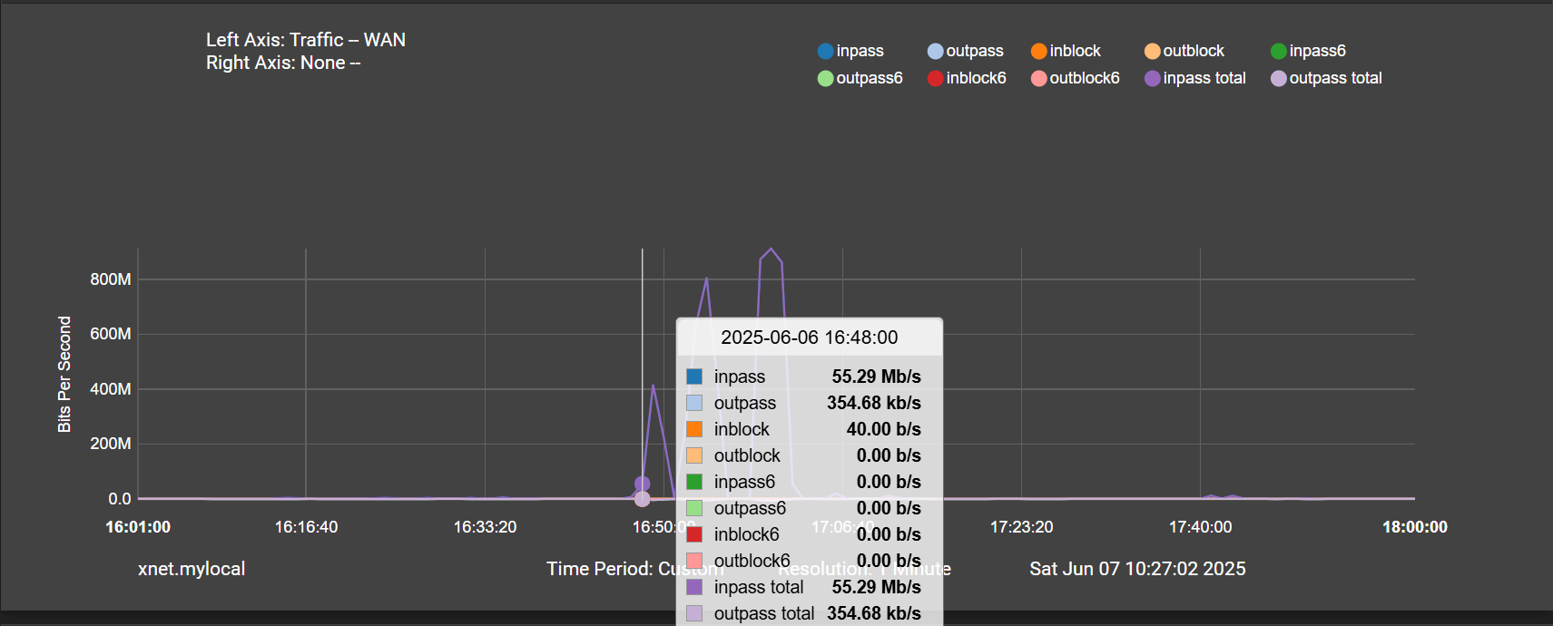

                                  And here is the beginning of the spike in traffic at 16:45:Screenshot 2025-06-07 100431.png
                                  Just seems a bit odd to me that its a spike in traffic minutes after pppoe is completely down and during a time when I had no internet. I guess what I'm getting at is the traffic spike seems more like a symptom given that it lags the drop in pppoe by such a long time, but maybe the graphs aren't to believed... not sure
                                    The RRD files average more the further back you go. You may be seeing some averaging there that hides the actual times involved.
                                    You can try to use a custom graph display value to show, maybe, only between 16.30 and 17.00 at the highest resolution available.

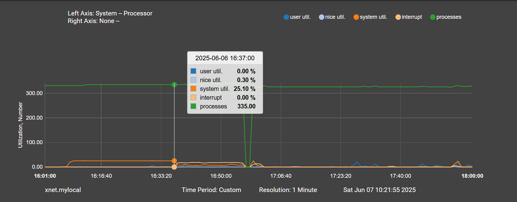

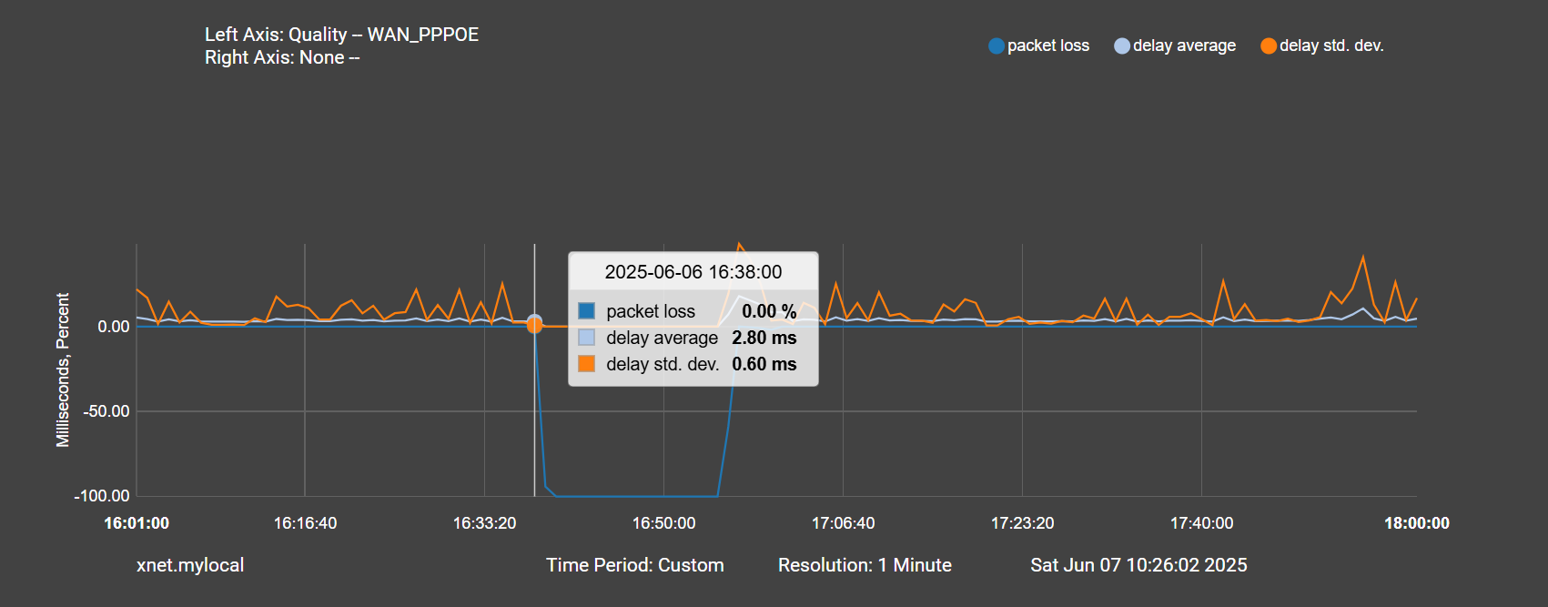

                                    • E Offline
                                      eldest @stephenw10
                                      @stephenw10 Thanks for that suggestion, I had no idea I could truncate the plots like that.
                                      Here is a zoomed in version. Again PPPOE drops at 16:38:Screenshot 2025-06-07 102701.png

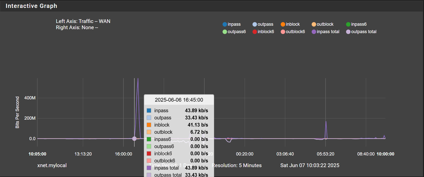

                                      Then 10 minutes later is the traffic spike:Screenshot 2025-06-07 102801.png
                                      And the precursor to all of this happening is an anomalously high system load, followed by high interrupts during the pppoe down event, nearly for 10 minutes before the high traffic:Screenshot 2025-06-07 102345.png
                                      This really makes me think the traffic isn't the issue. The high interrupts happen 10 minutes before any traffic on those plots.
                                        For bonus points you can show both plots on the same graph as left and right axis. 😉
                                        But yes I agree. The traffic starts to look like a symptom. Maybe something looping. It would still be very useful to get a pcap of it if you can.

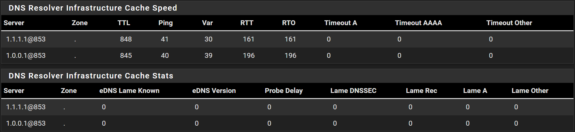

                                          It starts with unbound at extremely high usage, then slowly degrades from there. No anomalies in the DNS resolver logs. In fact, the only warning I can see in logs at all is from KEA:
