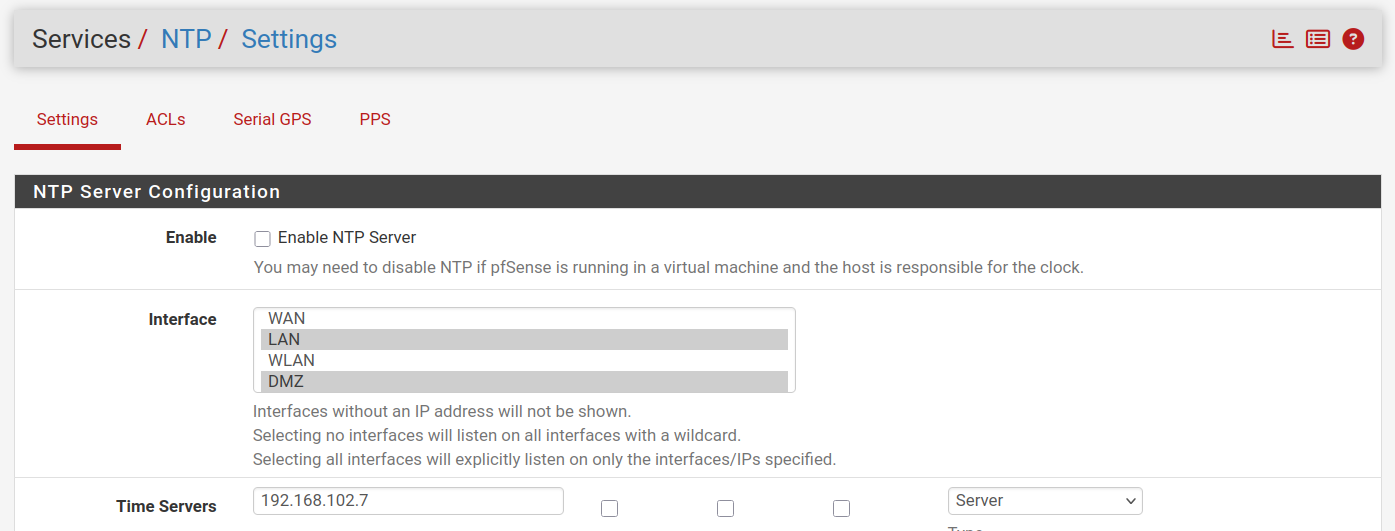

      pfsense NTP is not enabled. So no reason to block udp Port 123
      So do not really understand why pfsense block udp Port 123

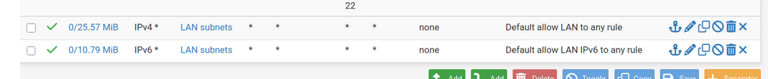

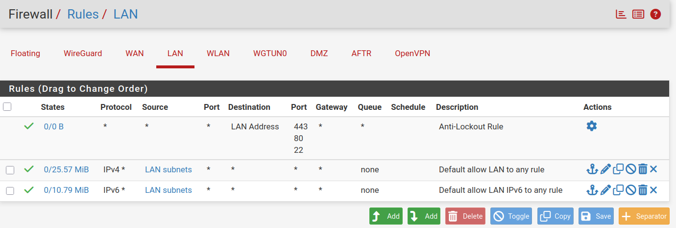

            Your LAN devices can go anywhere - no restictions :
            If :
            is situated in ones of these :
            (maybe not OpenVPN or WGTUN0)
            then your LAN devices can access these networks/IPs.
            @eagle61 said in NTP / UDP Port 123 blocked since update 2.7.2 -> 2.8.0:
            It seems some not visible unknown Firewall Rules block udp-Port 123.
            Create yourself a block rule like this - on the last line on LAN :
            and see for yourself it never logs, because it will never match, as the former two rules match for all possible traffic.
            So it won't be the final hidden firewall rule, identical to this 'block all' rule that block something neither.
            You can also packet capture on your LAN for UDP 123 and destination IP "192.168.102.7" and check if ntp traffic arrives at the LAN gates.
            Then packet capture on the 192.168.102.0/24 network so you'll see the same traffic going to "192.168.102.7" NTP server.
