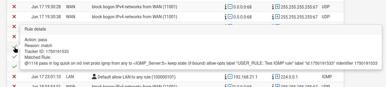

                                      • stephenw10S Online
                                        If you mouse over the rule you can check the actual rule number and tracker ID and then compare that with the output from pfctl -vsr:
