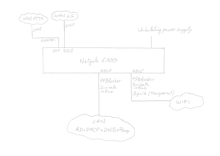

      Dear all,
      I replaced a perfectly working HP blade with a Netgate 6100 for two reasons:
      Reduce power consumption.
      Use an SFP port, which was essential for the ISP; the blade was too old.
      The router is no longer under warranty.
      My infrastructure is nothing special, everything was fine with the blade, but the 6100 has the LAN that randomly goes unresponsive about 2-3 times per day.
      The router is 100% up to date (OS, patches and all packages).
      I tried disabling packages one by one without success.
      I also tried disabling all packages, without success.
      I also tried disabling WAN failover, without success.
      I tried uninstalling all packages except HAPROXY for production reasons, still without success.
      I tried reset to factory default 3 times
      I can't find in the logs what's causing the crash, especially since the Wi-Fi is responding correctly and is configured like the LAN, except for the transparent proxy. The client retrieves an IP address from the Netgate's DHCP and can access the internet; however, LAN resources are inaccessible.
      The GUI interface is accessible via the WAN (public IP restrictions allowed) but is very slow.
      The GUI interface is no longer accessible via the LAN when it crashes, and no traffic works between the LAN and the router.
      Only restarting the Netgate resolves the problem; sometimes you have to restart it twice in a row.
      It works for a few hours, then crashes again.
      I've been in this situation since March 2025, and I can't take it anymore.
      I thank in advance anyone who can help me.

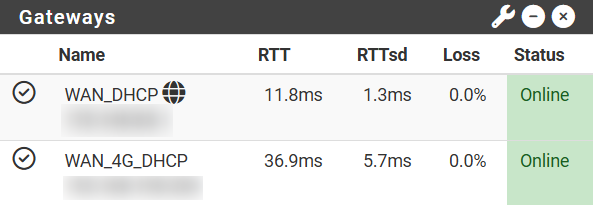

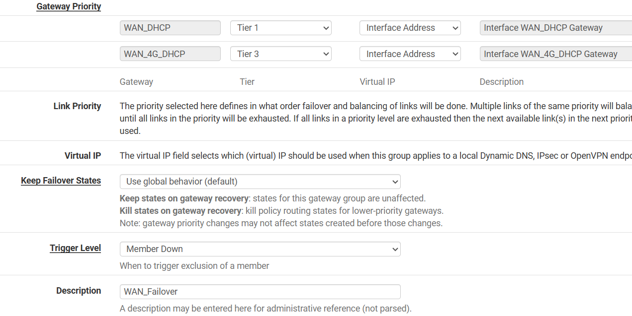

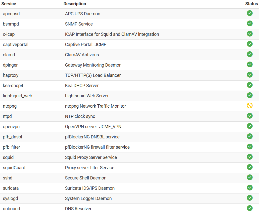

        Gertjan @Nightwolf
        @Nightwolf
        First, export your pfSense config.This allows you to go 'back in time' and find a known situation with one click.
        Next : remove 'useless' stuff that can eat loads of resource while offering real gain :
        I'll rephrase : go "clean machine" : make it look like the day you received it. The '6100' ou of the box experience is a 24h/24 service guaranteed and 'interruptions' are not on the feature list.
        So, exit : ntopng squid suricata as these are known to be very able in destroying your emmc drive as they can produce huge quantities of data (I presume you don't have the MAX version). You can keep pfBlockerng, just 'stop' it.
        You have your WAN marked as active, but no speed ? Do you need it ? Isn't the WAN_4G enough ?
