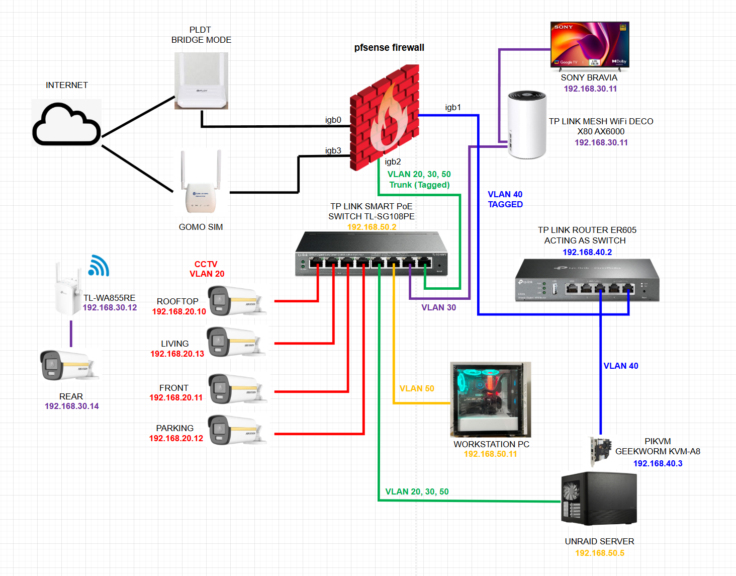

      Here's my current setup:
      Now, I'm adding PiKVM to my setup, but I want to place it in a separate VLAN (VLAN40), and I will put it in the igb1 port of pfsense. However, I have no other switch port on my current setup, but I have a TP-Link router that was used before, and I can use it as a switch. I disabled its DHCP server setting, and the setup now looks like this:
      The PiKVM is working well. It's getting IP from pfsense (192.168.40.x), has internet access, can ping and access all other devices in different VLANs, and can even access pfsense itself.
      But I cannot access PiKVM from the WORKSTATION PC or my UNRAID server. In pfsense, I added rules that ALLOW ALL traffic IN and OUT from VLAN 40 and VLAN 50. What could be the problem?

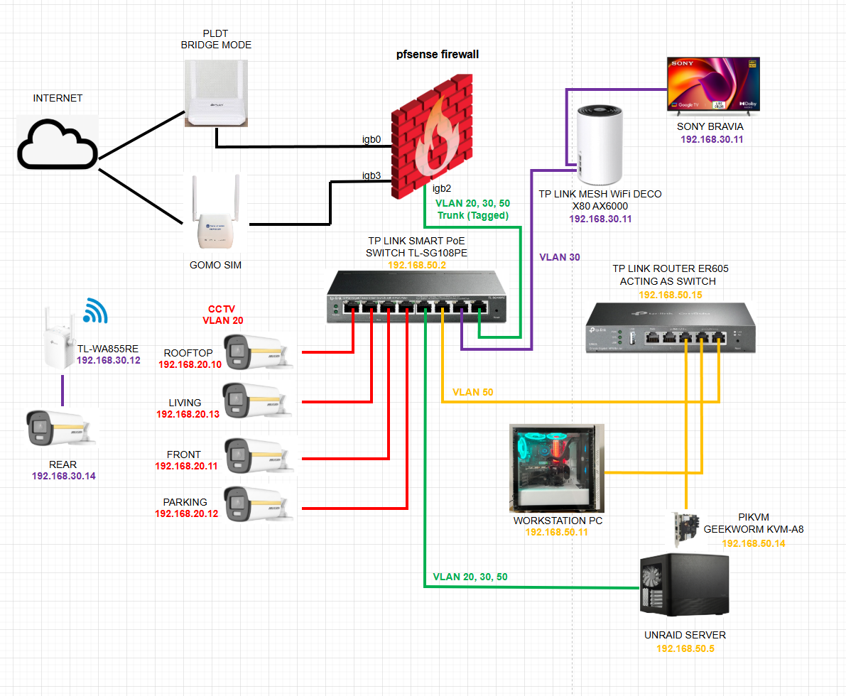

      I ended up with the setup below. But I want to place PiKVM as much as possible in a different VLAN so I can add its own rules.

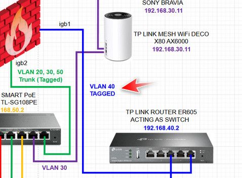

                Why are you tagging vlan 40 to that er605, you sure you have the vlans setup correctly on it.. if your directly connected to igb1 on pfsense - that network should/could just be just native, it should not be a vlan in pfsense. If your not going to put more networks on that specific interface there is little reason to tag it, especially if your sending to some switch that only will have that network on it, etc.
                HHUBSH 1 Reply Last reply Reply Quote 0
                  If I don't tag vlan40 on switch er605, the PiKVM is not getting IP address from pfsense.

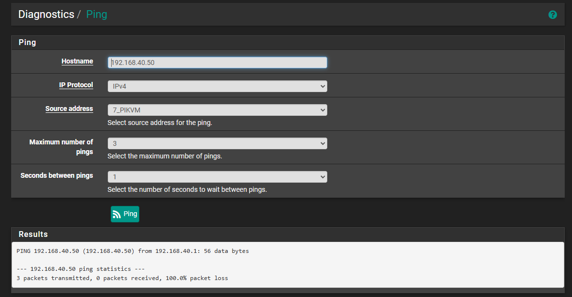

                    • HHUBSH Offline
                      HHUBS @johnpoz

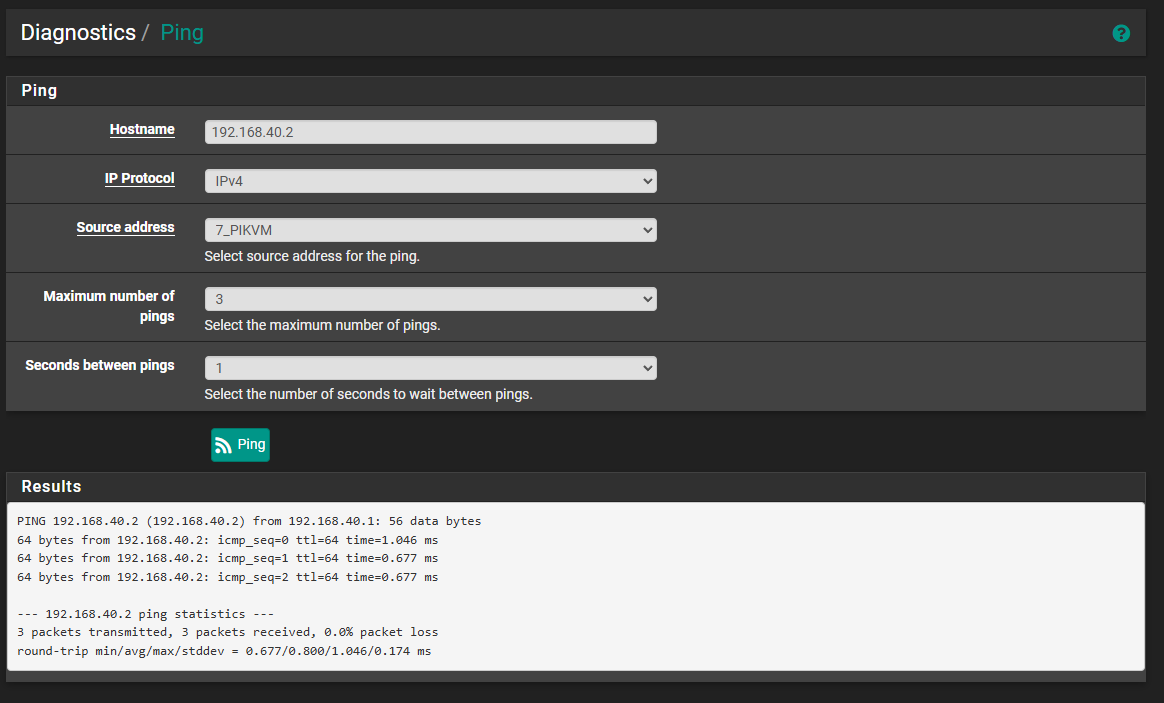

                      @johnpoz Hey brother, I can ping using the interface IP 192.168.40.1 to the TPLINK ER605 192.168.40.2
                      But I cannot ping the PiKVM(which for the mean time I use a laptop), 192.168.40.50 which is connected to ER605.
                      I also cannot ping 192.168.40.2 if my source address is the other VLAN except VLAN40.
                      I have not use TAG VLAN40 in pFsense. It was directly connected and This is my settings in the ER605.
                      I can ping all other VLANs from the laptop 192.168.40.50.

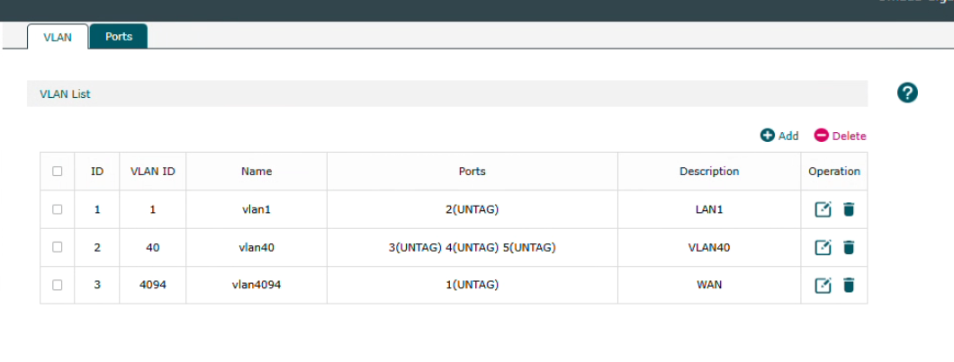

                      • johnpozJ Online
                        johnpoz LAYER 8 Global Moderator @HHUBS
                        @HHUBS and where is the simple packet capture I told you to do? We already knew your device didn't answer.. I just want to show you its not pfsense problem..
                        If your tagging out of pfsense?
                        Which port on the er605 is connected to pfsense - that port would have to be tagged for 40. The port connected from the er605 to your kvm wouldn't be tagged.
                        I don't show any ports tagged with 40 on your er605.. I show port 3,4 and 5 untagged 40.. So then your setup on pfsense that port should be just a native network and not a vlan.
                        if you connect pfsense igb1 to port 3 on your er605 and your tagging on pfsense (ie a vlan) then port 3 should be tagged 40 in your er605,f and then if port 5 is connected to your kvm - that would untagged 40.
                        If your going to set the er605 up with 3 ports in vlan 40 as untagged then pfsense interface needs to be just native untagged network.
