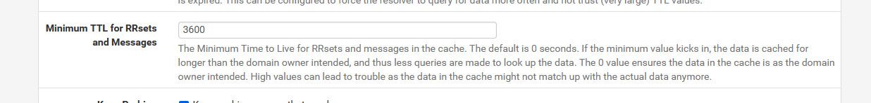

              Apologies if this is a silly question but are you suggesting i change the TTL on the Firewall. If so what setting is that, please?
                johnpoz LAYER 8 Global Moderator @Rosstopher
                @Rosstopher change it in your unbound settings.
                Under advanced
                  As @johnpoz said though, that will only work as long as the servers/applicatipns are using pfSense for DNS or course.

                      i have tried altering the settings suggested but with no success, traffic still hit the default deny rule.
