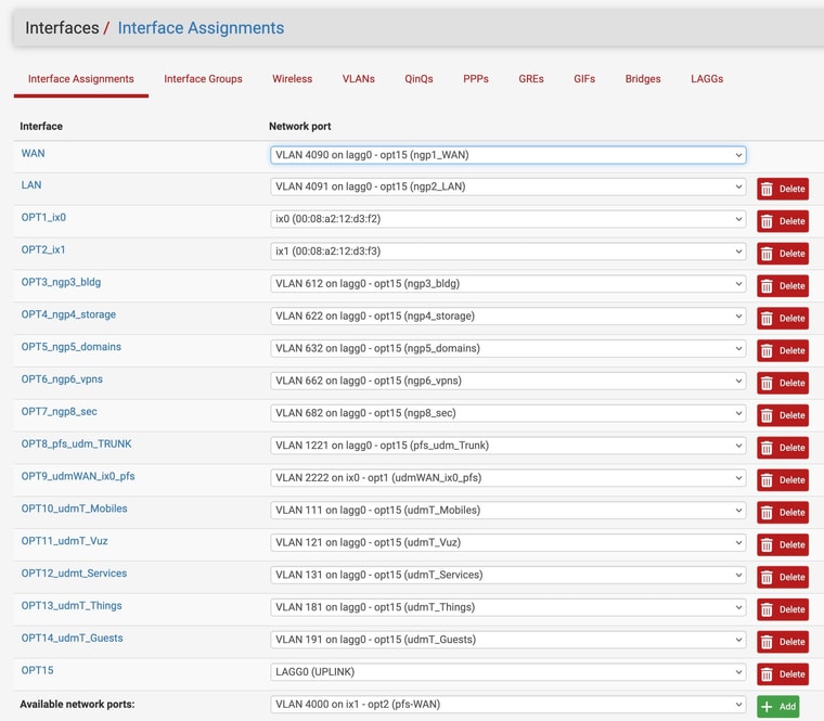

      NGP1_WAN (wan) -> lagg0.4090 -> v4/DHCP4: 138.....
      NGP2_LAN (lan) -> lagg0.4091 -> v4: 10.33.33.1/24
      NGIX1_WAN_EVENTUALLY (opt1) -> ix1.4000 ->
      NGP3_BLDG (opt2) -> lagg0.612 -> v4: 172.16.12.1/24
      NGP4_STORAGE (opt3) -> lagg0.622 -> v4: 172.16.22.1/24
      NGP5_DOMAINS (opt4) -> lagg0.632 -> v4: 172.16.32.1/24
      NGP6_VPNS (opt5) -> lagg0.662 -> v4: 172.16.62.1/24
      NGP8_SEC (opt6) -> lagg0.682 -> v4: 172.16.82.1/24
      UDMT_MOBILES (opt7) -> ix0.111 -> v4: 192.168.111.1/24
      UDMT_VUZ (opt8) -> ix0.121 -> v4: 192.168.121.1/24
      NGP7_SERVICES (opt9) -> ix0.131 -> v4: 192.168.131.1/24
      UDMT_GUESTS (opt10) -> ix0.181 -> v4: 192.168.181.1/24
      UDMT_THINGS (opt11) -> ix0.191 -> v4: 192.168.191.1/24
      NGIX0_PFS_T_UDMWAN (opt12) -> ix0.2222 -> v4: 10.22.22.1/29

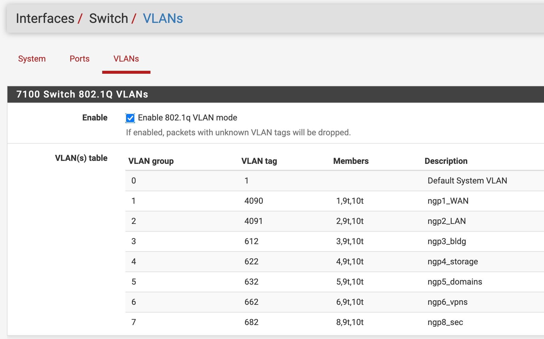

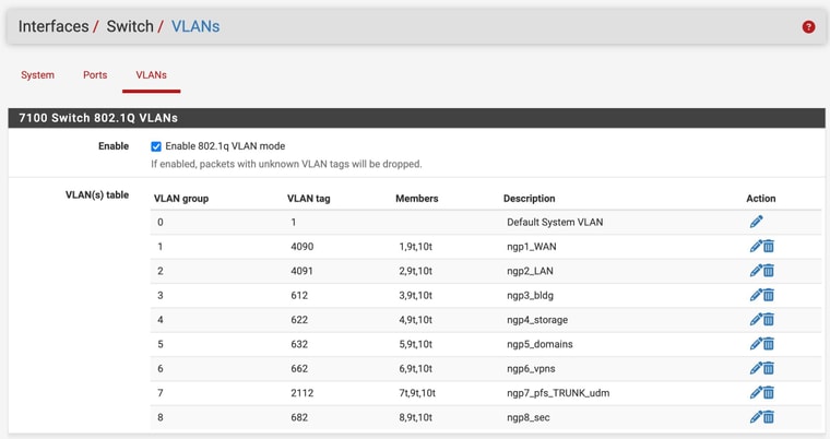

      The Switch VLANs look like this...

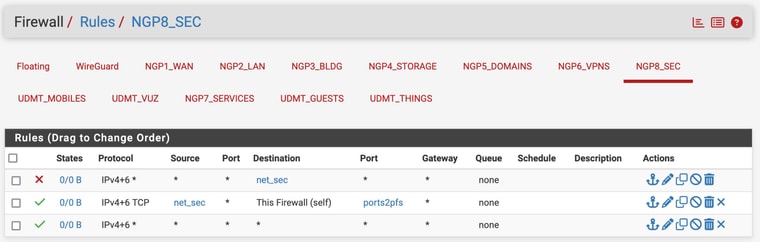

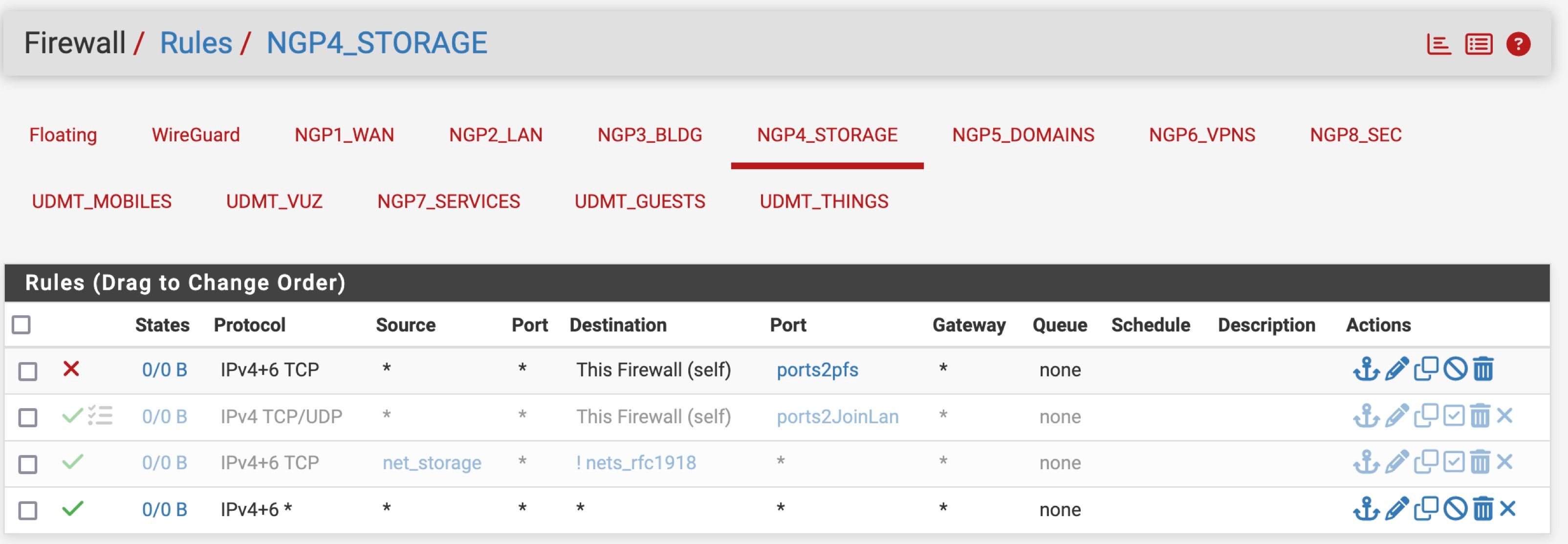

      Port 4 ruleset seems open:

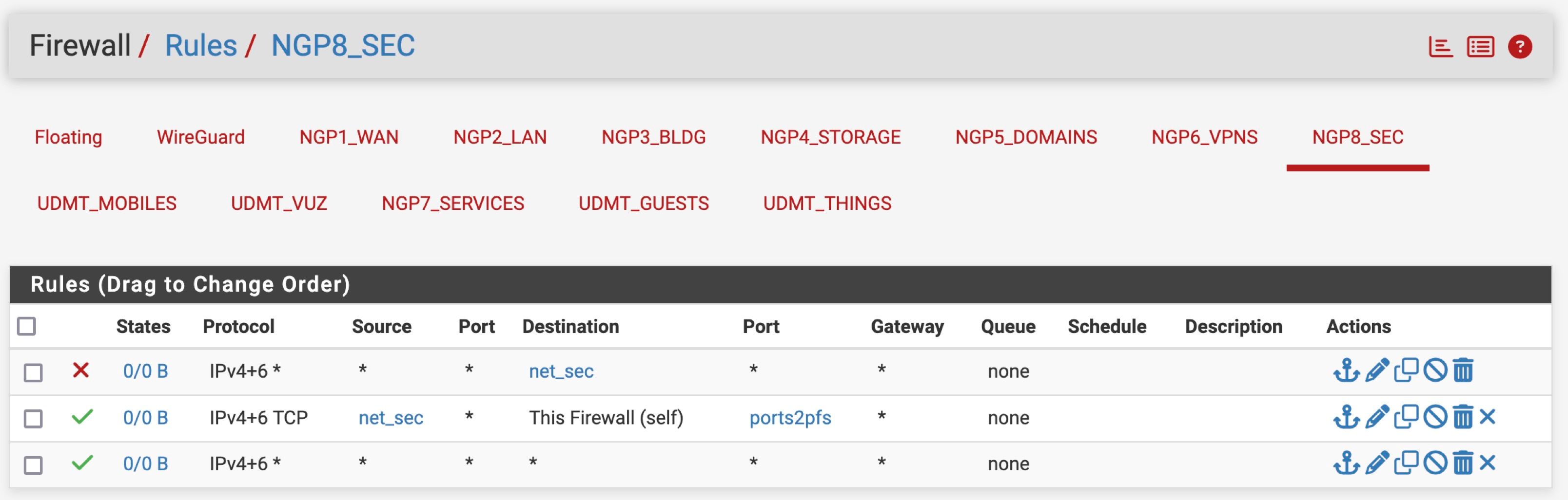

      Same with Port8:

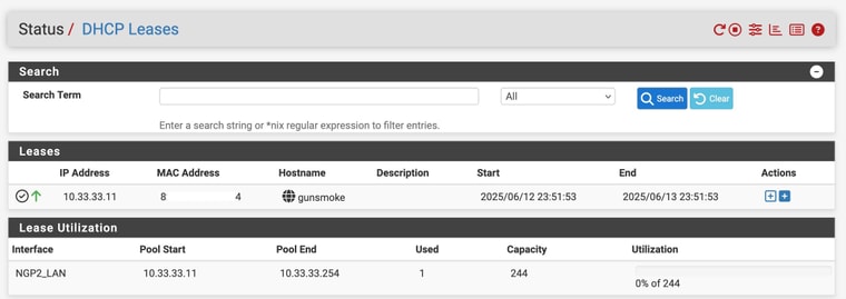

      None the less, the attached devices get little love from DHCPd as only the LAN device can connect...
      Nothing in the system log about dhcp or within the dhcpd log, save the complaint about multithreading...

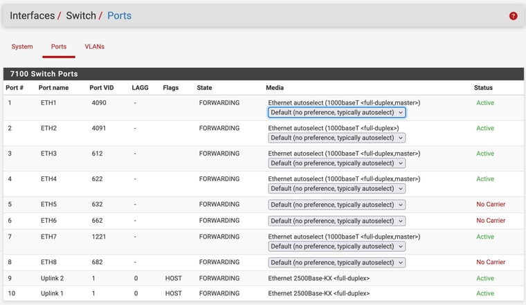

        Have you enabled DHCPd on NGP4 and NGP8? It's only enabled on LAN by default.
        Have you set the PVID in the switch ports tab to match the VLANs?

          Here's what console shows:
          OPT1_IX0 (opt1) -> ix0 ->
          OPT2_IX1 (opt2) -> ix1 ->
          OPT3_NGP3_BLDG (opt3) -> lagg0.612 -> v4: 172.16.12.1/24
          OPT4_NGP4_STORAGE (opt4) -> lagg0.622 -> v4: 172.16.22.1/24
          OPT5_NGP5_DOMAINS (opt5) -> lagg0.632 -> v4: 172.16.32.1/24
          OPT6_NGP6_VPNS (opt6) -> lagg0.662 -> v4: 172.16.62.1/24
          OPT7_NGP8_SEC (opt7) -> lagg0.682 -> v4: 172.16.82.1/24
          OPT8_PFS_UDM_TRUNK (opt8) -> lagg0.1221 -> v4: 10.12.21.1/29
          OPT9_UDMWAN_IX0_PFS (opt9) -> ix0.2222 -> v4: 10.22.22.1/29
          OPT10_UDMT_MOBILES (opt10) -> lagg0.111 -> v4: 192.168.111.1/24
          OPT11_UDMT_VUZ (opt11) -> lagg0.121 -> v4: 192.168.121.1/24
          OPT12_UDMT_SERVICES (opt12) -> lagg0.131 -> v4: 192.168.131.1/24
          OPT13_UDMT_THINGS (opt13) -> lagg0.181 -> v4: 192.168.181.1/24
          OPT14_UDMT_GUESTS (opt14) -> lagg0.191 -> v4: 192.168.191.1/24
          OPT15 (opt15) -> lagg0 ->
          and that reflects my intention.

          I checked, and each and every one of those interfaces have DHCPd enabled.
          At present each of these interfaces, all enabled; are DHCPd configured with "Allow all Clients". No matter which switch port I plug Annabelle into, she reports the LAN address - without fail.
          Per the description, "When set to Allow all clients, any DHCP client will get an IP address within this scope/range on this interface. "

            The firewall rule for OPT4_NGP4_STORAGE allows everything, that can't be the show stopper.
              stephenw10 Netgate Administrator @stephenw10
              @stephenw10 said in XG-7100 & Unify console troubles: ix0, ix1, dhcp-kea & now sore head:
              Let's see that tab then.
              Or the output of etherswitchcfg.
              • P Offline
                pfS_noob_cust @stephenw10
                etherswitchcfg
                Here's the latter...
                etherswitchcfg
                etherswitch0: VLAN mode: DOT1Q
                port1:
                        pvid: 4090
                        state=8<FORWARDING>
                        flags=0<>
                        media: Ethernet autoselect (1000baseT <full-duplex>)
                        status: active
                port2:
                        pvid: 4091
                        state=8<FORWARDING>
                        flags=0<>
                        status: active
                port3:
                        pvid: 4091
                        state=8<FORWARDING>
                        flags=0<>
                        media: Ethernet autoselect (none)
                        status: no carrier
                port4:
                        pvid: 4091
                        state=8<FORWARDING>
                        flags=0<>
                        media: Ethernet autoselect (1000baseT <full-duplex,master>)
                        status: active
                port5:
                        pvid: 4091
                        state=8<FORWARDING>
                        flags=0<>
                        status: no carrier
                port6:
                        pvid: 4091
                        state=8<FORWARDING>
                        flags=0<>
                        status: no carrier
                port7:
                        pvid: 4091
                        state=8<FORWARDING>
                        flags=0<>
                        status: active

                  in. addition, here are the interface vlan & assignments pages...

                    In "Interfaces / Switch / VLANs", all the VLANs you define on "Interfaces / VLANs" do have to exist too.
                    For example, the VLAN 622/ngp4_storage is now VLAN 60 on the Switch / VLAN page but still VLAN 622 on the Interfaces / VLAN page.
                    Do you mind me asking, how well do you understand VLANs, tagged and untagged, access ports?
                      Yeah you haven't set the PVID on the switch. All the ports are still set to 4091 so no inbound untagged traffic will work. Except on LAN where it's still using 4091.
                      You need to go to Interfaces > Switch > Ports and set the correct PVID for each port.
                      https://docs.netgate.com/pfsense/en/latest/solutions/xg-7100-1u/configuring-the-switch-ports.html#ports
                        Ah also the VLAN tags on the switch no longer match the VLANs you have added on lagg0. Previously they did. You'll need to set those back to match.

                              I failed there too! Didn't understand the switch ports page. fixed that so they match now.

                                @patient0 I think it's fixed now.
                                  Yup looks good.
                                  Just for reference the PVID on port 7 doesn't matter because the VLAN there is passed tagged. It usually doesn't hurt to set it there though.
