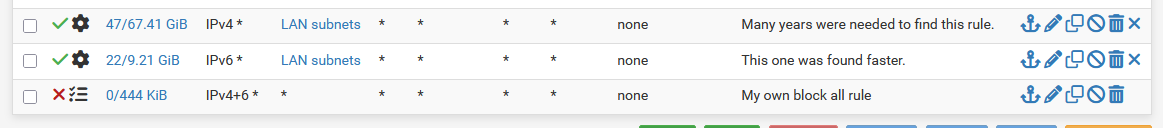

            This is what I have in firewall rules:
            0/0 B
            * RFC 1918 networks * * * * * Block private networks [not new]
            0/2 KiB
            * Reserved
            Not assigned by IANA * * * * * Block bogon networks [Not new]
            0/0 B
            IPv4 TCP/UDP * * WAN address 5060 (SIP) * none NAT call centric
            That last one I added yesterday trying to match what the VOIP vendor suggested for pfSense.
            I see your rules but I'm not sure how to effect those in my level of pfSense 2.7.2.
