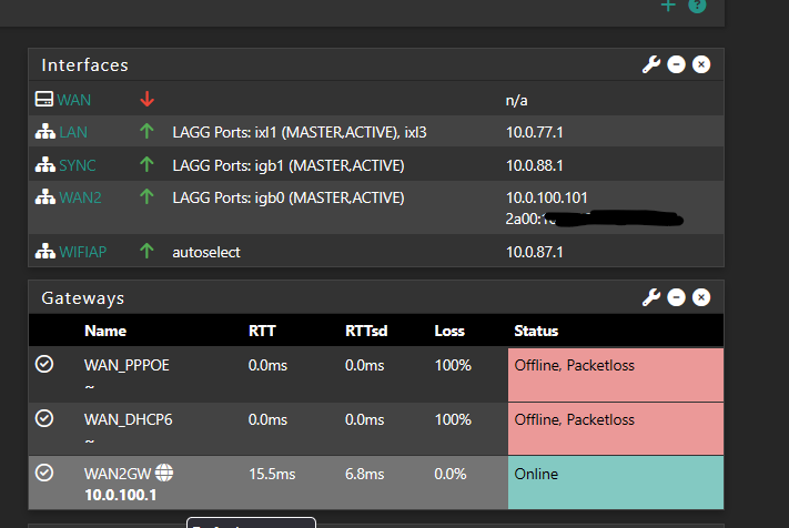

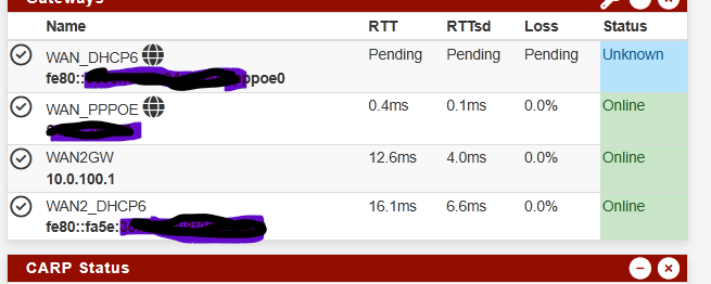

      This is what it looks like when I get only Ipv4 and everything is working except ipv6
      Sorry, all IP addresses are present on the interface—there’s just no default gateway. I believe dpinger still works because an automatic route to the ISP-gateway IP is still in the routing table. The RTT is so low because dpinger is using the ISP-gateway IP address, so that’s fine. The connection is a fiber line that runs directly from my house to the ISP gateway.
      I suspect that the missing uptime entry and default route are caused by a race condition, and it doesn’t occur very often. The failure to obtain IPv6, however, is more frustrating.
      So far I have tested boot environment with old 23.09 version and can just hit disconnect WAN and then connect wan without any issues.
