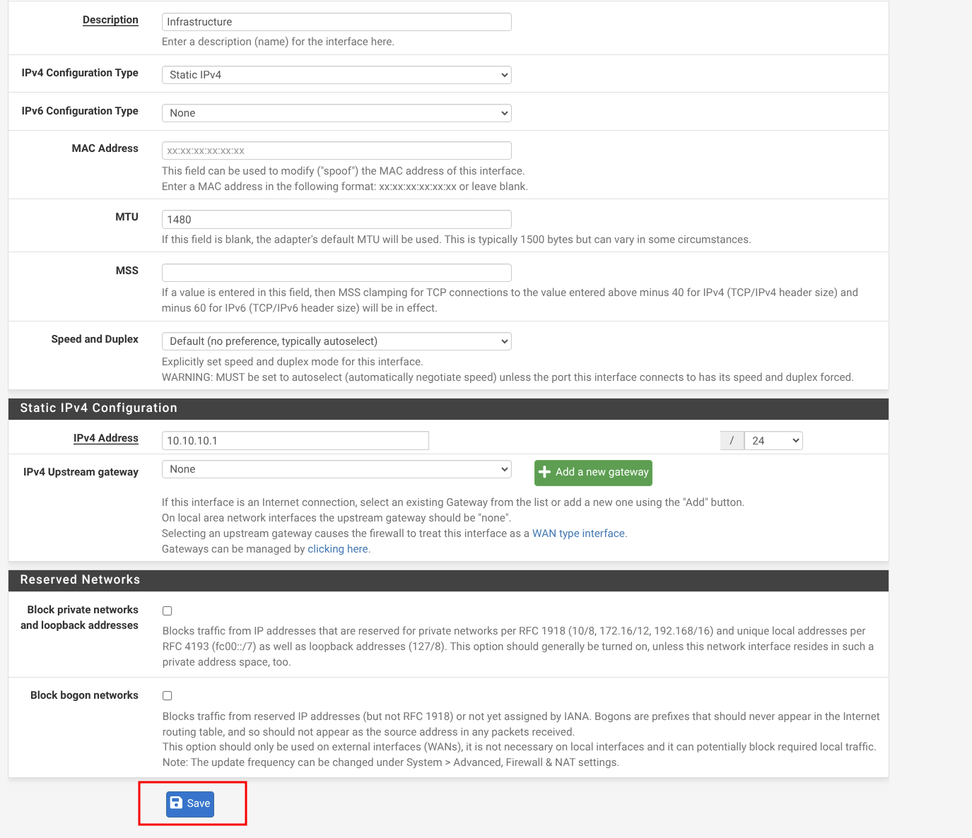

          cde @stephenw10
          How exactly are you doing that?
          i go to the interface as seen in the image below, and without making any changes i click save at the bottom of the page
          and this makes the interface "refresh". So basically without making any changes the linux systems are conencted to the internet.

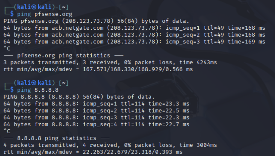

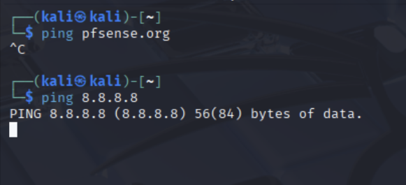

          When they are unable to connect what error is shown if, for example, you try to ping pfsense.org?
          no error when pinging pfsense.org, it is not even starting in fact (i havent tried that in the past) which means that it cannot find a dns server i guess, while for pinging 8.8.8.8 the ping utility starts but nothing happens.
          the next image is after the refresh and no other changes on the vm:

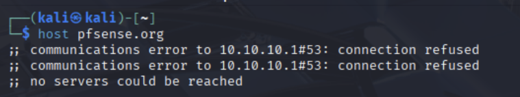

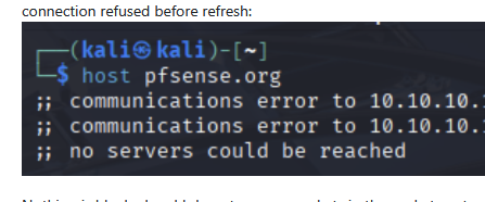

              cde @stephenw10
              connection refused before refresh:
              Nothing is blocked and I do not see any packets in the packet capture.
              The IP and correct mac address are on the ARP table.
                Gertjan @cde
                @cde

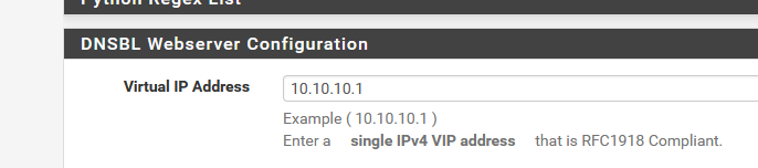

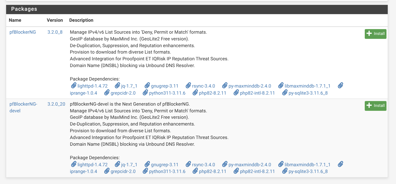

                Please confirm that you have not installed pfBlockerng(-devel) and that you are not plan to install it.
                Be ware that pfBlockerng will use the same IP for its own need (can be changed) :

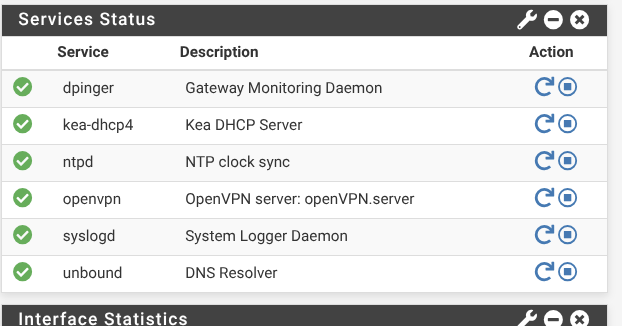

                Unbound (or dnsmasq) is listening ?
                sockstat | grep 'unbound'

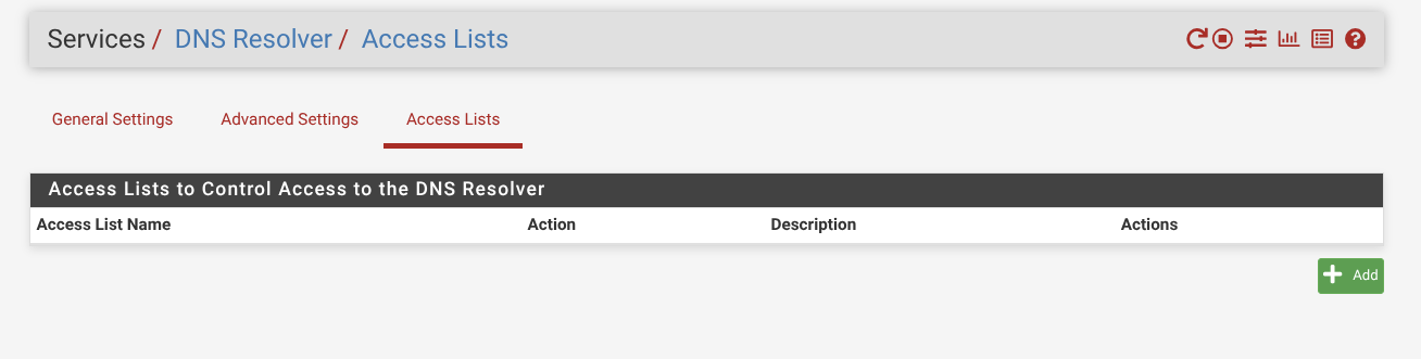

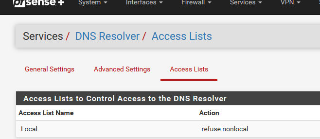

                Btw : "Connection refused" tells me that unbound did get the DNS request, but unbound was informed to 'refuse' it.
                Nothing special unbound ACLs ?
                Normally, default, ACL isn't used ...
                  cde @Gertjan
                  @Gertjan i am using unbound and i do not have pfBlockerng
                  nothing on ACL

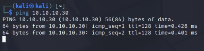

                      @stephenw10 there is an entry for the system but no internet access. still i am able to ping the pfsense and other systems on the subnet
                        cde @cde

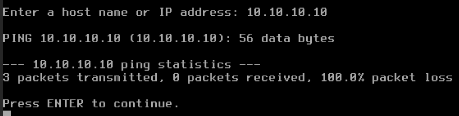

                        @stephenw10 on the otherside, the firewall cannot ping the same system

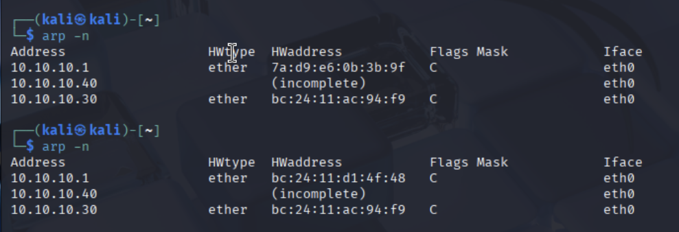

                          No check the ARP table in Kali for the 10.10.10.1 address. It seems at least possible something else is using it and sending the wrong MAC.
                            cde @stephenw10
                            @stephenw10 top is before and bottom is after the refresh.
                              Aha, well there you go. Only one of those MACs is correct. Where is that other MAC coming from?
                                cde @stephenw10
                                @stephenw10 thank you so much! i found the culprit!
                                on my proxmox i had setup the switch interface to be on the 10.10.10.1/24 and so I had two interfaces with the same IP... you are a god thank you!
