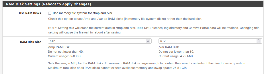

      I have decided to try the RAM DISK feature to squeeze a little bit of more performance out of my pfsense plus box. However, it did not go well.
      I have about 32GB of RAM installed which should be more than enough.
      I set 512/512 and enabled RAM disks. Initially everything was fine but after a day and checking my system, I noticed that the DNS was not working properly.
      Further investigation led me to this crash warning on the UI.
      Reloading the filter manually was also not working
      I disabled the RAM DISK, tried to reboot but it was getting stuck on the reboot sequence and failing. I had to power reset it to get back.

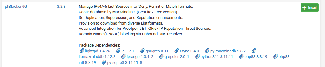

              @stephenw10 hmm I do have pfblocker with a number of lists but not to the point that it will fill the var space with 512MBs.
              current usage is not very high

                Even when it runs an update? That's when it uses the most space as it expands the new lists.

                    Yup, there should be. I would expect 512MB to be large enough even for pfBlocker unless you really have a lot of large lists.

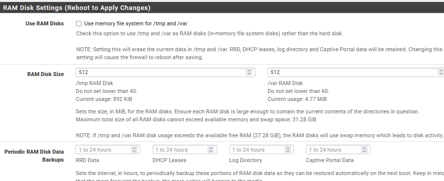

                                        @Laxarus Also I wouldn’t use a RAM disk for performance, but for limiting disk writes. Maybe on eMMC storage but then the disk writing is more important anyway.
                                        Upvote 👍 helpful posts!
                                          Any reason you chose such small RAM disks with so much memory? I've run 2048 tmp and 4096 var on my 16GB sys. I know at least pfB needs plenty of space to update, enough for the old and new data simultaneously.

                                            @provels I thought 512 should be plenty enough but who knew???
