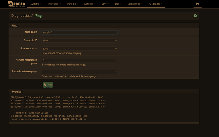

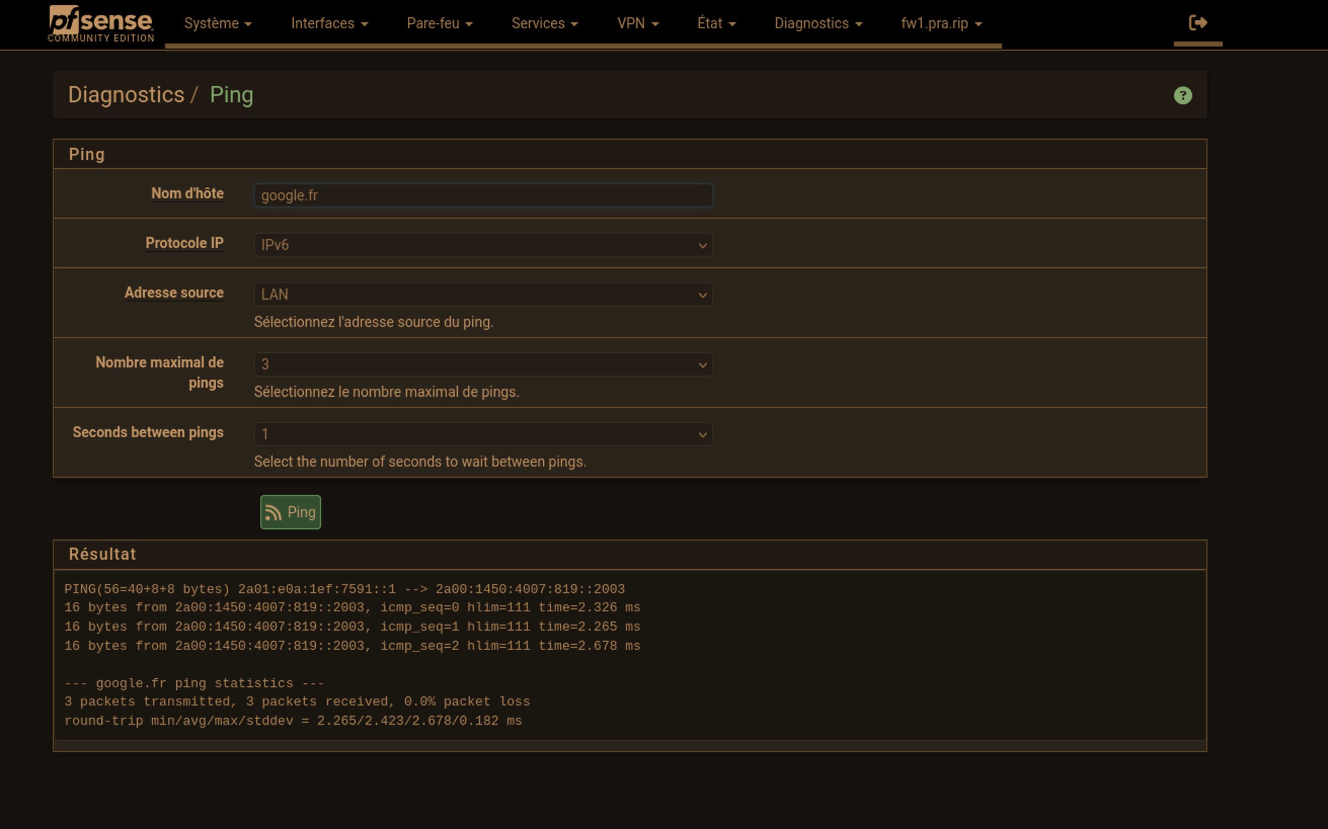

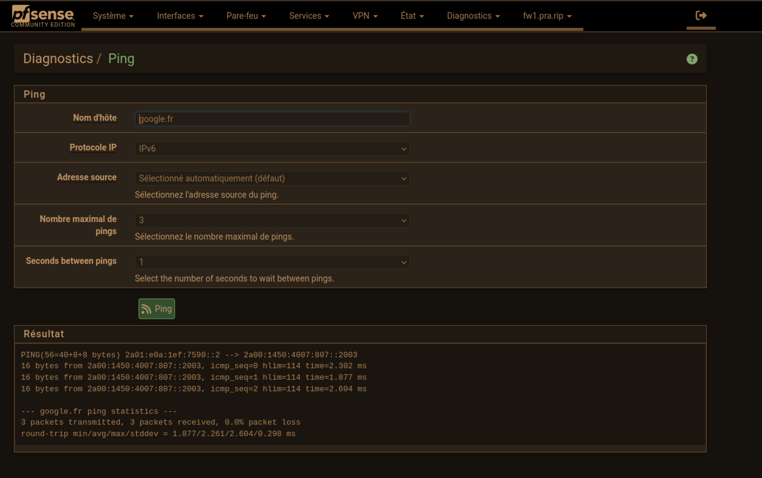

            ping test from pfsense from WAN to google.fr working fine :
            ping test from pfsense from LAN to google.fr not working

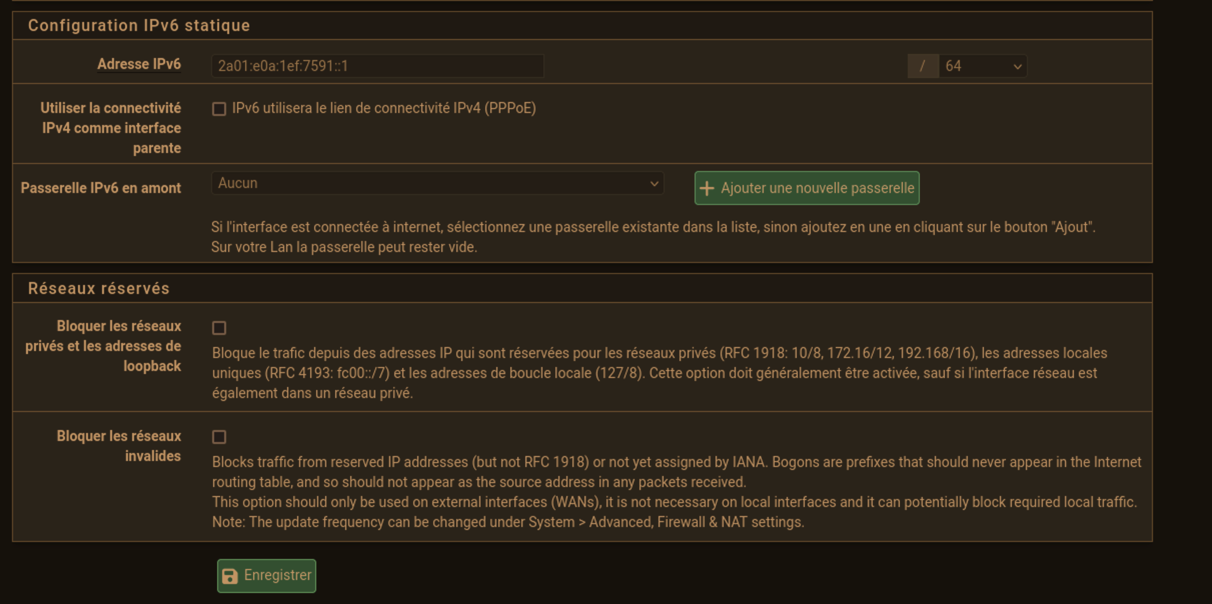

            LAN interface config :
            i can ping all host under the sub network 2a01:e0a:1ef:7591::/64
            from LAN i can t ping 2a01:e0a:1ef:7590::1

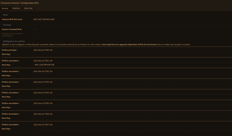

                the subnet is linked by FAI perthe local IPv6 fe80::a236:9fff:fef8:f308 : ix0
                in 2.7.2 and older was working without gateway
                need i add gateway?
                if yes which?
                Thank you for your help

                  after using the local IPv6 of box as router it s working :
                  but still same my hosts in the lan can t outgoing to internet

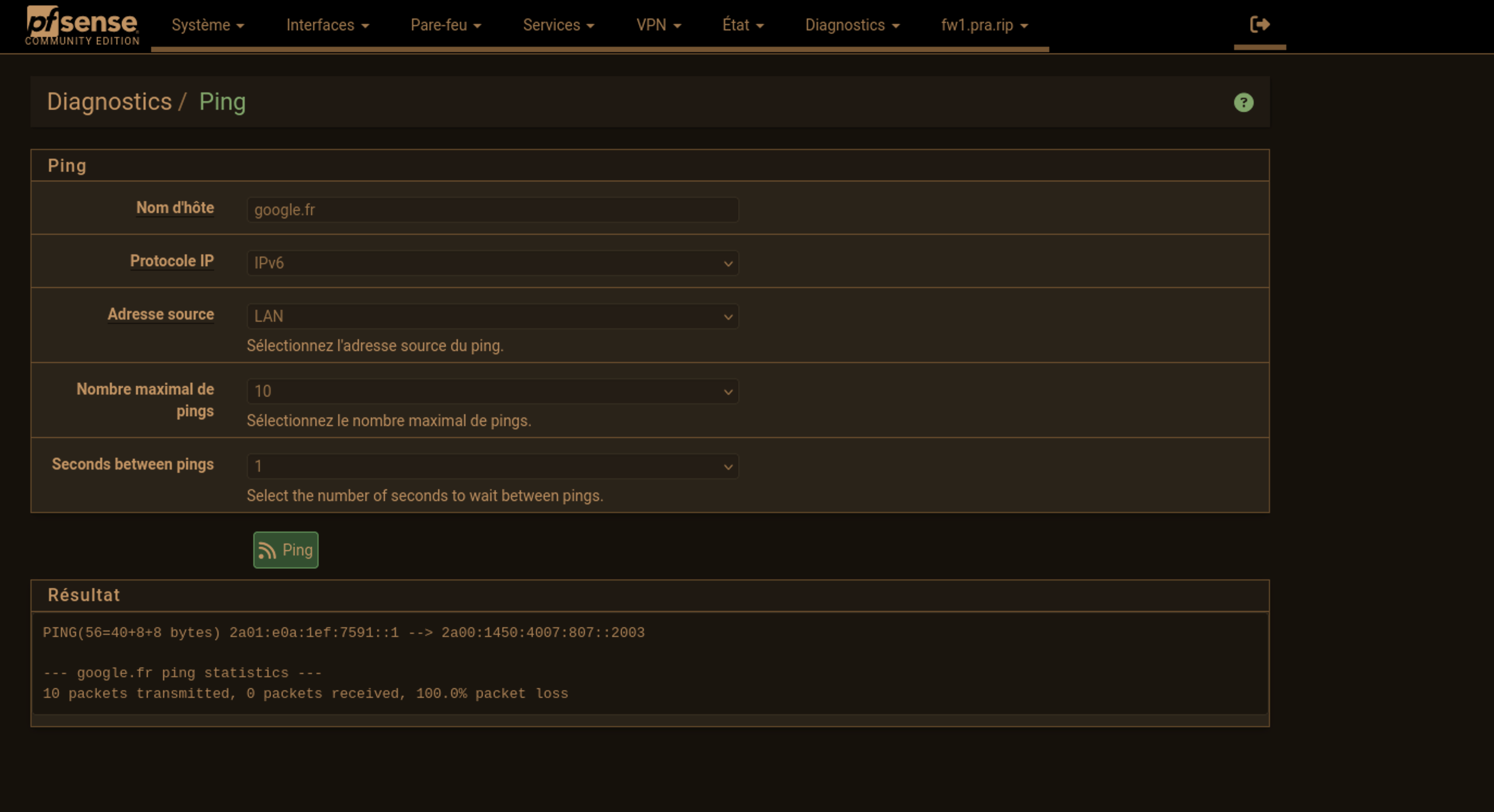

                  trying to ping google ;
                  =>ping google.fr
                  PING google.fr(par10s39-in-x03.1e100.net (2a00:1450:4007:807::2003)) 56 data bytes
                  ^C
                  --- google.fr ping statistics ---
                  10 packets transmitted, 0 received, 100% packet loss, time 9192ms
                  < [06:36:50] - root@webblog:~ >

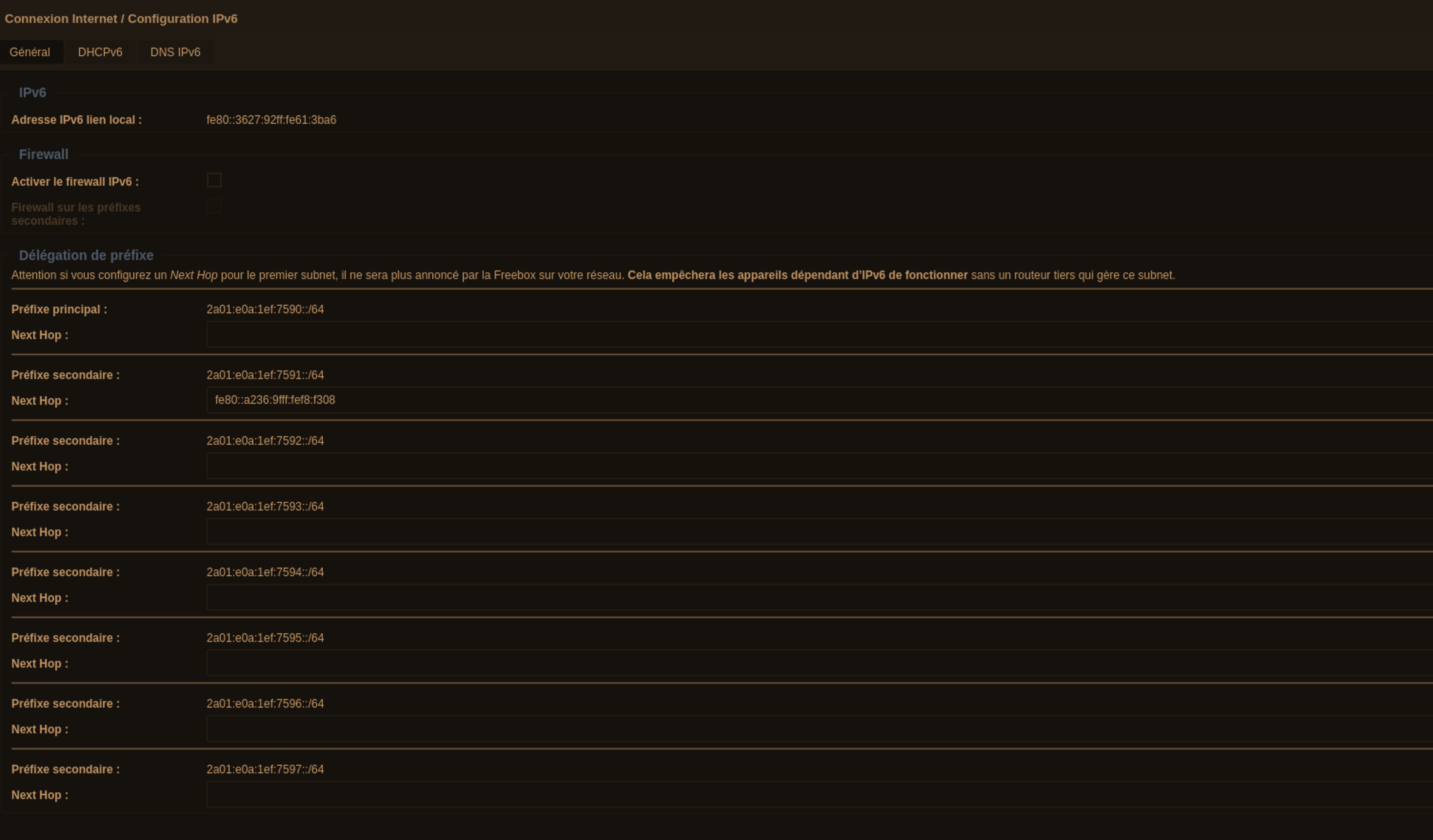

                    stephenw10 Netgate Administrator @pra45300
                    @pra45300 said in No IPv6 connectivity after upgrade:
                    Yes the upstream nexthop setting for the LAN subnet should be the WAN LinkLocal address (fe80::a236:9fff:fef8:f309) not LAN. That's what you changed?

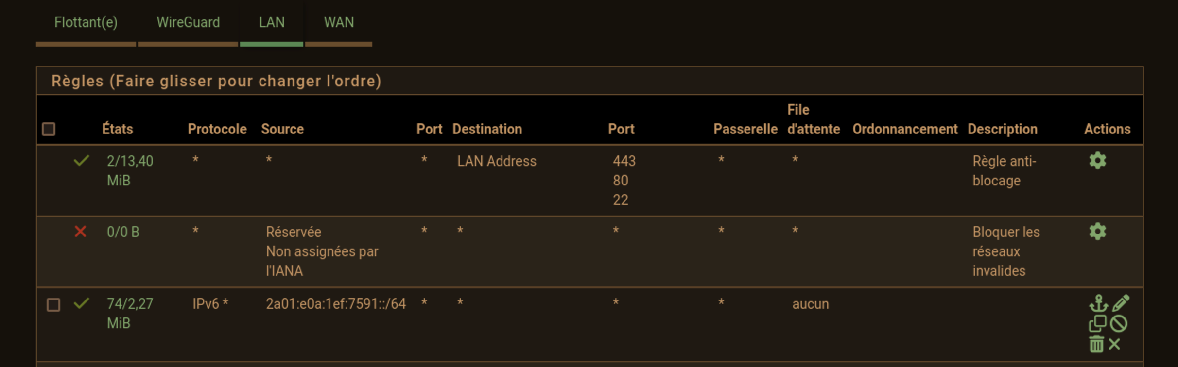

                    What firewall rules do you have on LAN?

                      @stephenw10 said in No IPv6 connectivity after upgrade:
                      fe80::a236:9fff:fef8:f309 it s my local ip on ix1 (inet6 fe80::a236:9fff:fef8:f309%ix1 ) on the box
                      i added fe80::3627:92ff:fe61:3ba6 given by FAI as router :
                      too much permissive : )
