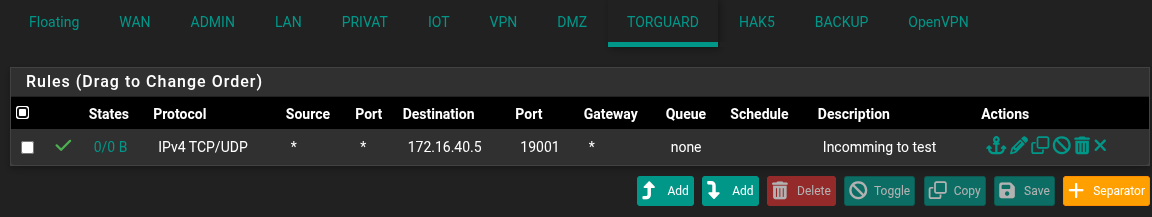

              I've tried doing this a NAT:
              Resolving in no port open and no trafik towards my host, as a simple nginx page.
              This is what I would Normally do NAT a port to a service.
              I'm testing with https://ismyportopen.com/ - or directly onb the IP:PORT

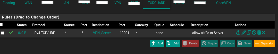

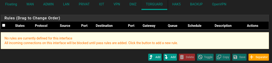

              With my VPN-CLient created as a Interface - without any rules for that Interface:
              Since my VPN-client are created as an Interface - I would like to think there should be the rules under this interface for incomming rules.
              Where I should believe (as the torguard as a Interface) should look like this instead:
              498a8fdc-11a4-41ff-990f-983764915838-image.png.
              But I'm not getting through in any of the 2 ways to my nginx. No issue with internal IP and port - which showing nginx testpage
