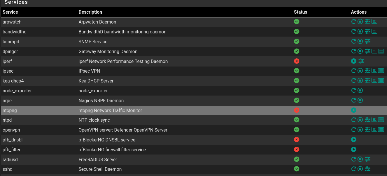

      However, the OpenVPN service is actually running. I’m also monitoring the PfSense services through OMD Thruk using the check_nrpe plugin, and it is returning the same (incorrect) result.

        Did you pass the required options to it? It expects to see mode and ID:
        [2.8.0-RELEASE][admin@t70.stevew.lan]/root: pfSsh.php playback svc status openvpn
        Invalid OpenVPN mode (server, client)
        [2.8.0-RELEASE][admin@t70.stevew.lan]/root: pfSsh.php playback svc status openvpn server
        Invalid OpenVPN ID, must be numeric
        [2.8.0-RELEASE][admin@t70.stevew.lan]/root: pfSsh.php playback svc status openvpn server 1
        Service openvpn is running.
        Like it shows in the example in the script.

          @stephenw10 Yes. I tried and it showing service not running.
          [2.8.0-RELEASE][santheerdas@xxxx]/usr/local/libexec/nagios: ./check_pf_services -name openvpn server 1
          CRITICAL - openvpn service not running
          [2.8.0-RELEASE][santheerdas@xxxx]/usr/local/libexec/nagios: ./check_pf_services -name "openvpn server 1"
          CRITICAL - openvpn server 1 service not running
          [2.8.0-RELEASE][santheerdas@xxxx]/usr/local/libexec/nagios: ./check_pf_services -name "openvpn client 1"
          CRITICAL - openvpn client 1 service not running
          [2.8.0-RELEASE][santheerdas@xxxx]/usr/local/libexec/nagios: ./check_pf_services -name "nrpe"
          CRITICAL - nrpe service not running
          [2.8.0-RELEASE][santheerdas@xxxx]/usr/local/libexec/nagios: ./check_pf_services -name ipsec
          CRITICAL - ipsec service not running
            santheerdas @stephenw10
            @stephenw10 ok.when using the pfSsh.php, it is working. Ok Thanks. let me try to update the script check_pf_services.
            [2.8.0-RELEASE][santheerdas@XXX]/home/santheerdas: sudo pfSsh.php playback svc status openvpn server 1
            Password:
            [2.8.0-RELEASE][santheerdas@XXX]/home/santheerdas: sudo pfSsh.php playback svc status nrpe
            Service nrpe is running.
