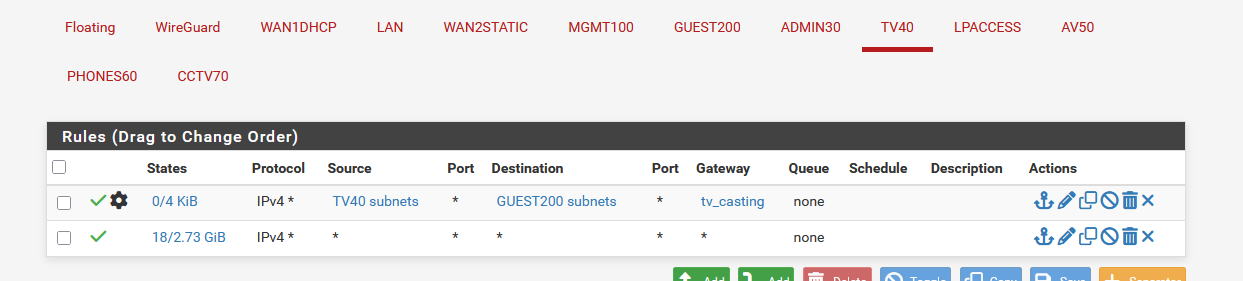

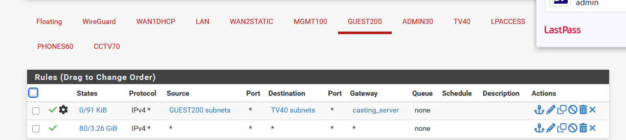

        By having the casting server act as a separate router between the two subnets you are creating an asymmetric route at both ends. I would expect TCP traffic to fail and see blocks in the firewall log?
        Unless you have added workaround rules to allow it.
        https://docs.netgate.com/pfsense/en/latest/troubleshooting/asymmetric-routing.html
        That would happen with any type of routing.
