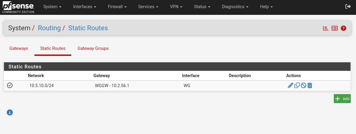

      I've got a setup where I have Wireguard VPN between two sites. I have set up static routing tables so that traffic between private IPv4 ranges on both sites can talk to each-other over the VPN.
      Site1: 10.5.10.0/24
      WG tunnel 10.2.56.1 <-> 10.2.56.85
      Site2: 10.6.66.0/24
      When sending a package from a client (10.6.6.66) on site2, to a client (10.5.10.105) on site1 I can see in tcpdump that the package is NATed:
      13:52:42.700102 eth0 In  IP 10.2.56.85 > 10.5.10.105: ICMP echo request, id 32, seq 1, length 64
      13:52:42.700152 eth0 Out IP 10.5.10.105 > 10.2.56.85: ICMP echo reply, id 32, seq 1, length 64
      I also can confirm in the firewall at Site2 that NAT is happening there;
      13:54:29.126837 IP 10.2.56.85 > 10.5.10.105: ICMP echo request, id 33, seq 1, length 64
      13:54:29.161781 IP 10.5.10.105 > 10.2.56.85: ICMP echo reply, id 33, seq 1, length 64
      How can I get pfsense to route traffic I want between these sites instead of NATing it?

                Thanks again for the video. It solved my problem.
                If anyone bumps into this thread in the future, the static route showed in a screenshot above here was correct, however here's what I did wrong:
                On site2 I had set "IPv4 Upstream gateway" in the interface config to the gateway on site1. This makes pfsense NAT the traffic instead of routing it. Here's a timestamped link to the video where this is explained.
