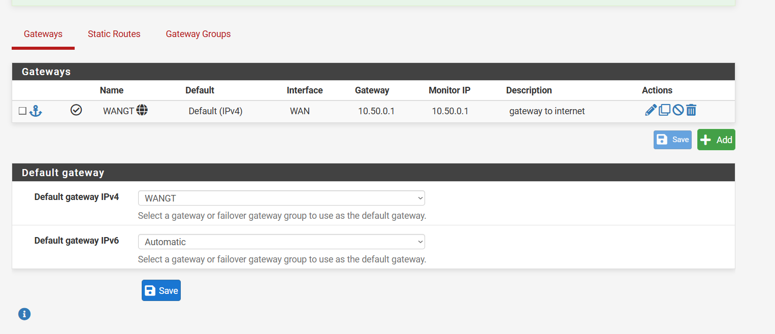

                  I managed to setup openvpn in pfsense I can access the pfsense ui but when I try ssh to machine that are in LAN I cant
                  in proxmox I have this
                  Chain POSTROUTING (policy ACCEPT 2658 packets, 161K bytes)
                   pkts bytes target     prot opt in     out     source               destination
                   4037  556K MASQUERADE  0    --  *      vmbr0   10.60.0.0/24         0.0.0.0/0
                  11867  889K MASQUERADE  0    --  *      vmbr0   10.50.0.0/24         0.0.0.0/0
                  I have this in routing
                  • stephenw10S
                    What IP are you using to connect to pfSense over OpenVPN?
                    If you have firewall rules to allow it you should be able to use the pfSense LAN address to do so.
                    If that works then you must have the correct route in OpenVPN and probably have the correct firewall rules.
                    Most likely the host VMs in the LAN are blocking connections from outside their own subnet. In which case ypu can fix the hosts to allow it or use outbound NAT in pfSense to hide the source IP.
