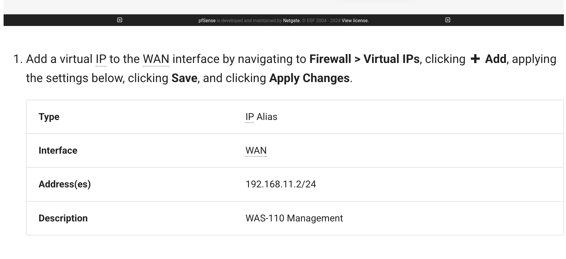

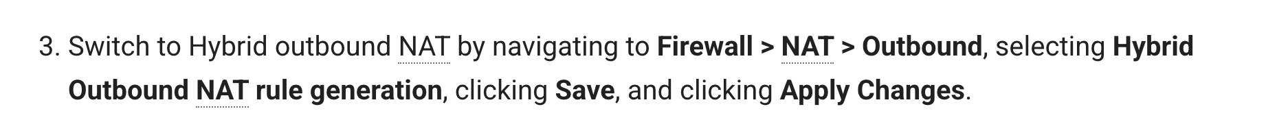

      Hi All,
      I have a running WAN ( igc3) on DHCP configured at 2.5Gbps per this igc3 port speed.
      I plan to make use of a Media converter supporting RJ45 ( 2.5Gbps) to SFP+.
      And will be attaching an ONT SFP+ stick via this Media converter to the WAN ( igc3 ).
      I need to manage this ONT SFP+ via 192.168.11.1
      and have followed the following steps but am unable to gain access at 192.168.11.1.
      I'd appreciate your assistance on this.1_Virtual IP.png 2_Firewall Alias.png 3_OutBound Hybrid.png 4_Add OutBound NAT Rule.png

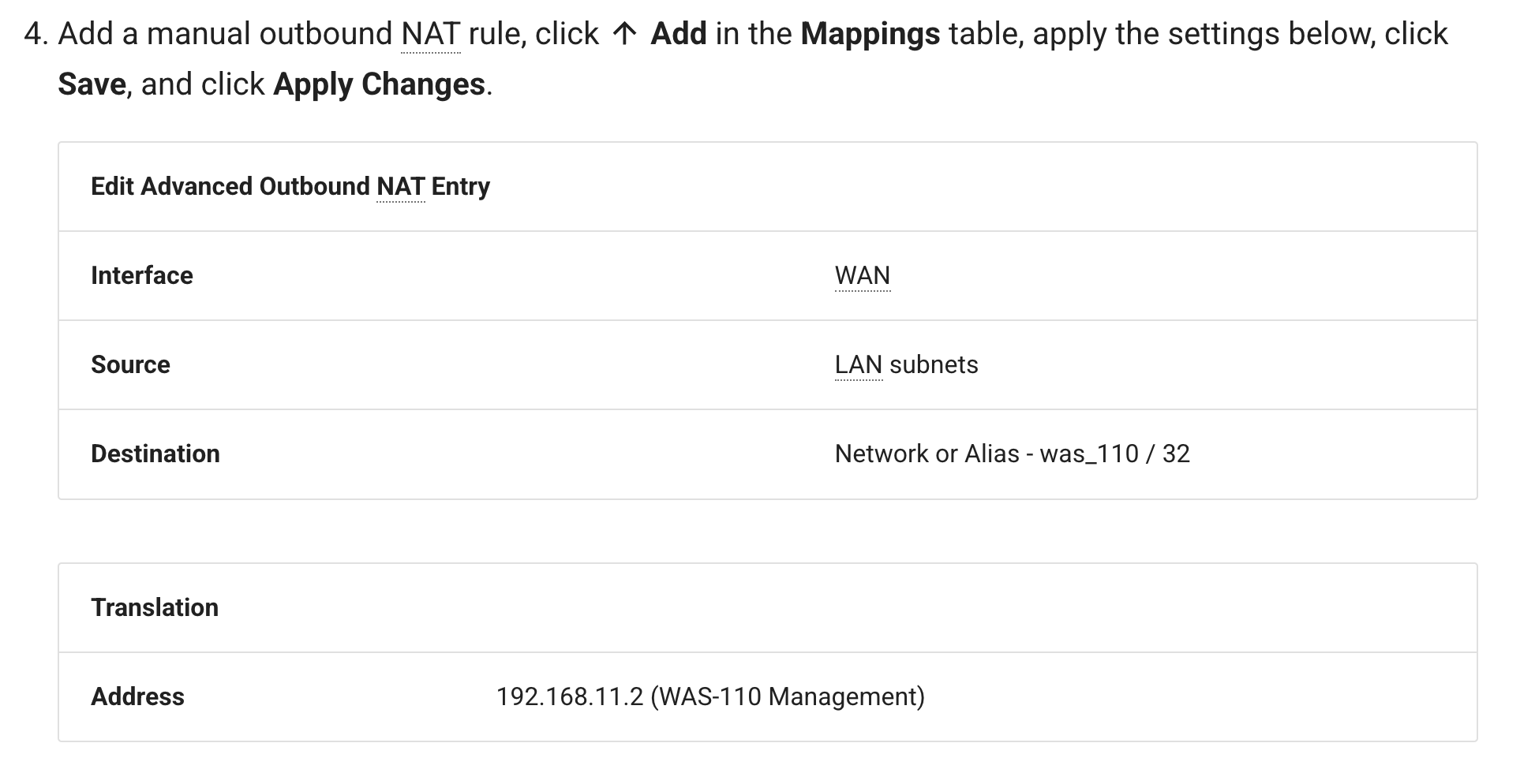

          Did you follow the instructions on the 8311 wiki site on how to set up SOURCE NAT on pfSense as shown in this link?
          https://pon.wiki/guides/install-the-8311-community-firmware-on-the-was-110/#network-setup

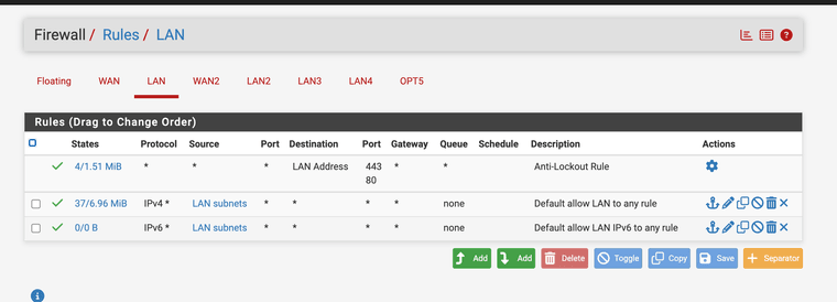

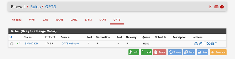

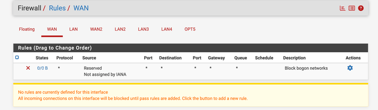

            @keyser Hello, WAN Rules.png OPT5 Rules.png I am able to Ping on the PFsense Ping diagnostic on 192.168.11.2 but not 192.168.11.1.
            At this moment, I am unable to web gui into 192.168.11.1 via the Web Browser. Pfsense was re-booted too. Thanks for your continued assistance

              @keyser LAN Rules.png Please see the LAN rules in place too. Thank you.

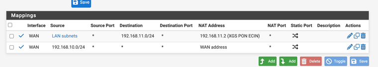

                    @MarinSNB Hello, this was the instructions on 8311 wiki site to set up the SOURCE NAT on pdSense for DHCP but I am unable to Web Gui into 192.168.11.1. So, I'm reaching out to the pfSense community at large to see if there might be other configuration that I might need to tweak. Thanks for highlighting this.

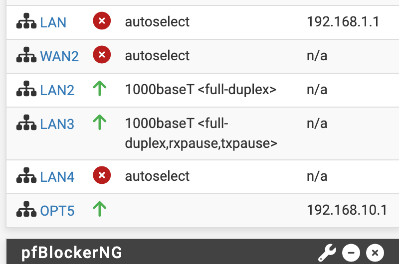

                      @BennySoh I think your problem is more basic if you cannot ping 192.168.11.1 from your pfSense box when using the Souce IP address of 192.168.11.2 (VIP address on WAN).
                      If you cannot ping the SFP modules administrative IP, then you cannot expect to be able to reach its web interface.
                      There is a small chance that the module has a Firewall that blocks Ping (very unlikely), but then at least you should see it’s MAC address in the STATUS -> Mac address Table in pfSense after attempting to ping it. I suspect you don’t, and therefore the problem is more of a basic nature…
                      Does the port show link in pfSense? If it’s WAN2 in your screenshot it doesn’t sense link on the SFP module, so it might be your pfSense box have not recognized the SFP module at all.

                        Here is the solution that works for me.
                        https://forum.netgate.com/topic/197766/how-to-connect-to-xgs-pon-controller/15?_=1751026822174

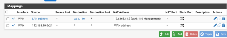

                          @AndyRH Thank you for this. I will reconfigure to this new Outbound NAT Rules and will get back once I get to swap in the ONT SFP+ Module.Revised Outbound Rules AndyRH.png

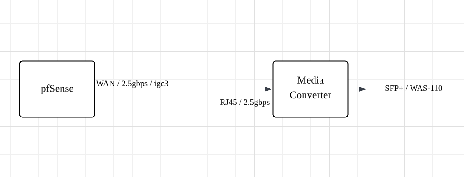

                              @AndyRH Hi, I am still unable to access WAS-110 via 192.168.11.1.Screenshot 2025-06-30 at 2.19.09 PM.png
                              Please see my current WAS-110 connectivity to the pfSense WAN / 2.5gbps / igc3 port.
                              Would you mind sharing your WAS-110 connectivity to the pfSense for your successful NAT Outbound access ?
                              • B Offline
                                BennySoh @BennySoh
                                @AndyRH Hi, my apologies, I should have read through your trail of the post you made in arriving at your solution. From it, I gather that the WAS-110 is inserted directly into the ix1 of the 7100 box. So, in my case I am making use of a media converter and am hence not sure if this could be the cause on my inability to Web Gui into 192.168.11.1.
                                I'd appreciate if the community may chime in on this. Thank you.
                                AndyRHA 1 Reply Last reply Reply Quote 0
                                • AndyRHA Offline
                                  AndyRH @BennySoh
                                  @BennySoh The media converter should be a "dumb" switch. I would not expect it to block your access.

                                            @AndyRH Hi, I managed to access the 192.168.11.1 Web Gui with the changes you've shared https://forum.netgate.com/topic/197766/how-to-connect-to-xgs-pon-controller/15?_=1751026822174
                                            This access ( NAT OutBound ) to 192.168.11.1 Web Gui succeeded after i did a Power On Reset to the Netgate 4100 after making the NAT Outbound changes. It hence seems that NAT changes did not take effect after I "Save" and "Apply Changes" and only became effective after I did a Power On Reset. Also another point to note was this Web Access to 192.168.11.1. was successful when my WAN is on DHCP and without a Vlan assignment. I may have to open another thread for assistance as I need to access 192.168.11.1 with WAN on DHCP and with a VLAN for the WAN. Thanks to you, at least I have a window into the WAS-110 albeit when the WAN is not configured with a VLAN. On your temperature for the WAS-110 its 50/48/46 Celsius with ambient temperature at 30 degrees Celsius and with a cooling fan in place. Have a a good one.
