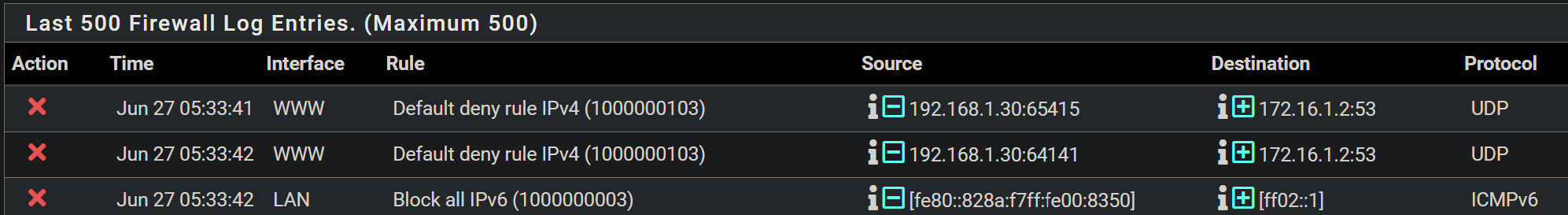

      I have read many articles, followed AI-generated steps, and used pfSense for a few years (with one subnet), but I am having issues getting access between the LAN subnet and the VLANS. I have managed to get PING to ping the 'gateway' for each VLAN from the LAN, but not the other way around. I think once I get the method down, that works, I should have it, or I am missing something important somewhere else.
      I have Windows servers on the LAN subnet (172.16.1.2, 172.16.1.3, 172.16.1.4) that feed DNS, and 172.16.1.2 that feeds DHCP.
      I want to get DNS from the LAN servers and send it to the VLANS.
      I want to be able to PING from the LAN to all the VLANS and vice versa.
      I have tried several rules on the LAN side, the VLAN side, and back, but none seem to work. I can add a rule to hit the WebGUI, and it works. So, I believe the rules are working, but I am just stuck.

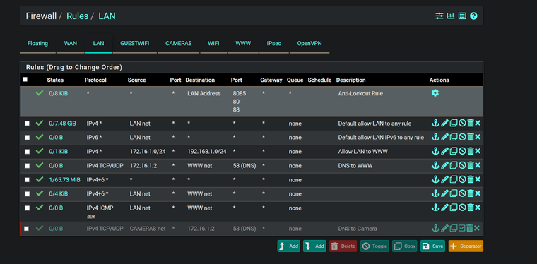

        @Overcon All rules on any interface are only inbound. That means you can only control IPs connected to that interface, what they allowed to reach and what not. If you want some device on VLANx to connect to some other device on LAN, you have to do that on VLANx, not on the LAN.
        Also top to bottom, first match wins. Your screenshots show that you didn't do it right, yet.

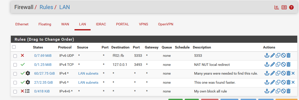

          When you initially installed pfSense, you found on the on LAN interface these two rules :

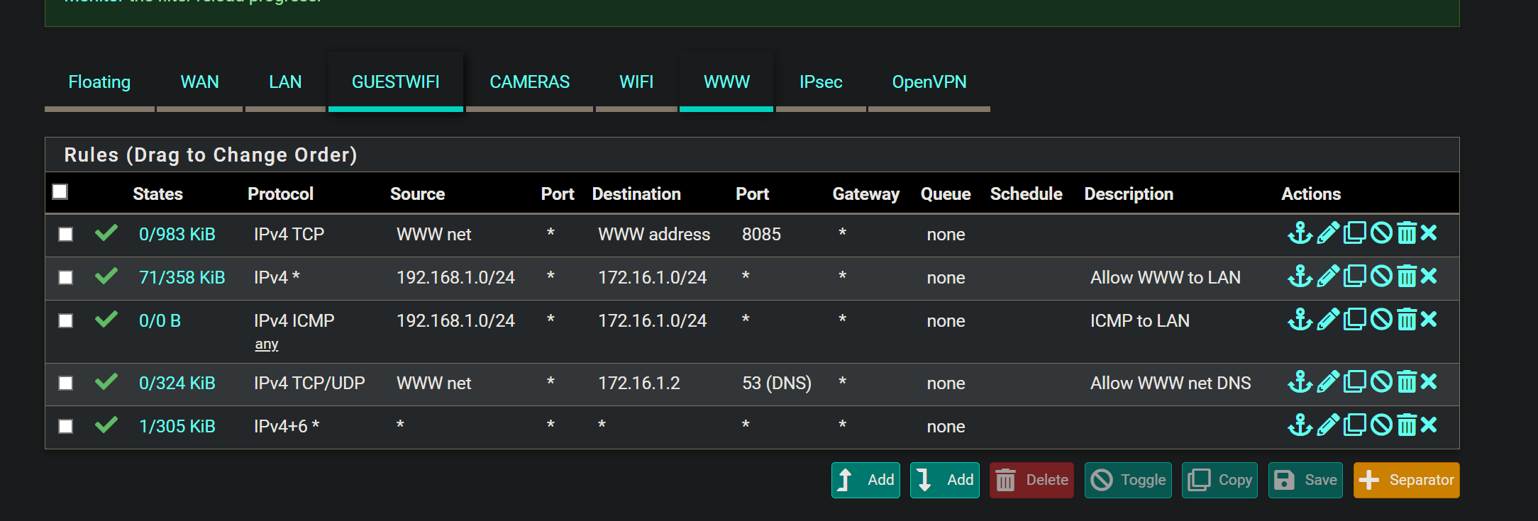

            Thanks, guys. I have tried copying the default allow rules from LAN, but I am still getting blocked by a Default Deny. I have even tried accessing via creating an EasyRule, but still no luck.

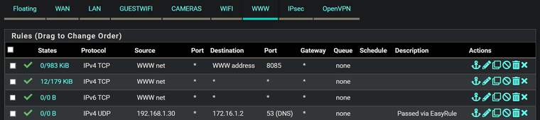

              can happen anymore as you've added :
              although your WWW firewall rule set is already problamatic.
              The first 3 rules are TCP only, that ... can be done, but is already fishy - not a real live scenario.
              Rule 2 and 3 are doubles, one is useless.
              Limitations of rule 1 are overridden by rule 2 (and 3).
