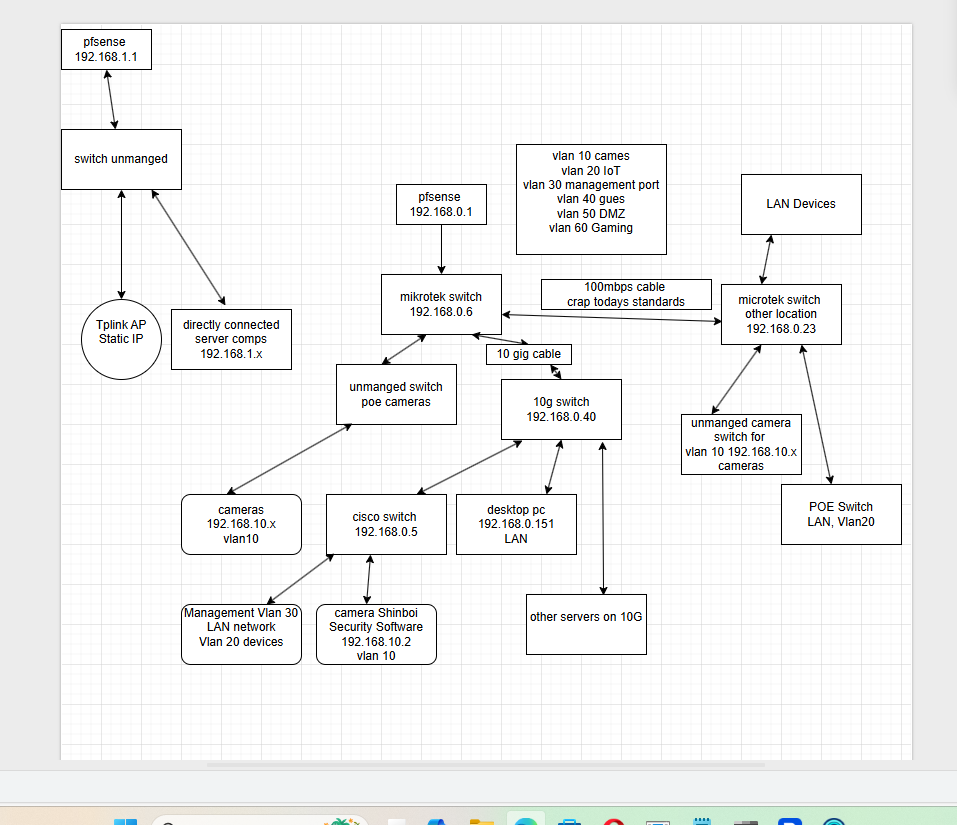

                ok so i used the program to make a drawing
                the left side is my sisters network 192.168.1.1 and it has all the same vlans as in the diagram i made for my network
                and then the other is my home network i have 2 locations one is my house and 1 is my shop on my property so i have like 3 racks but the different location my house
                so basiclly that is my setup i like this program better then windows paint as i always struggle if i wanna move stuff.. i appreciate that.

                  johnpoz LAYER 8 Global Moderator @comet424
                  @comet424 said in question about VLANS and rebooting Pfsense:
                  no it doesn't - you list a unmanaged switch.. How would you be doing vlans? Are all your devices doing tags? And your just running tags over a dumb switch.?

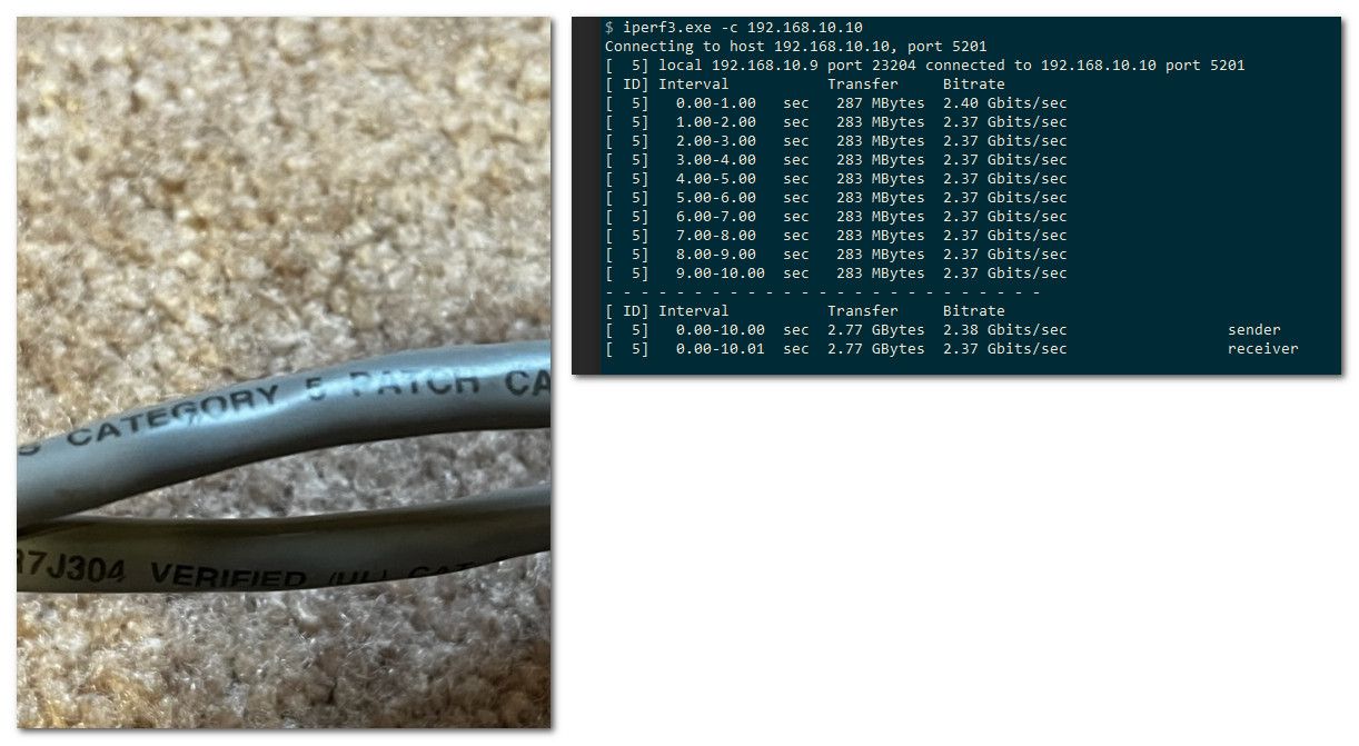

                  I find it odd that people that would run something like pfsense have no clue how basic tcp/ip works.. Why would you think that traffic on the same network goes through your router?
                  And you got me curious to your 100mbps cable.. What it only has 2 pairs? cat 5 from like 35 years ago can run gig.. Shoot it can do 2.5ge even..
                  Here is a really old 25' patch cable I had laying about - shoot the clips on the ends of the connectors even busted off, and does 2.5ge just fine.
                  I had this cable in the bottom drawer of my old desk.. Prob sat in there for 20+ years ;)

                    comet424 @comet424
                    @johnpoz
                    so i should exampled better on my sisters side i dont have cameras i only Made Vlans for future when i expand and i dont have to do it later

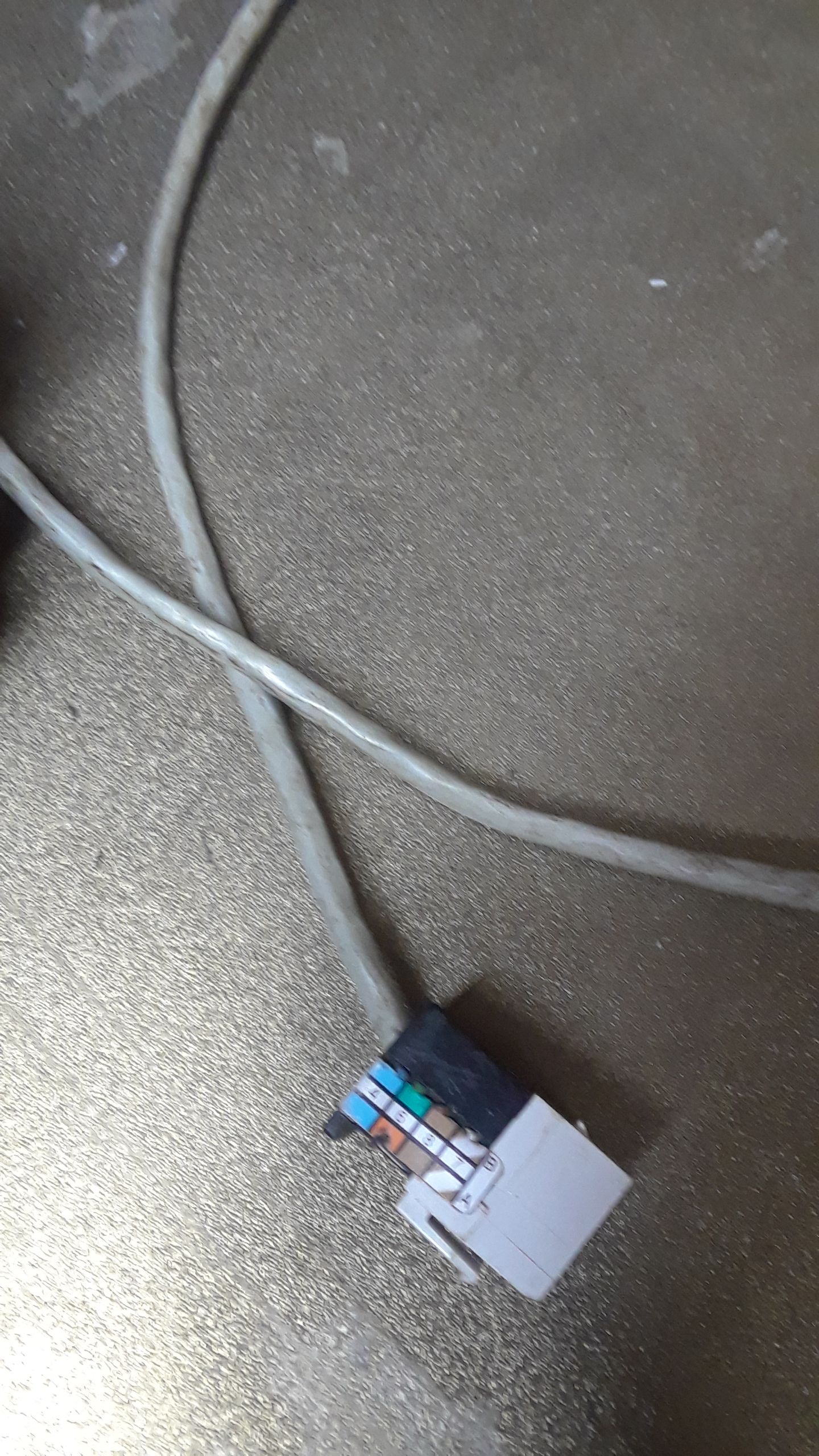

                    at the time of burring 25 26 years ago when i had 100mbp network cards it could be the cables degraded i cant seem to get faster unless i pull a new 2 cables but plan to burry a fiber cable instead since i cant get it in the 1/2" or 3/4" piping burried years ago might just pull a a new cable 300 feet of cat 6 just kept putting things off but was thinking going fiber and not worry about cable lenght
                    so on the managed switch i tell it Vlan10 for example Port 1 and the unmanaged switch is pluged into port 1 and everything on the unmanaged switch gets 192.168.10.x for Vlan 10 this way all the ports under unmanaged switch get Vlan10
                    oh and here is my network cable that i burried 25 26 years ago
                    piece of the cable back then they didnt even stamp the cable.. you just buy a 1000 foot box from home depot and take what you got lol i think its degrading from the sun etc as i used to get full duplex now i run like half duplex to work. so reason i was thinking going fiber since both switchs in my house and shop are the same miroktek and have a 10gig sftp slot this way no issues running 300+ feet and i burry it with 1 1/4" tubing i have kicking around so plently or room i remember running the 2 network cables in that 1/2" or 3/4" was tight

                      @comet424 so you have to run 100 half to get a connection? Yeah that cable is degraded for sure. Even if wires were broken that allowed for get you should still be able to get full duplex 100 with just 2 pairs..
                      if you are redoing the run and its 20+ years old and especially since degraded and can no longer do gig.. Did you try re-terminating the ends? Then yeah for sure would run new wire.. Would be good practice if connecting buildings to use fiber vs copper.
                      Oh so the vlans are created on your sisters, just not in use.. Ok - again that has zero to do with anything.. if your sister can not even set a IP on her phone and talk to something else connected to switch that has an IP on that network that screams something wrong with the AP or switch.. You should be able to unplug the connection from pfsense to that switch - and everything should still be able to talk to each other via IP. Internet wouldn't work, dns wouldn't work for local resources if pfsense (unbound/dnsmasq/bind) running on pfsense was providing the dns for your local resources.
                      but i i dunno about VLAN to LAN
                      No those wouldn't work, because those have to be routed.. How would those work if your router is offline? But lan to lan would work, vlan X to vlan X would work, vlan y to vlan y would work.. But no if your router is offline how would you route? You could route via some L3 switch on your network - but then pfsense would be useless as firewall since it wouldn't see intervlan traffic. And pfsense could not be your dhcp server because for dhcp to work on pfsense it has to be attached at L2. And if you were routing on downstream L3 switch then it would just be a transit network to pfsense.

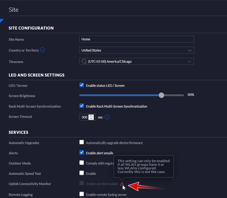

                              @stephenw10 Well when I get a chance I will pull the cable for for my wifi networks from pfsense.. I have native network and then some vlans where my iot stuff, is another one where my rokus/tvs are on, etc..
                              There is no way AP should shut down their wifi because they can not talk to the management gateway. And I will shut down my controller vm.. But that goes down all the time and all my wifi still works.
                              But I would bet a large sum of money it has no effect. Wife is leaving in like 15 minutes - I will do it then and report back.

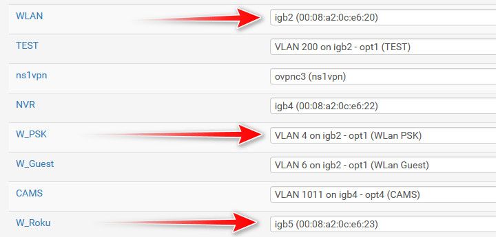

                              My main trusted wifi network (management as well for the AP and controller are on my native 192.168.2.0/24 network.. Then I have a guest wifi, trusted and eap wifi (this should fail) because it uses radius for eap-tls auth. And it won't be able to talk to pfsense where freeradius runs to do the auth. But my trust, roku and iot networks which I have both wired and wireless devices on 192.168.2.0/24, 192.168.4.0/24, 192.168.7.0/24 should all continue to function.
                              oh my roku network is on its own uplink - will pull that cable to.

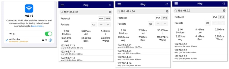

                                  @stephenw10 ok back - I shutdown my interfaces on pfsense..
                                  I had to set manual IPs on the network I wasn't already on.. So the 192.168.2 I was already on when I shut down the controller and interfaces on pfsense.. Pings just fine - that IP is one of my APs
                                  The 7 address my my roku ultra, and the 4 is one of my smart lightbulbs.
                                  Other than phone not wanting to connect to the different networks when dhcp wasn't there - I was able to get it to connect if changed the profile to manual IP..
                                  You can see my phone says there is no internet on my roku network - 192.168.7 netweork.. And still pinging devices on that network just fine.
                                  Oh I don't run that monitor - your limited to number of ssids you can run when that is on.. So its off.. I had to switch back to legacy interface to find it - I don't even see it listed in new ui.

                                      @stephenw10 take a look at my edit - took a while to find it, had to switch back to legacy ui to find it.. But you can see if you run more than 4 ssids you can't run it. I had turned it off long time ago.. Since I run 5 ssids.
                                        Nice. Yeah I'm pretty sure it was on by default back when I was using it. I spent a while trying to diagnose power failure in the AP because it didn't occur to me that it would stop being an AP for any other reason.
                                        Anyway be aware that such a thing exists and maybe Omada copied it.

                                          as for my cable.. ya ive re terminated both ends still get 100mbp at half speed but since i been around a while i remember and still have my BNC coaxal network cable and cards for 10mbp when i used to host BBS Lan partys 80s 90s and 1200 baud and 33k modem even the modem for the Texas Instrument I99 i still have kicking around take ur phone and jam it on the suction cups.. 40+ years of networking of just standard LAN i only started using Vlans last couple years as my LAN was getting too cluttered...
                                          so ya about the VLANs i was curious ya so VLAN 10 even though its embedded on 2 networks a few switchs apart will still be able to access even with pfsense down.. as i figured might go down too as i was going to move then the shinobi recording computer to the same switch as the cameras but then wouldnt solve for the 2nd switch of cameras at 2nd location..
                                          i still playing around with pfsense high availability and had those questions about it above.. but i going to play around with it more.. pfsense pretty stable as long as hardware is good had it running on my sisters computer a dell from 15-20 years ago but it just started glitch now so i built a newer version as i thought also maybe the glitching computer for the AP issues .. but didnt solve it.. but i do love the verstile use of any computer pfsense will install on..
