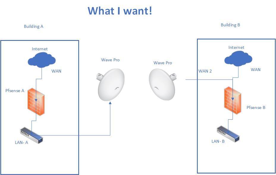

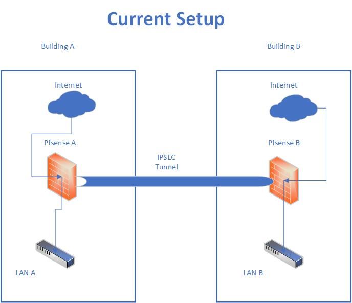

      I require assistance in connecting two buildings using Ubiquiti Wave Pro. Here is the planned setup:
      Building A serves as the headquarters and has high-speed internet, while Building B has slower internet connectivity. Both buildings are equipped with pfSense and are connected via an IPSEC tunnel. However, the connection speed at Building B is significantly hindered by its slower internet.
      Given that both buildings have their own established LANs that I do not wish to disrupt, my plan is to utilize the Wave Pro at Building B as a secondary WAN (WAN 2) for pfSense, thereby providing it with faster internet access from Building A.
      While this works in my head, I am struggling with configuring the routing to accomplish this. Any guidance on this matter would be greatly appreciated.
      Please note that I have attached two schematics: one showing the current setup and another depicting the desired outcome.
