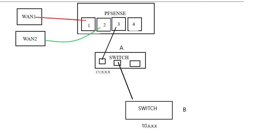

      Good day
      I am having issues routing traffic between different subnets
      Switch A = Unifi
      Switch B = Cisco
      The cisco is a layer 3 switch. It has multiple vlan with their ip address.
      I have set a default route on the switch to 10.20.160.6
      On the cisco switch i created vlan 160, 10.20.160. 6 and vlan 10.
      Vlan 10 does not have an ip but both assigned tagged to port 1 on the cisco switch
      On pfsense i created an interface for the cisco switch and the ip address i gave this interface is 10.20.160.6.
      Now the issue i am having is that traffic from switch B goes into the internet but i cant get that same traffic to reach any of the other interfaces eg (storage).
      I have spent several days trying to fix this issue. I have allowed rules to allow traffic from switch b interface(vlan 160) and interface server(vlan 10,my server interface)
      I don't understand why traffic is reaching the internet but not other gateway on pfsense?
      Do i need to create another gateway on pfsense?
      system > routing > gateway?
      system > routing > static routes??
      Thank you

            Need more information. Are you trying to route the multiple subnets on the pfsense device, the Ubiquity device or on the Cisco device?
            Seems from your picture you are just using the pfsense device as a multiple WAN "failover" style device.
            What is the purpose of the Unify device? What model is the Unify device?
            Same questions for the Cisco device.

              I am trying to route the subnets through the pfsense device. I replaced the cisco switch with another unifi switch. Both models are Unifi USW-24-G1.
              I have a successful ping from devices connected to switch-b (10.20.160.x) to the gateway on pfsense (10.20.160.6)
              @Wyatt341
              switch a interface: 172.16.20.1/24
              switch b interface:10.20.160.6/24
              I am trying to create a route from switch a to switch b
              system => routing => gateway
              interface: switch-b interface
              gateway: ?? (the ip address i gave switch-b interface 10.10.160.6 or can this be another ip address on the same subnet and must this be a physical device)
              System > Routing > Static Routes
              Destination Network: Switch A ip (172.16.20.0/24)
              Gateway: gateway defined above on the cisco switch

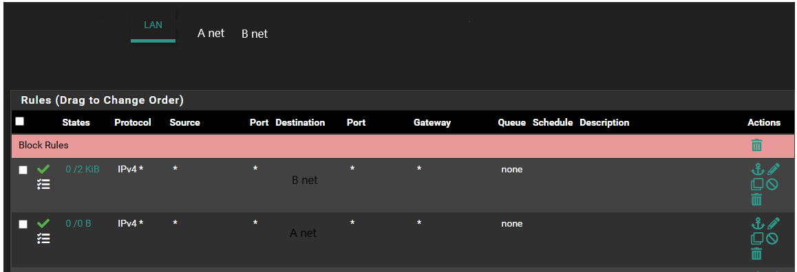

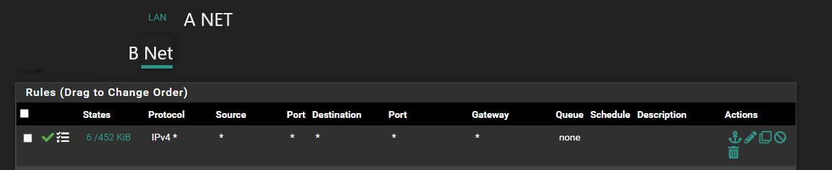

                    Lan rule
                    Lan is 172.16.0.1/24, ipv4 address = 172.16.0.1

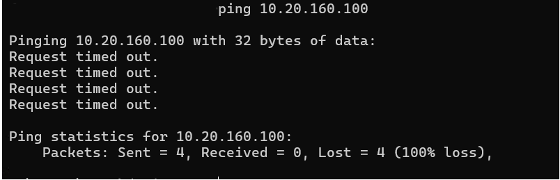

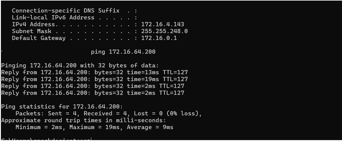

                    I can ping something from lan to a device on switch a (i changed the ip for switch a to 172.16.64.1/21)
                    but i can't ping to B net
                    i put allow all to all at the top because i want pfsense to process these rules first. I fixed this issue on friday but i wasn't writing down what i was changing so back to square one.

                      @greatbush while I have about 3 minutes here
                      do you realize that windows machines by default will not allow pings and such from outside their own subnet to come in? Just trying to rule out any issues that you might have with Windows firewall on those machines..
